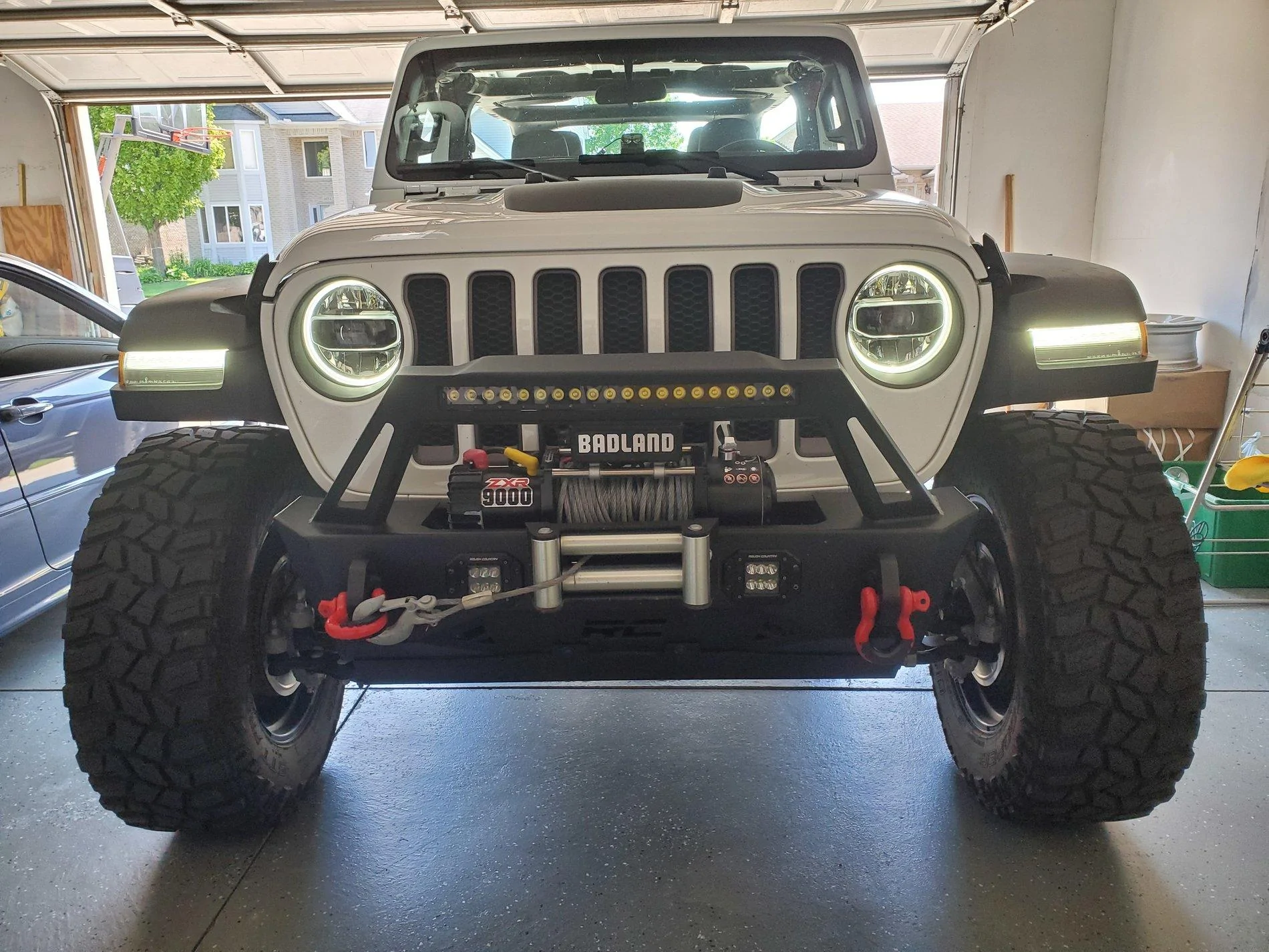

Hello everyone, here's an update!
All you need is a Tazor to program it. No resistors or anything else. The Tazor worked perfectly
