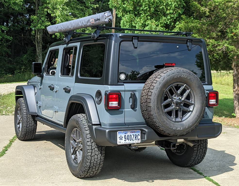

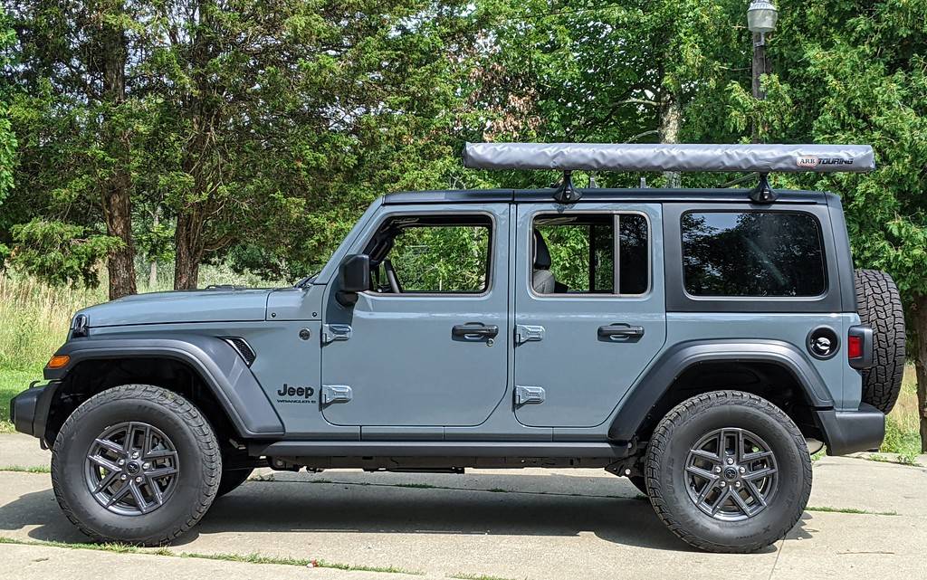

I found this thread while searching around for a awning solution that would allow mounting independent of a roof rack to the gutter.
I couldn't find anything that blew my skirt up, either.
I ended up just mounting the awning to ARB brackets:
https://www.etrailer.com/Accessories-and-Parts/ARB/ARB57FR.html
and the brackets to Inno crossbars (cut down to correct width after install):
https://www.etrailer.com/Roof_Rack/Inno/IN434.html
and 5 1/2" tall Inno gutter mount towers:
https://www.etrailer.com/Roof_Rack/Inno/IN72FR.html
Jeep Wrangler JL Gutter Mount Brackets for Awning PXL_20240706_140731951~2-XL
I initially had the mounts set up as seen above and on the top of the below image, but they overhung too far IMO. I removed the middle bolt and flipped the mounts so the awning sits a bit higher than I would personally like but it is closer in to the center of the Jeep, as seen in the below image bottom.
