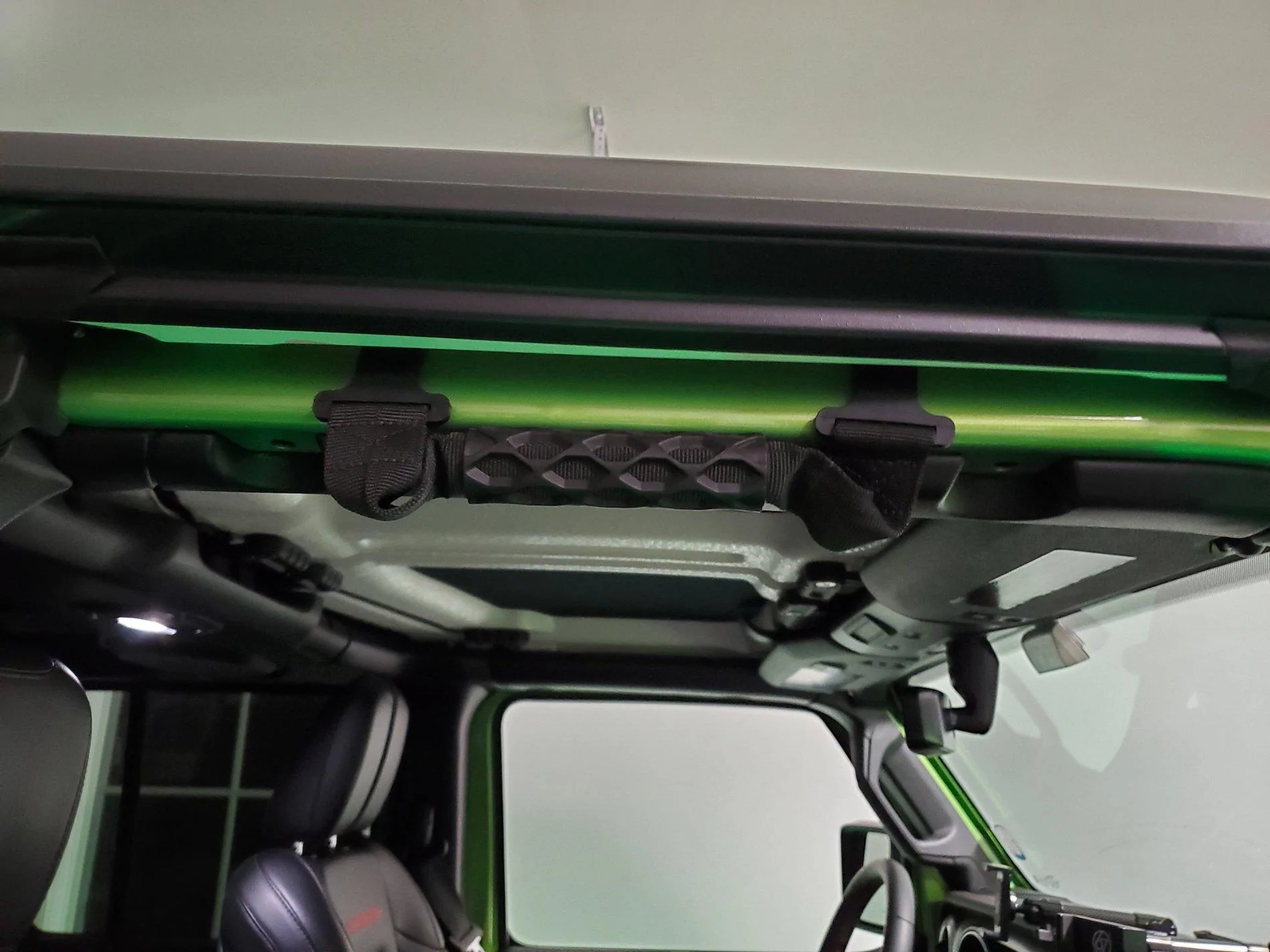

I modified the Mopar handles by carving out some of the rubber with a razor blade and attaching a couple of small magnets I bought off Amazon using 3M gasket adhesive.
Here's the handle held out of the way by the magnets:
Jeep Wrangler JL Grab handles? 20200129_225542

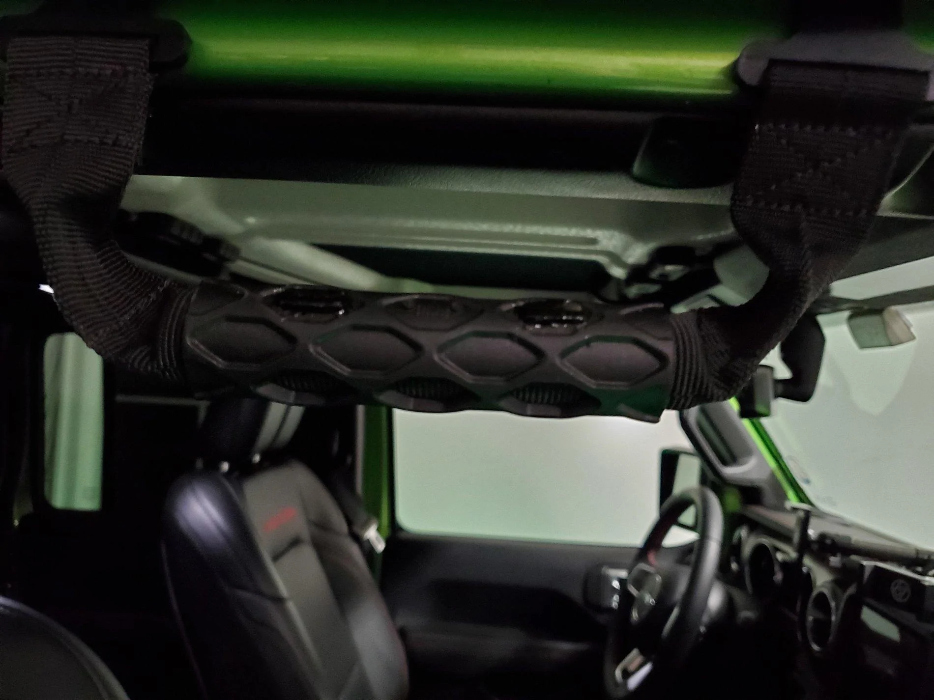

Here's the handle down and tilted so you can see the magnets:
Jeep Wrangler JL Grab handles? 20200129_225555
I coated the magnets with some black liquid electrical tape so they wouldn't mark up the painted surface. Probably could have coated the magnets with the adhesive instead.

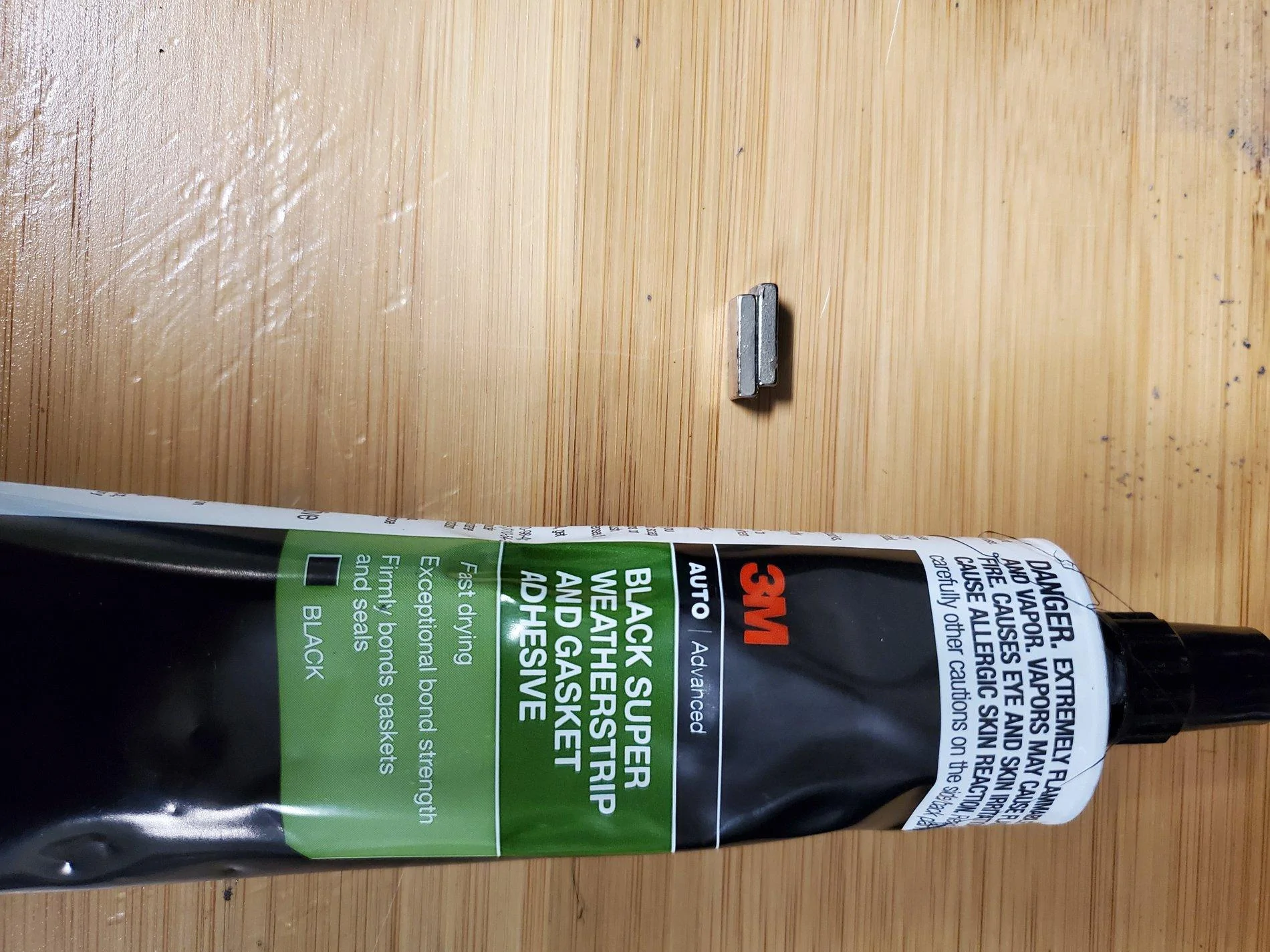

Here's a picture of two magnets and the 3M adhesive:
Jeep Wrangler JL Grab handles? 20200129_225707
I scuffed up the magnets with some sandpaper to make sure there was a good bond with the adhesive.

Nice idea. Clean look!

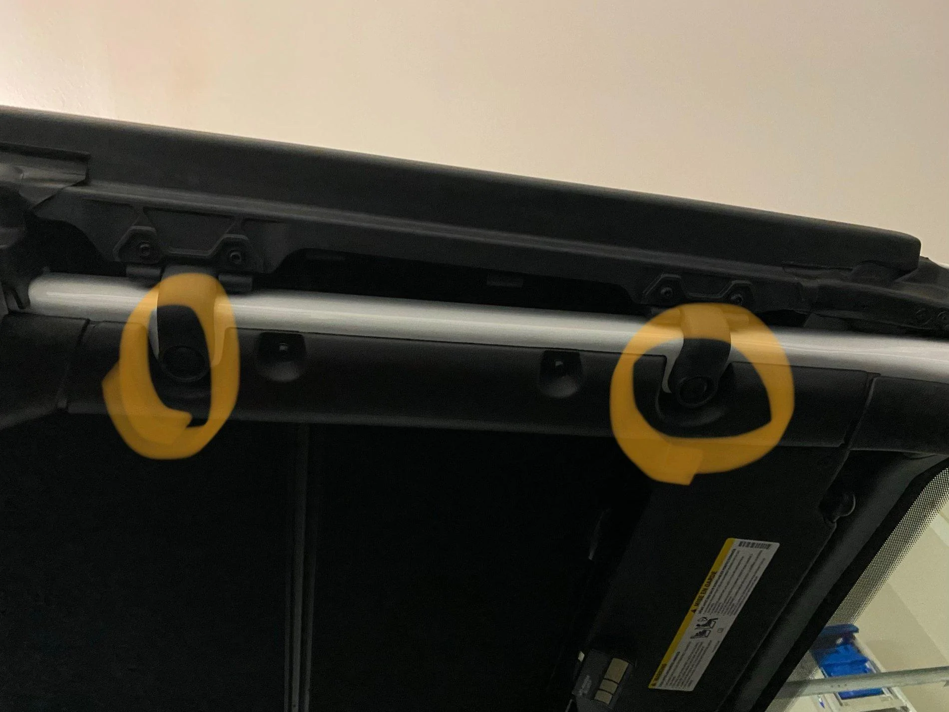

Where would you mount them?
If they were spring hinged like in most cars they would be out of the way for getting in and out. Just seems like a missed opportunity.
Jeep Wrangler JL Grab handles? IMG_9917

There’s already a large built in handle there on the JL.
I am aware, I have a JL, I just meant metal handles using existing mounting points. I don't like the velcro style.
