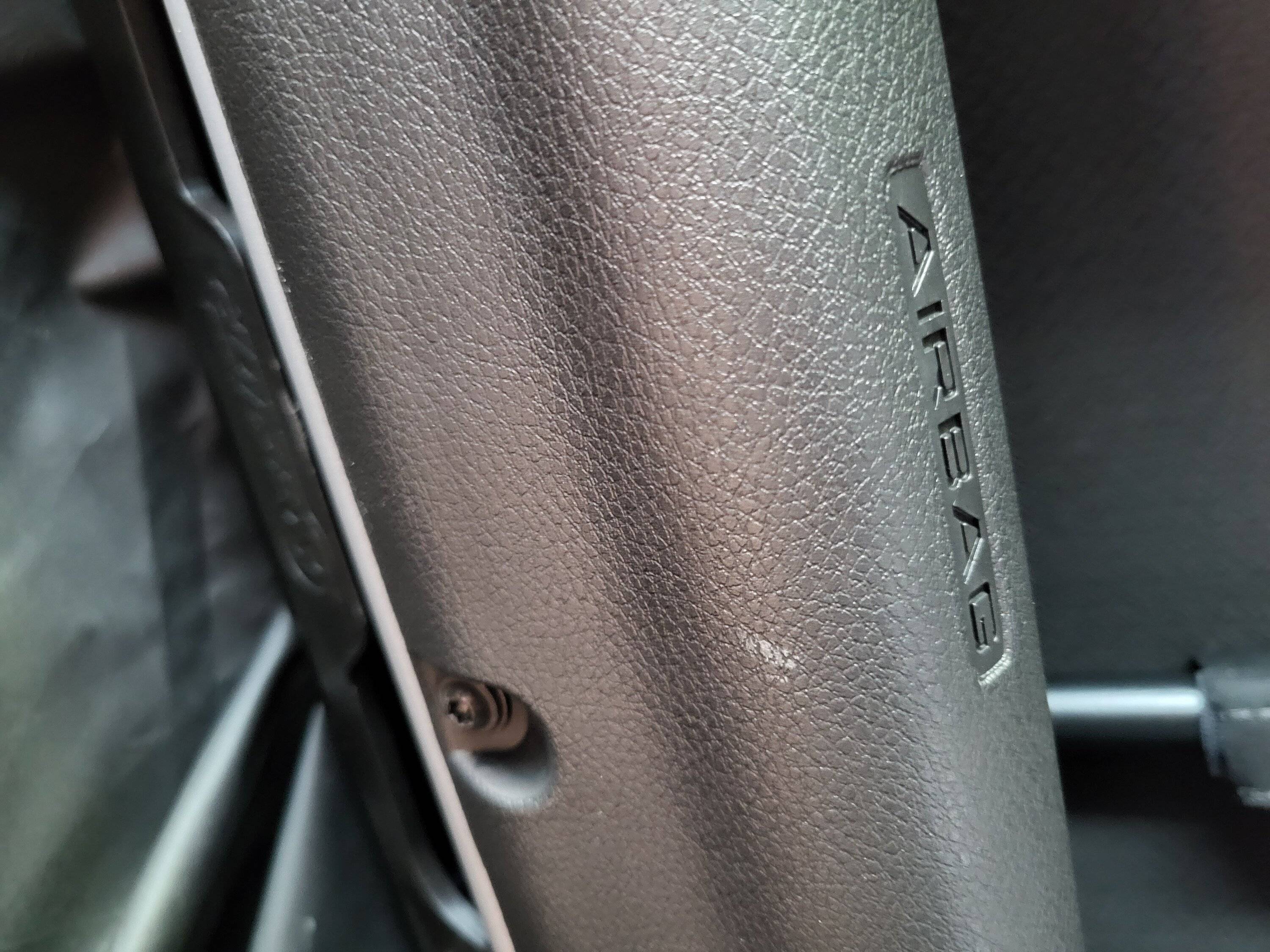

Wanted to know if installing the simple grab handles will interfere w/side curtain airbags?? I have them now on my 18 JLU and was thinking these grab handles may not work on my on-order 24. Anyone with a 24 that can attest?
I think not. There is NO space between the air bag and the roll cage. So it would have to wrap around the air bag. Also, as noted below, the Mopar '23s don't fit. I ordered them and had to return them as they were too small. A larger version will work once designed because the Mopar version hang from the outside and bolt into the top. The bolt holes are there.
Thanks for sharing. I was wondering about the Mopar ones.

2024 Rubicon
No problem. Congrats on the new rig.
I expect they'll redesign them since NONE of the wrap around type will work and the bracket just needs to be a little longer. Allmoparparts.com originally had them listing as '24s but have since taken it down. I'll be watching for the new '24 listing. They were actually very nice.
