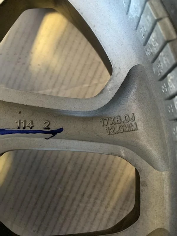

The 392 XR wheel for comparison has a ~4.5 inch backspace, (not sure what the official offset on those are since they are 1/2 inch wider I believe at 17x8, and because it’s almost 4 am here, so my brain is too tired to “math” right now ?) so they stick out at least an inch and half more.
(Hence the little 1.5 inch fender flare extensions that come on the XR model.)
Hopefully someone can chime in with what the offset is on the XR 392 if you need it.
The 2022 Rubicon XR (not the 392 XR) stock wheels are 17x8, +12ET, 4.97" backspace. This is different than what others have mentioned
Thanks for pointing that out, I may be wrong about the backspacing on the 392 XR as well then. Might just be ~1 inch less than the base 392, not 1.5 like I thought.
That's ~1.25" so... you're still close =)
