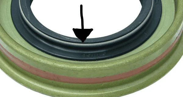

I didn’t know there was a spring. Was it supposed to come off the old pinion? If so, there wasn’t one when Yukon was done with it. I don’t remember seeing one on either of the new seals.
It’s a small metal coil that keeps the inside sealing surface tight to the pinion. It’s less than 1/8” in diameter. Not really a spring, but spring like.
Just like @word302 mentioned, there's almost always a spring on any seal sealing a rotating part inside a rubber seal. These springs are found in a ton of applications. If this is missing or damaged, you would need to replace the seal.

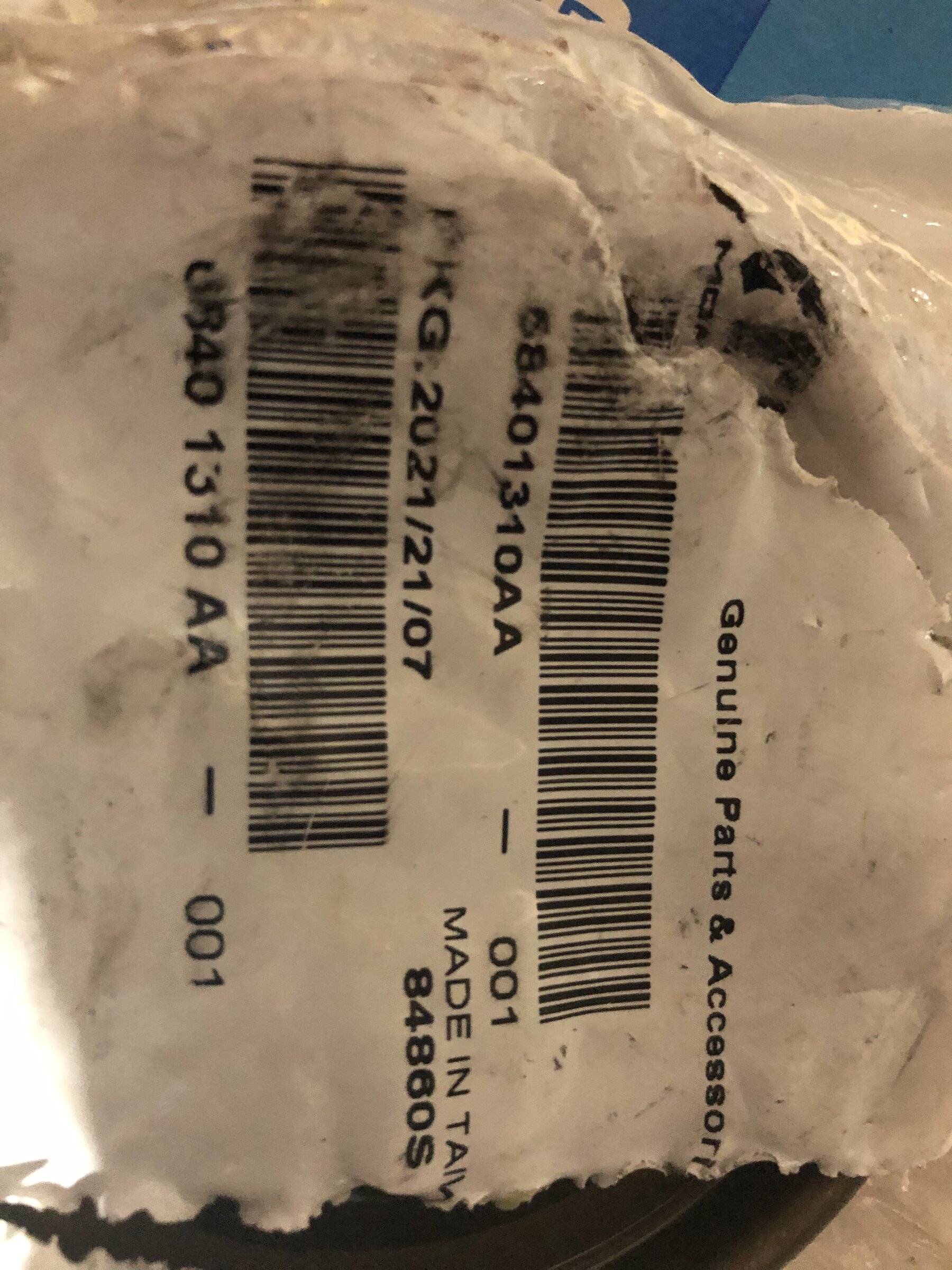

The pinion seal was leaking after 600 miles on my regear. I followed a video and marked the nut and flange and I made sure to put the flange back the same location it came off. Then I lined the mark on the nut making sure to not go over. It seemed to work.
You should be able to pick up one at the parts dept. The Mopar part # is 68401310AA.
I purchase a pinion dial torque gauge because I'll soon be replacing the flange to a CV joint one when I get a 1350 axle.

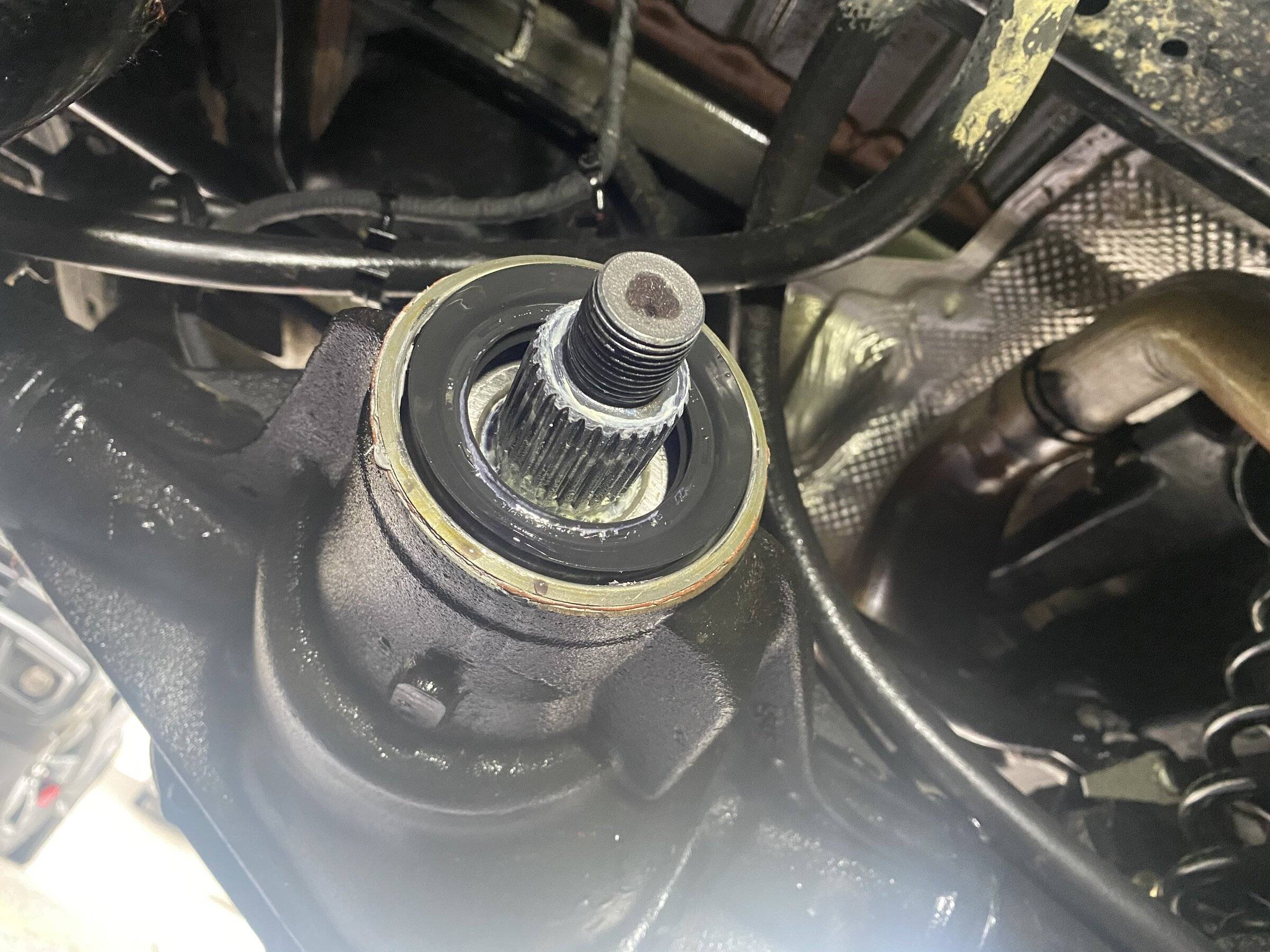

Seal is fully pressed in. I have to remove it to check for the spring, right?
Also, if I added a bit if extra oil would it come out like this? I think I got an extra 1/4 to 1/2 a pint.
