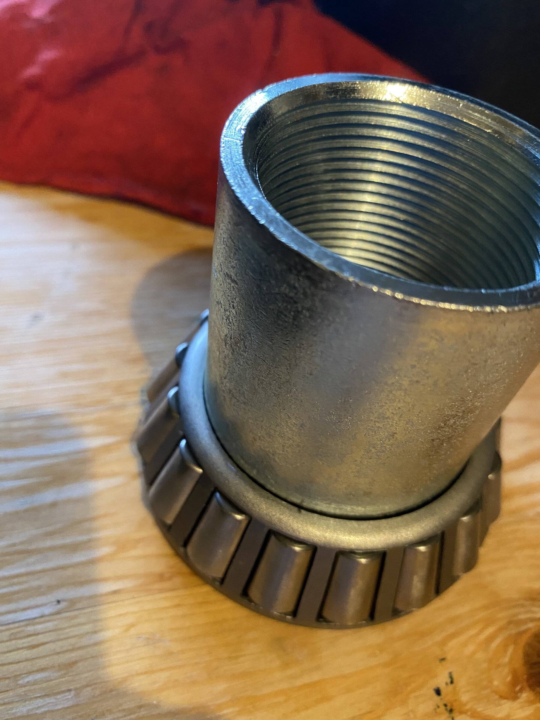

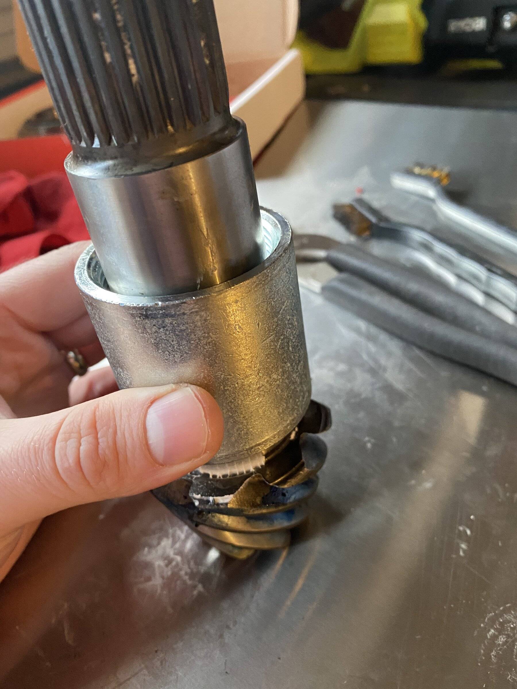

I’m going to try and get the pinion head bearing off the original set I installed (0 miles) and see if it works on this set. I have another kit on the way as backup. I need to find a better press guide. All I could muster was a PVC union that had the right inner/outer diameters. I suspect it deformed under pressure. Either that or I damaged the cage when originally trying to get the stuck crush sleeve off.
On my first setup, I pressed the pinion head bearing on using the outer race. I read after that it was a bad idea. Is it? The bearing distributed the load pretty well, but I guess I wouldn’t be able to detect any flattening of the rollers with my fingers. Obviously my second attempt went poorly using a guide. I’m going to see if Lowes or Home Depot has a scrap pipe selection to find a better, stronger guide.

You definitely need a piece of steel and you want to be pressing on the inner race so that you’re not exerting force on the bearing itself.

I found something. I had to hit a different hardware store to find the right size metal one.
