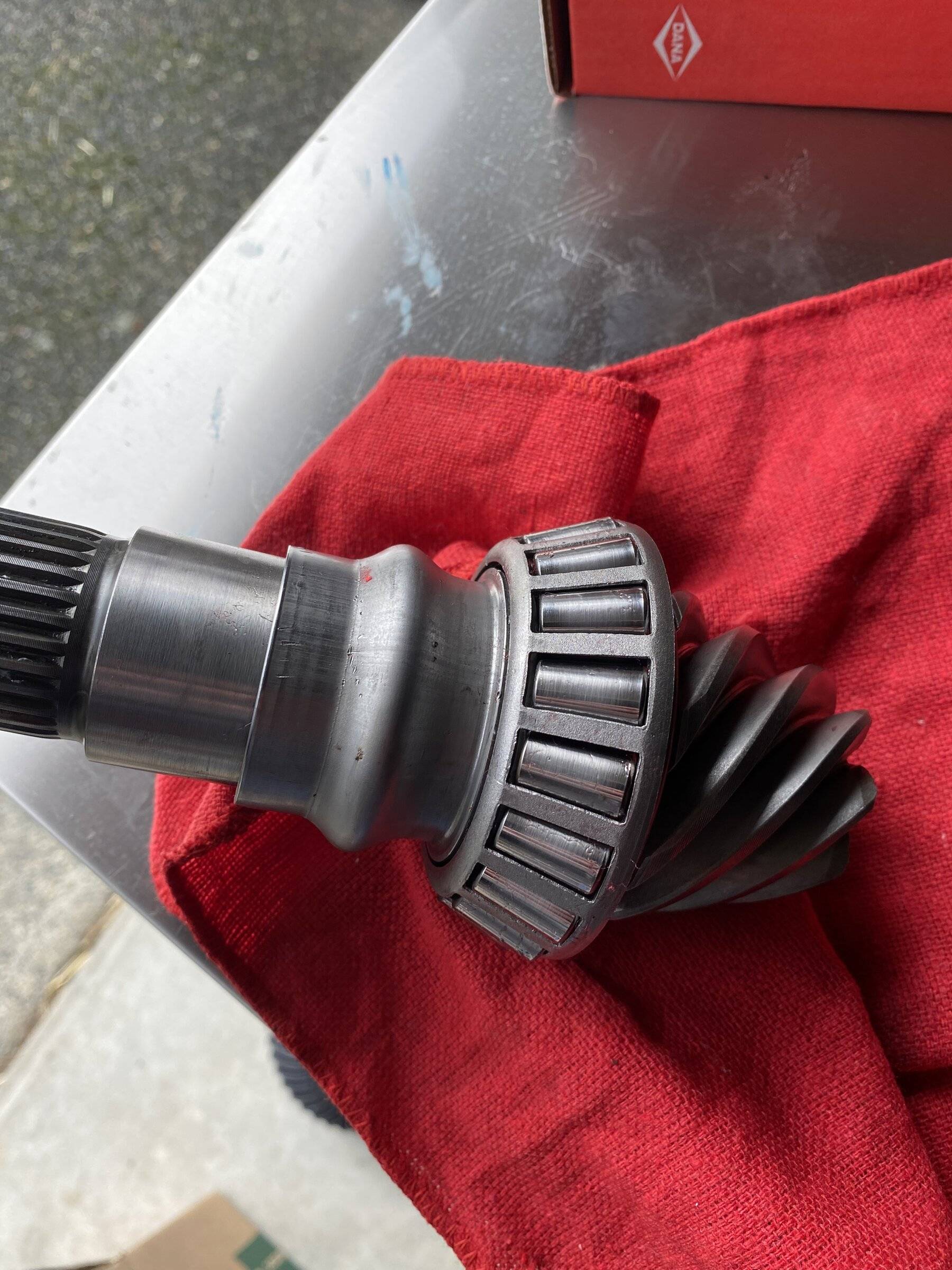

@chevymitchell , I've managed to create new problems. I overcrushed my crush sleeve and can't get it off the pinion. I have spares, but didn't expect it to get stuck. Any ideas? I tried heating it with a heat gun, but might have to go buy/borrow a torch. My other idea is rent another puller and try to grab the bulge in the sleeve to press it off.
My PTTR went from 18 in-lbs, down to 10 on the next hit (weird), then with another quick bap from the impact jumped up to 40.

You just need to get it to move. Once you budge it it will come right off.

Use a chisel and a sledge. It’ll come right off. Calling the UPS STORE now to see what’s the deal with the shafts. I flew to Detroit this morning. Got some time now to check into it.
Just keep pounding around the sides of it until it loosens up? Also, if I go the chisel route where am I putting it?
Thank you both again!
Stand it up with the pinion up and have someone hold it. Hit the bulge with the chisel. It’s not pressed on they just get stuck when they compress. It shouldn’t take much.
What he said. ^

There's something wrong with the pinion. It does not evenly apply pressure. It's hitting a hang-up spot where torque to rotate jumps by about 10 in-lbs. Bearings were inspected for any debris and oiled prior to install. I have a feeling after I get this bolted back together and sort out the axle issue I'm going to have to pay a shop. It was just too beyond me to get it right.
It also took WAY more hammering on the impact with both crush sleeves today to get to my preload spec.
A lot of the time when there’s a small hang up like that, the cage is damaged on one of the bearings.
The sleeves can be tough to crush if your impact isn’t big enough. You can pre-crush them to help that. Throw it in the press and press it .010”-.015”. This will help smooth out the crushing of the sleeve.
