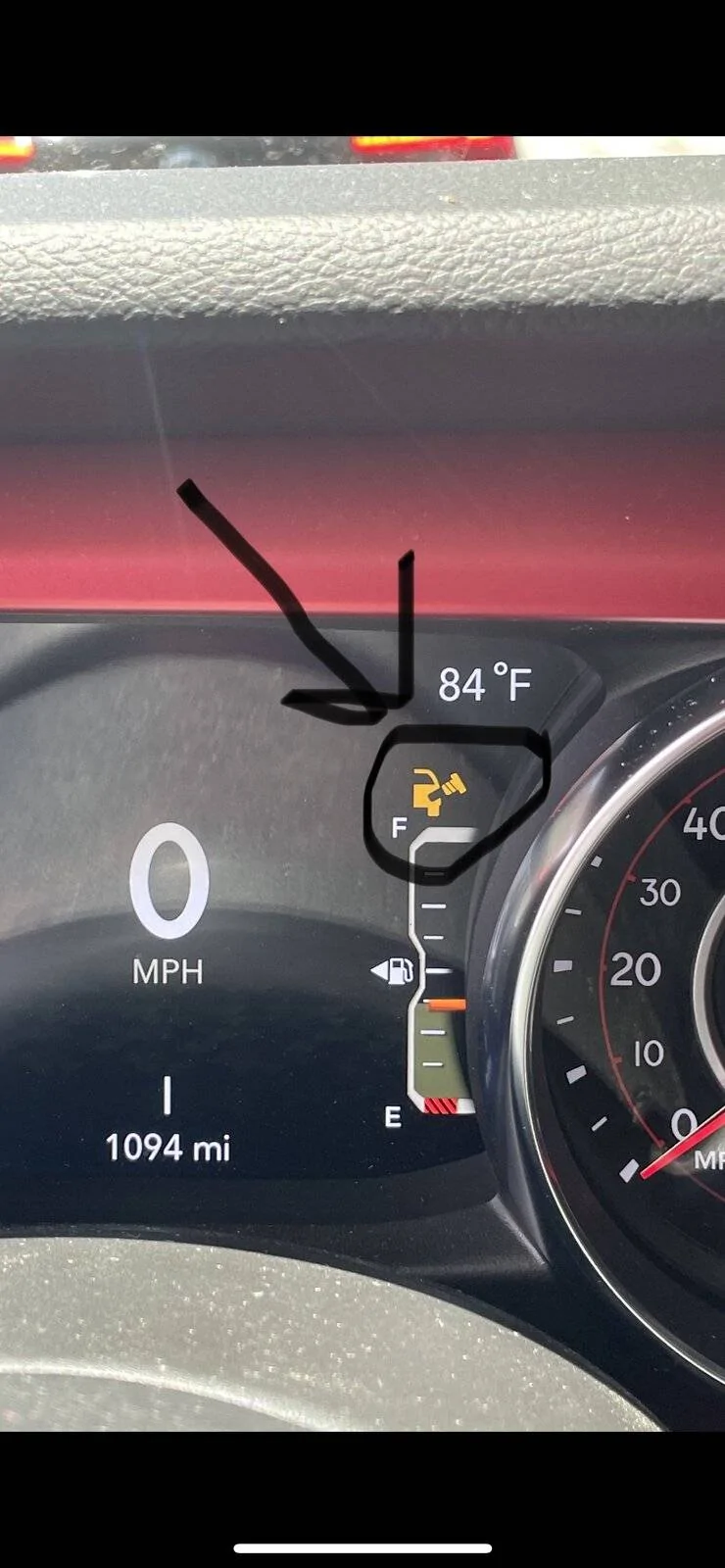

You may have seen and placed the fuel cap back on/tightened it, before the JL alerted you.... or... you may just have missed the EVIC (see pic below) warning and you took care of the loose cap and the EVIC warning went off..
