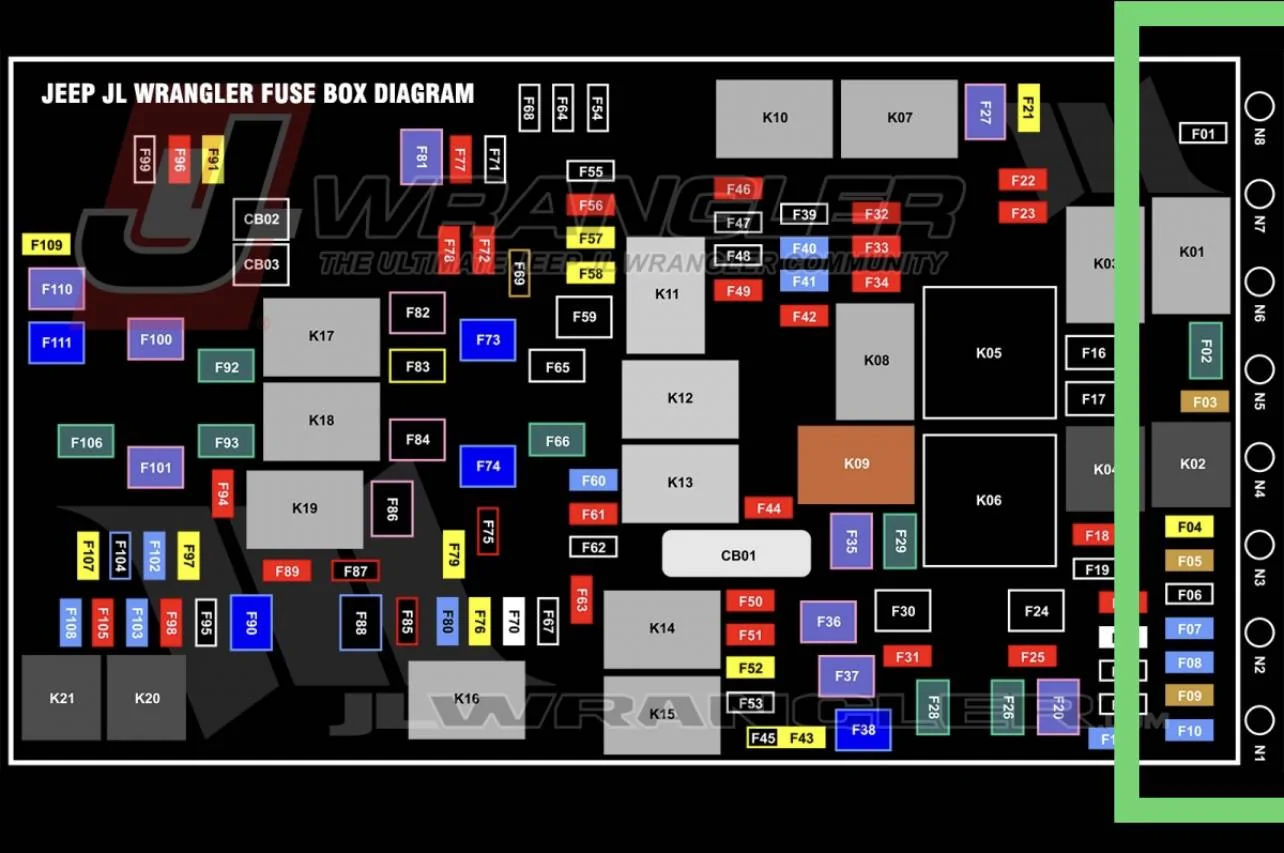

So I was looking at the wiring options, grounds and power diagrams - after popping the hood and the fuse box to plan out the aftermarket lights and audio, I noticed that the fuse box has posts facing the engine but still connected to the fuse box (diagram shows N1, N2, N3, etc) but no where have I seemed to have found what those connect to - however I haven't traced wiring or connections.
Does someone know or have used those posts for grounding points or does anyone know their purpose? Ive seen and talked to a few other owners of JLs and JKs but no one has Any help is appreciated.

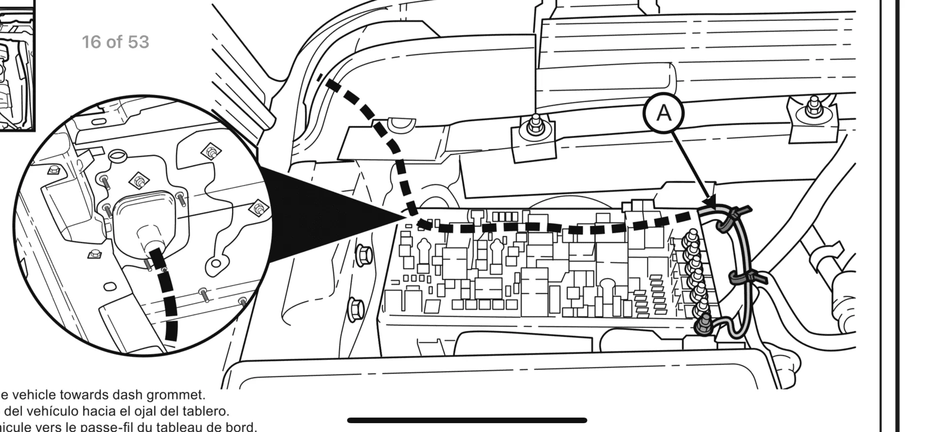

I believe that’s where I tied in for Mopar aux switches per the instructions. It’s been a couple years and I’ve sold that vehicle so I can’t check. But you might look up the Mopar aux switches and dig through the instructions for locations. However, it did requiring programming the Uconnect system to “add” the switches, so they may be controlled by the CAN bus, I’m talking out of my pay grade here, just want to make sure you’re aware that it may be more complicated than just “plug and play”
Edit: found the instructions, it shows connecting to the positive terminal of the battery and another (controller?) wire connects to the fuse box
https://s3.amazonaws.com/rp-part-images/assets/583e7df885ad0a1c3503bd127a233047.PDF
I think I just learned something...are there instructions that should have come with the aux switches? Never seen or heard of this, but would be very interested if you could scan and post, or just provide a link. Many thanks.
I linked it in the post above ?

The underside of the PDC (fuse box) lid tells what the fuses and those terminals are for.
LOL...thanks....totally missed that. Wow, those are some lengthy and not-well-explained instructions though! Much appreciated.

i definitely appreciate that info. Truly.I was just wondering if those are all power or can they be used for grounding points.
? there’s a couple good chassis grounds on the passenger side, above the fender, near your capped off aux switch wires.
You need a multimeter.
All power as identified on the lid.
