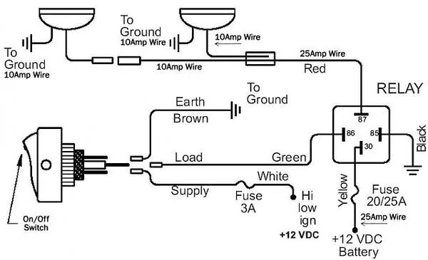

Not sure I'd recommend that route, as it's a pretty significant power draw to your system. Personally, I'd tie the power directly to the battery using an automotive relay that's engaged by your on off switch.

Shy of upgrading to one of the above options, the direct relay approach would be your most cost-effective and reliable option.

Find an empty fuse slot that's only hot while ignition is on. Get a fuse and pull the filament place it in the fuse slot. Wire a relay off of that connection. Also place a legit fuse inline of the new setup.
