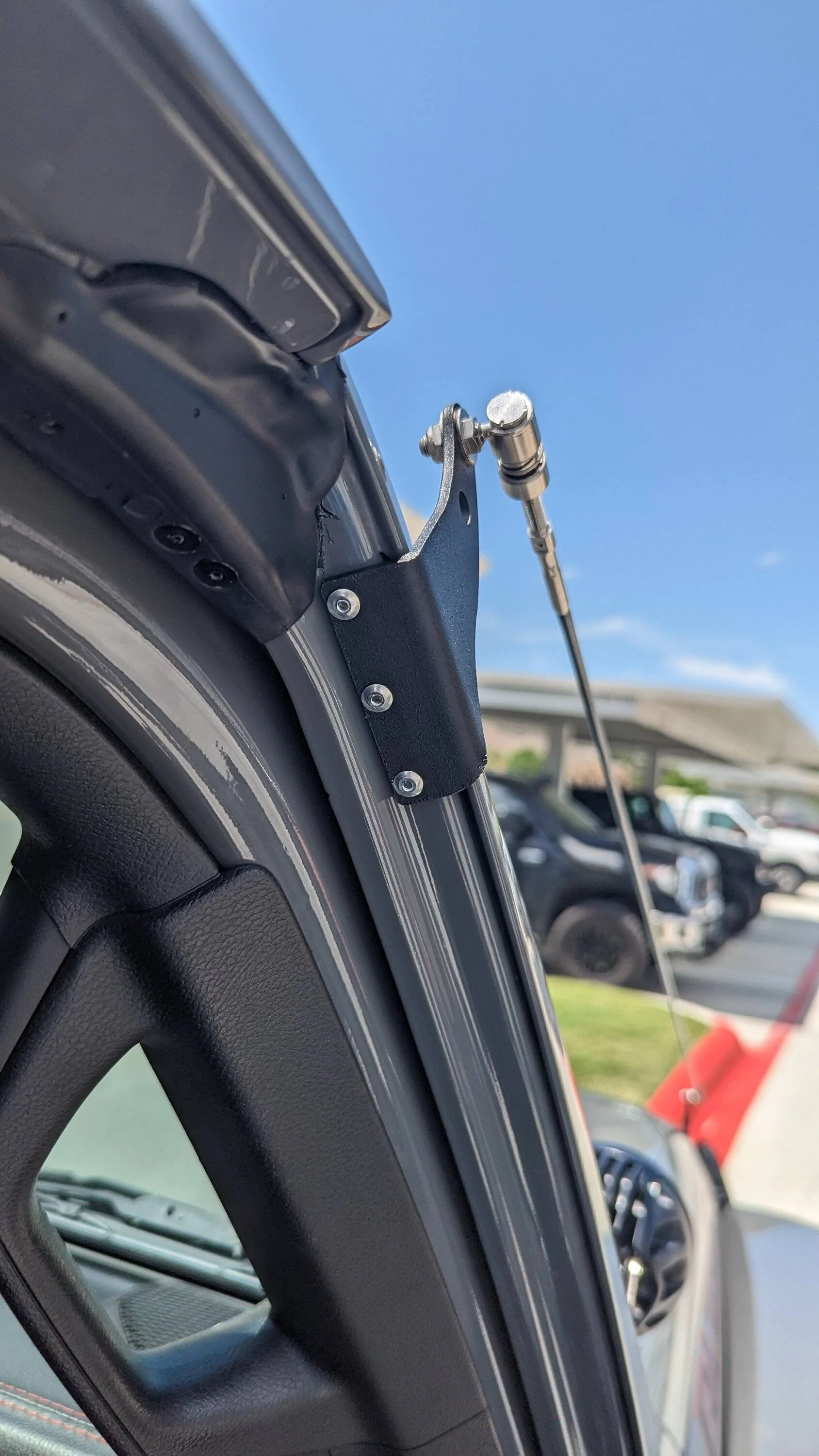

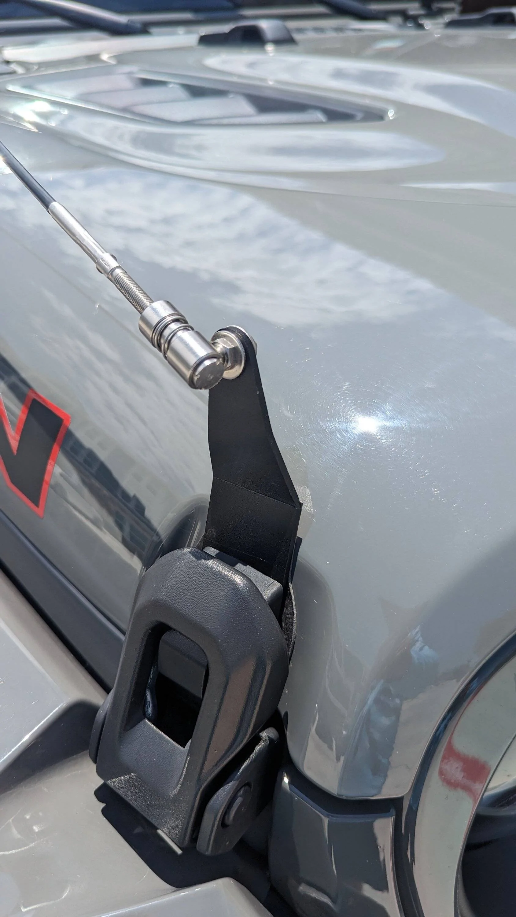

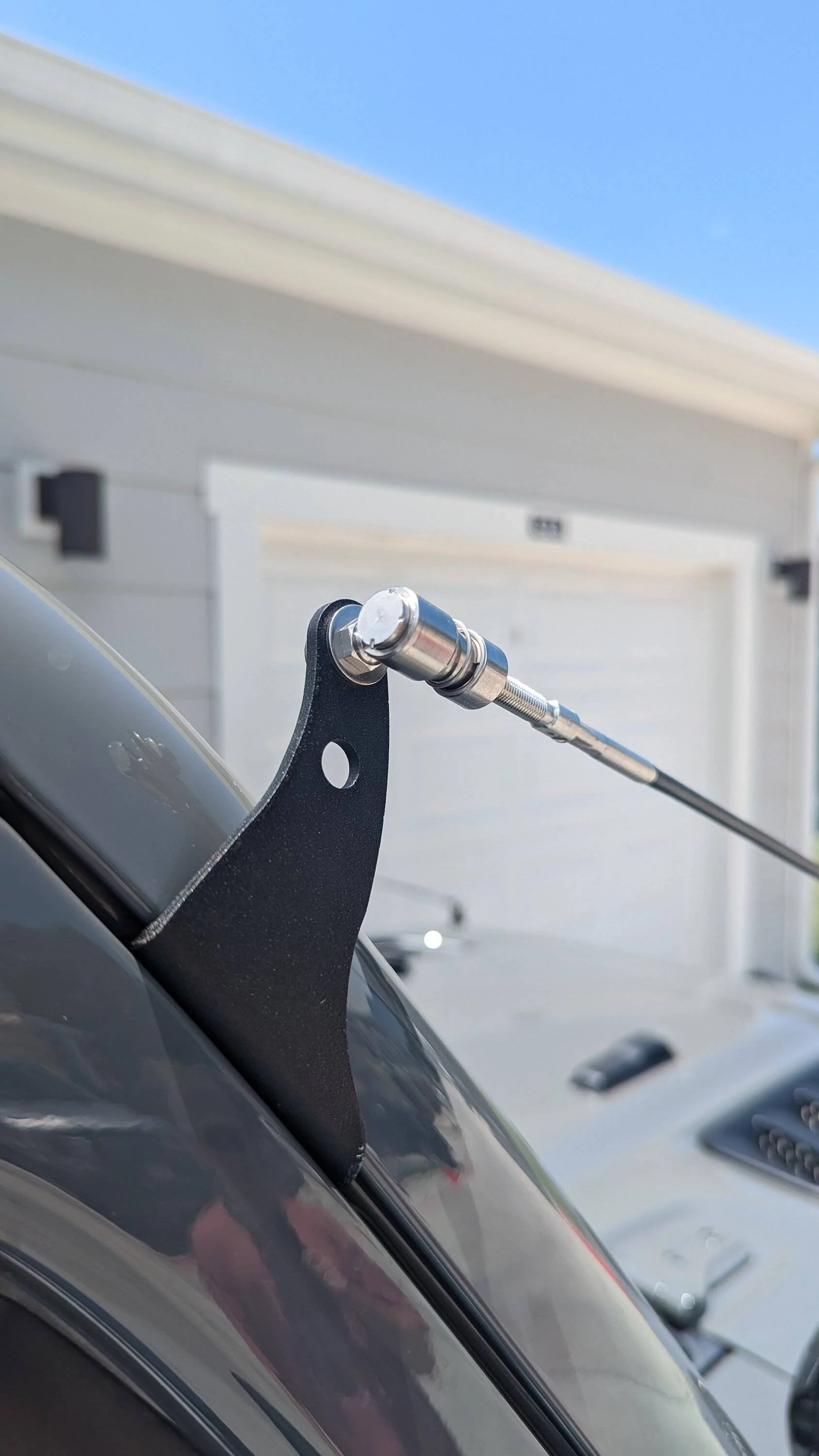

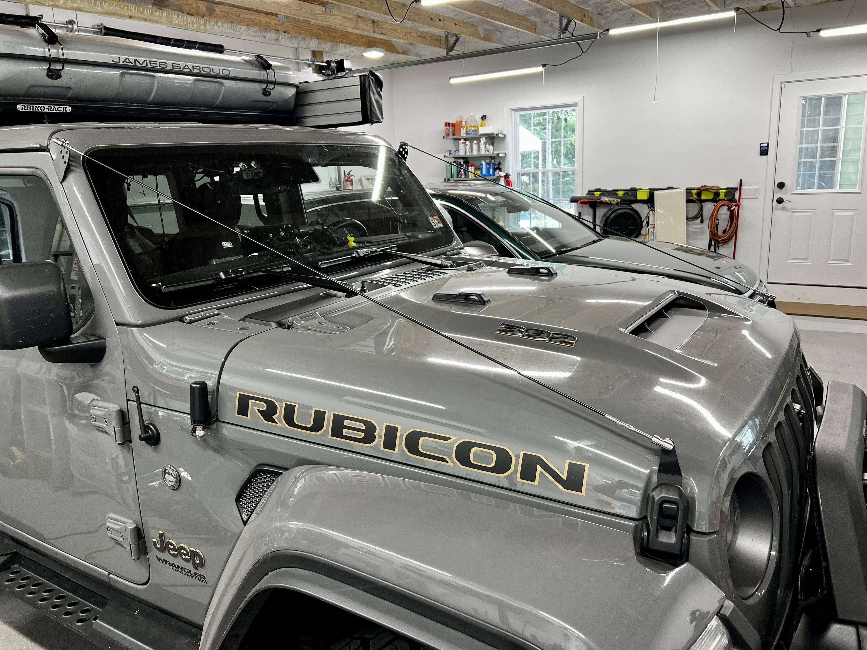

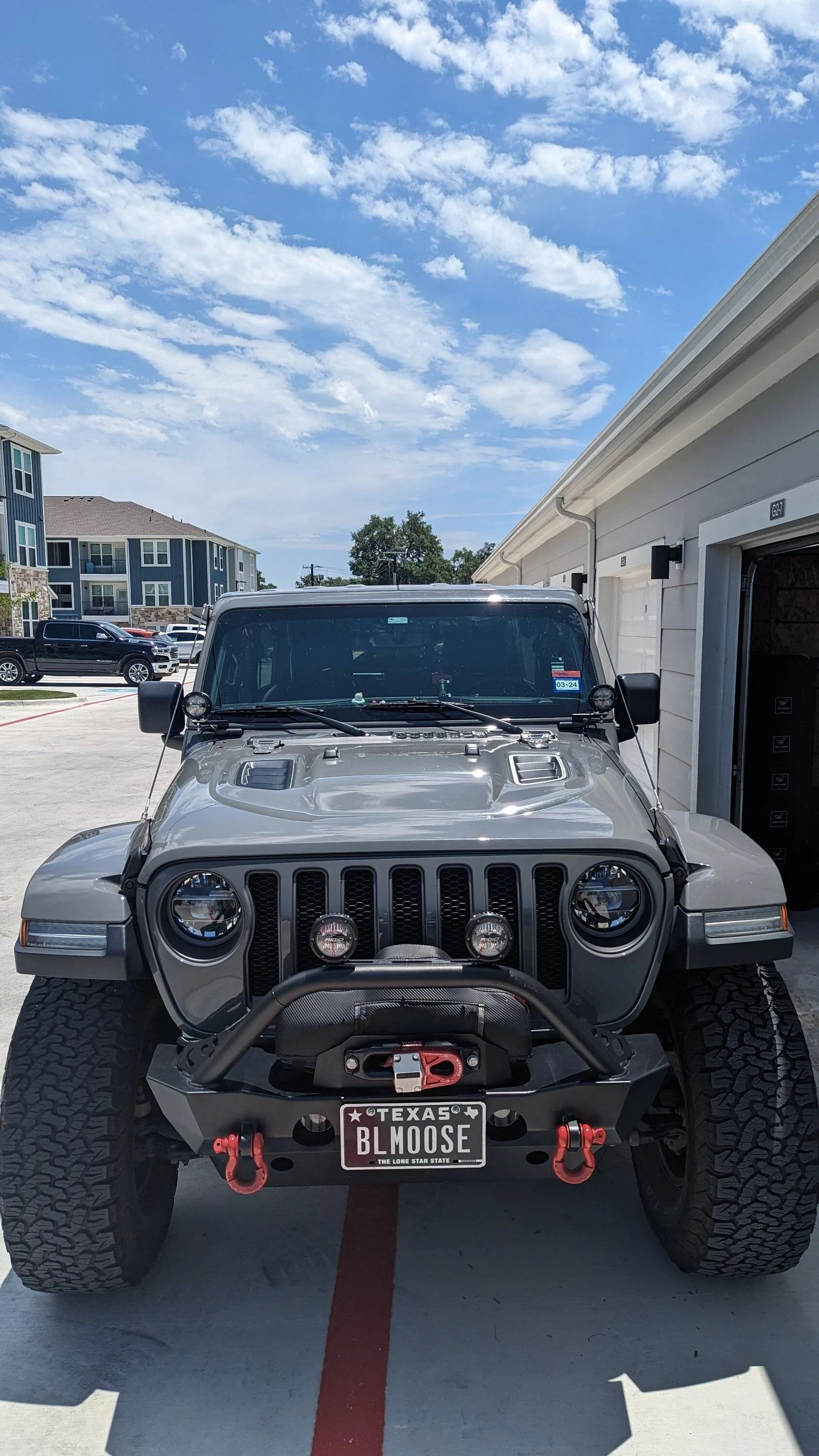

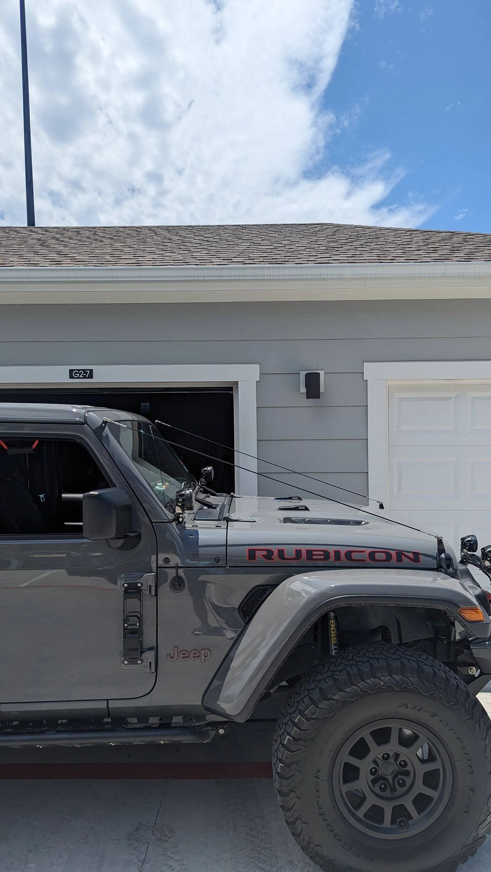

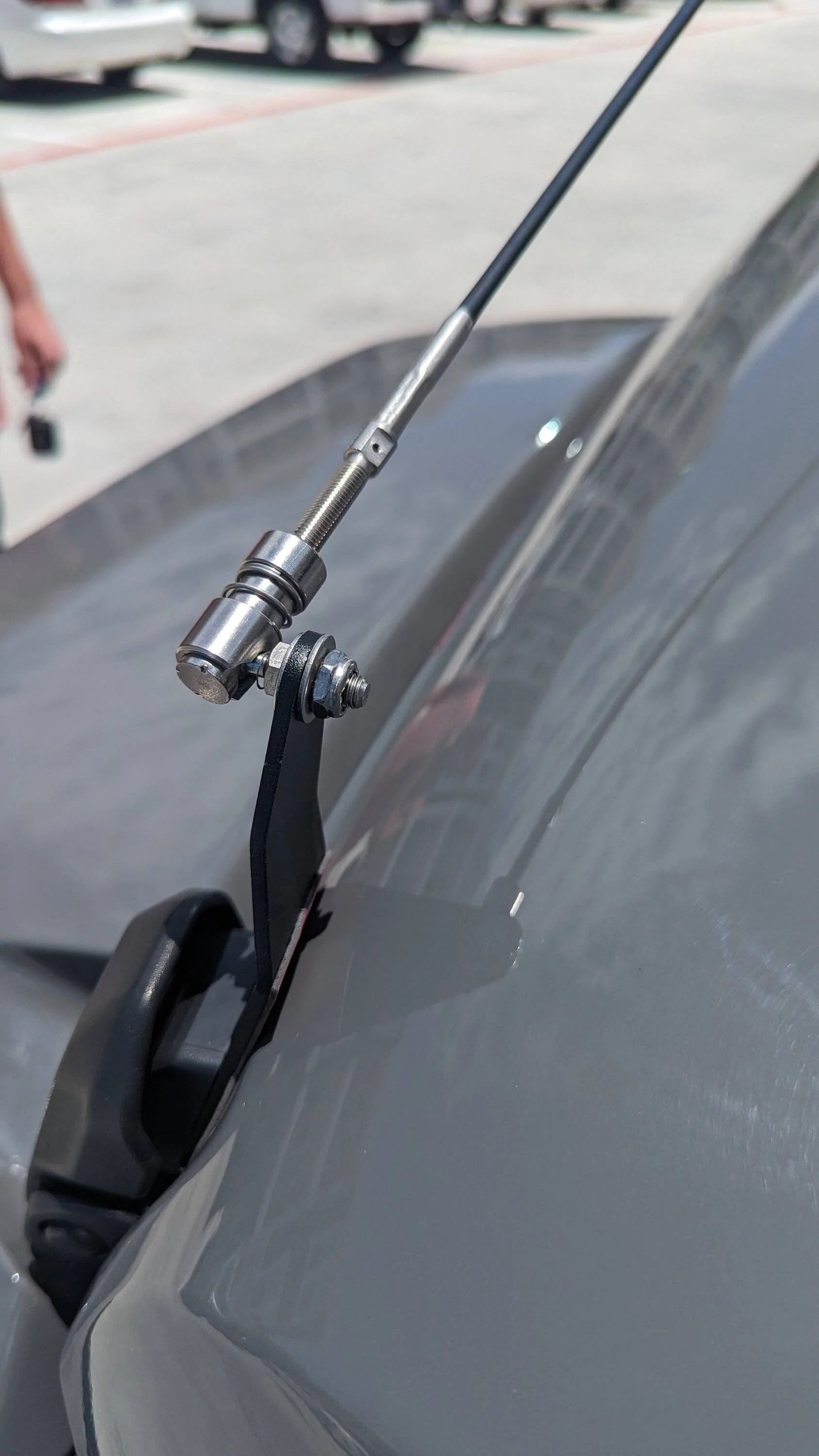

Wanted to say thank you to @BullMoose1776 for putting this together. Just made a set of these myself for my 392 from this list. Way sleeker than anything else out there. Love the minimalist look to them.
Jeep Wrangler JL Functional Limb Risers IMG_6094
Here's the list:
You can choose any brand of Limb Risers you want, and you might be able to start there and make them work. I didn't like the heavy turnbuckles. I just wanted a sheathed wire, so that made it much more complex (and costly) for me to complete.
STEINJAGER: Qty: 1, SJ Part# J0030493, Price Each $50.99, Description: 5 Pack, 1/4-28 x 1/4-28 Stainless Steel Quick Disconnect Cable Ball Joint, SQi250 $50.99
WICKS AIRCRAFT SUPPLY: Stud End; Break Strength Min :2000; Cable Diameter 1 :1/8; Sold By: Each; Thread Size: 1/4-28 $7.00 (x8) (you need 4 but you should Buy 8 in case you miss measure, which is easy to do.) $56
AMAZON: Muzata 165ft Black Vinyl Coated Wire Rope 1/8" Overmolded to 3/16" for 1/8" Black Cable Railing System Stainless Steel Aircraft Cable 7x7 Strand Indoor Outdoor Decking Stair Balustrade DIY WR17 WP1 (165 FEET) $75
AMAZON: Marine Bolt Supply; Stainless Steel Thin Jam Nylon Insert Lock Nuts 1/4-28 (pack of 25) $11.95
AMAZON: BLIKA 10 Ton Hydraulic Crimping Tool and Cable Cutter, Hydraulic Wire Battery Cable Lug Terminal Crimper Crimping Tool with 9 Dies, Wire Swaging Tool for 1/8" to 3/16" Cable Railing Hardware $65
AMAZON:KOLEMO Limb Risers Kit Compatible with for 1997-2021 Jeep Wrangler JK/TJ/JL Through The Jungle Protector Obstacle Eliminate Rope $40

I haven't done this mod but I believe this is what you're looking for.
MS21259-4RH (shows out of stock)
You would strip the overmold on the portion of cable that inserts into cable end and crimp
with the Wire Swaging Tool.
