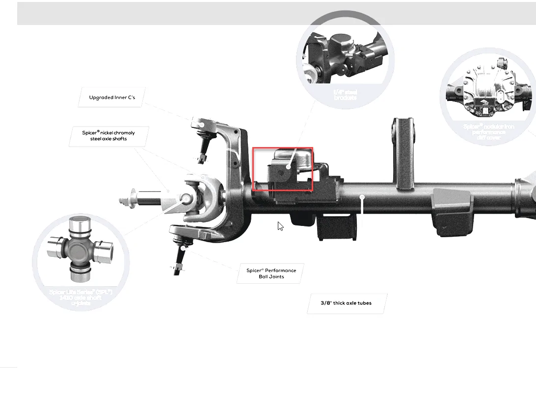

I have searched pretty extensively looking for this answer but haven't yet uncovered it. If it is on here if you could send me the link to thread that would be greatly appreciated. I have been running a UD44 upfront for quite some time and have been battling bump steer. I was looking into Top Mount Drag Link options as but I noticed a few extra brackets on the axle. First Question, What are these extra brackets for (based on my research I believe one is for a "bottom mount" steering stablizer which I won't use but I noticed one near the track bar mounting location. Second Question - If that bracket is for the track bar (pictured below near the passenger spring perch) has any one used it or have pictures with installing it that way? I do have the aluminum steering box and just purchased the steel one and plan on installing it this weekend but trying to tighten the steering just a bit. Thank you in advance.

If I understood your question, and your are referring to this bracket, that is for a steering stabilizer.
The track bar location is about 2" lower and to the right of it.
Thank you!! That's what I was looking for, it is not posted anywhere and have been curious.
