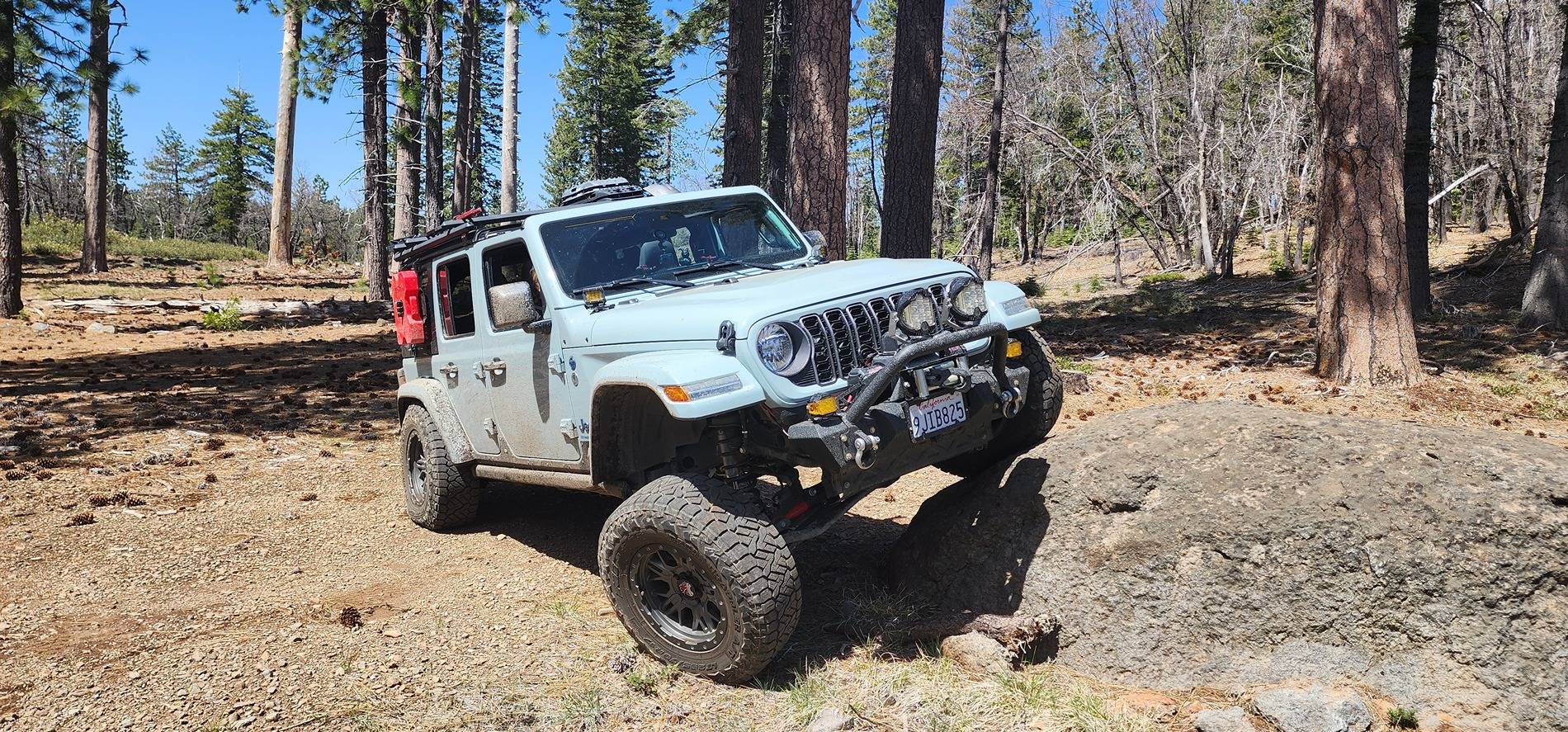

Did you ever get it installed? What are your impressions. I'm definitely getting a front Aussie, and have open diffs f/r right now on a '24 Sport S 4xe. I bought the 4xe not only for the hp ans torque, but they come stock with the Dana M210 and M220, but they also have 3.73's (I wish they had 4.88's so I could run 37's).

Yes, I got all those listed components installed in early 2023. Very happy with the results. The 4.56 gearing is ideal with my 34" tires (285/75-17).
However, I've made one change to the original setup.I swapped out the front Torq Locker for an ARB air locker...
The unintended consequence of running a front unit such as the Torque Locker, is that without unlocking hubs (as all Wranglers are), the TL causes the front drive shaft to spin 100% of the time. With the JL's front geometry, combined with my lift, the setup created a slight vibration at speed.
I wasn't comfortable with it, so the ARB was my solution.

Thanks! Do you have the FSD on the front? I think my 2024 does not, and I believe that was a problem with the FSD. I'm still shooting for an Aussie on the front, but we'll see...
