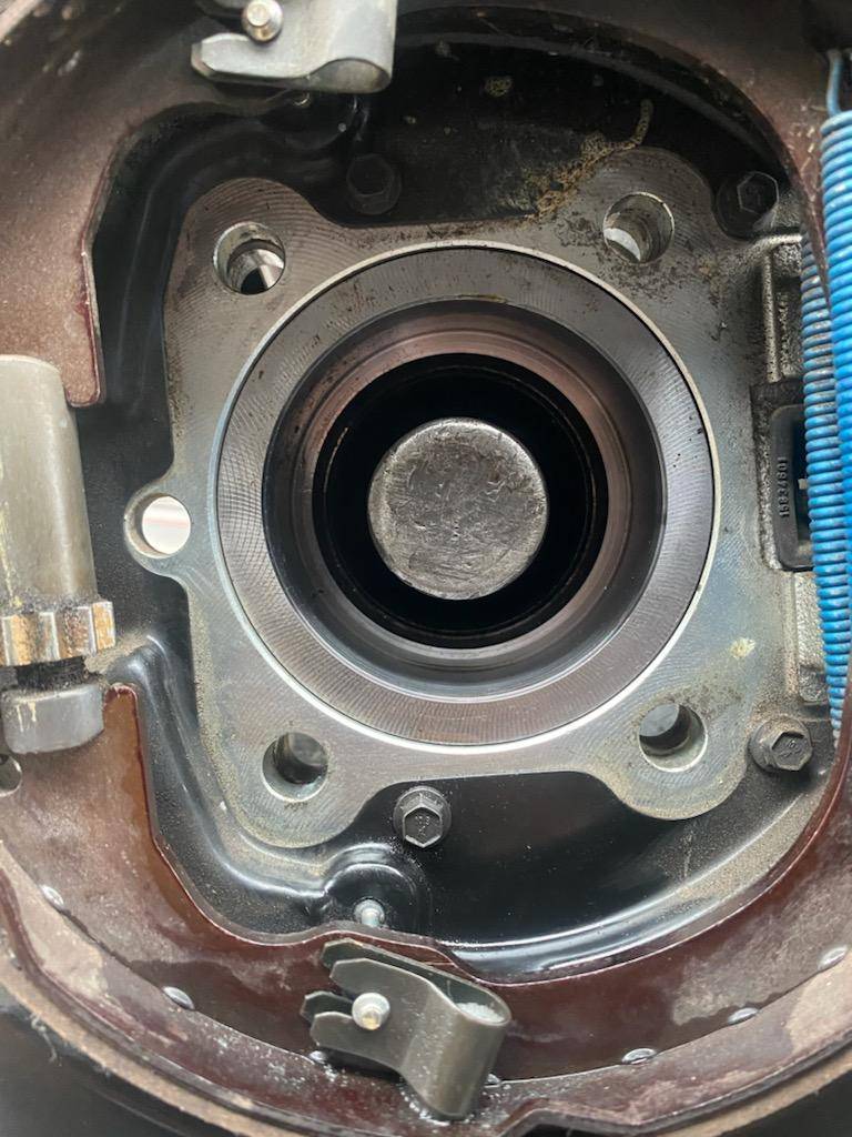

If I take out the drivers side front axle shaft, can I drive around in 2WD like that? Worried that diff oil might come spewing out through the axle shaft seal.
