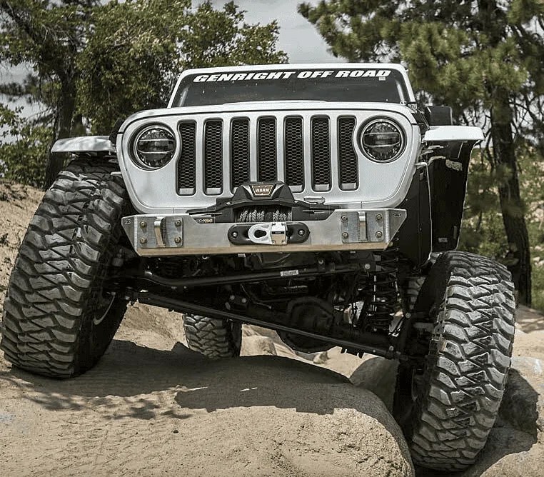

One could install a Rockjock Antirock front swaybar.. To get the best approach angle without shorting the front frame horns, I also installed an Ultra Clearance GenRight aluminum front bumper.
Note: To utilize this bumper, the frame supports for the front skid plate will need to be removed or trimmed.
Looks like you could notch the bottom of the Ultra clearance and keep the crash bars for an aftermarket disco skid like from M.O.R.E. https://mountainoffroad.com/collections/skid-plates/products/jlfsp18-jeep-jl-front-skid-plate This is the best looking front bumper for the JL, the full stubby they offer looks too boxy for me. A black skid below this would almost dissapear.
