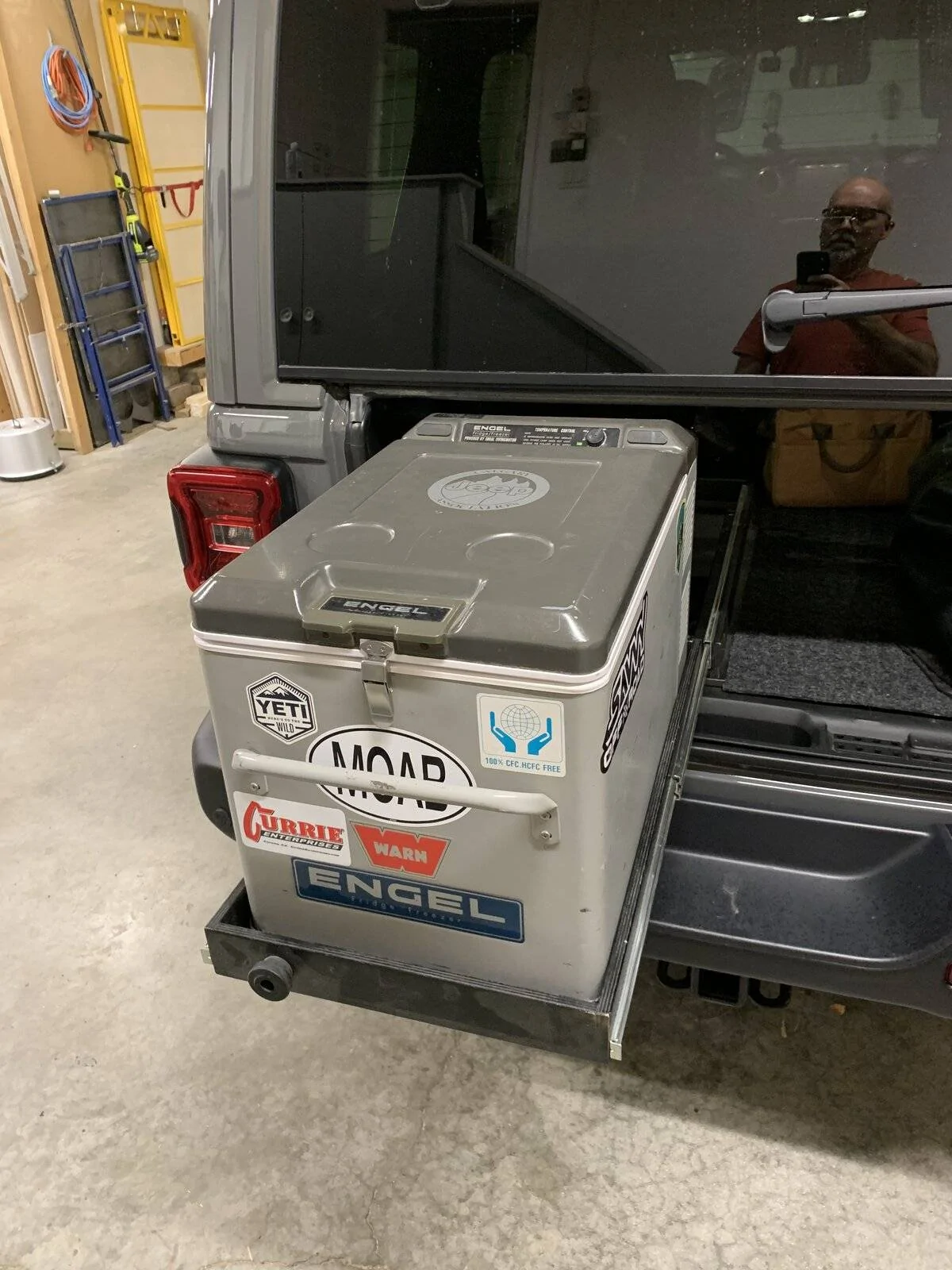

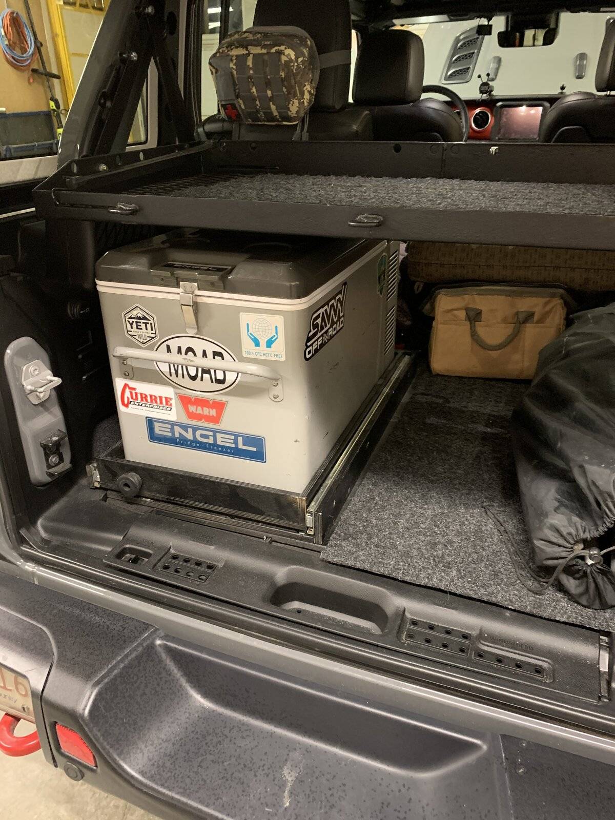

Here’s my MT35 Engel on a home-made slide. Perfect fit behind the drivers side seat and can access without opening the rear window or folding the seat down.

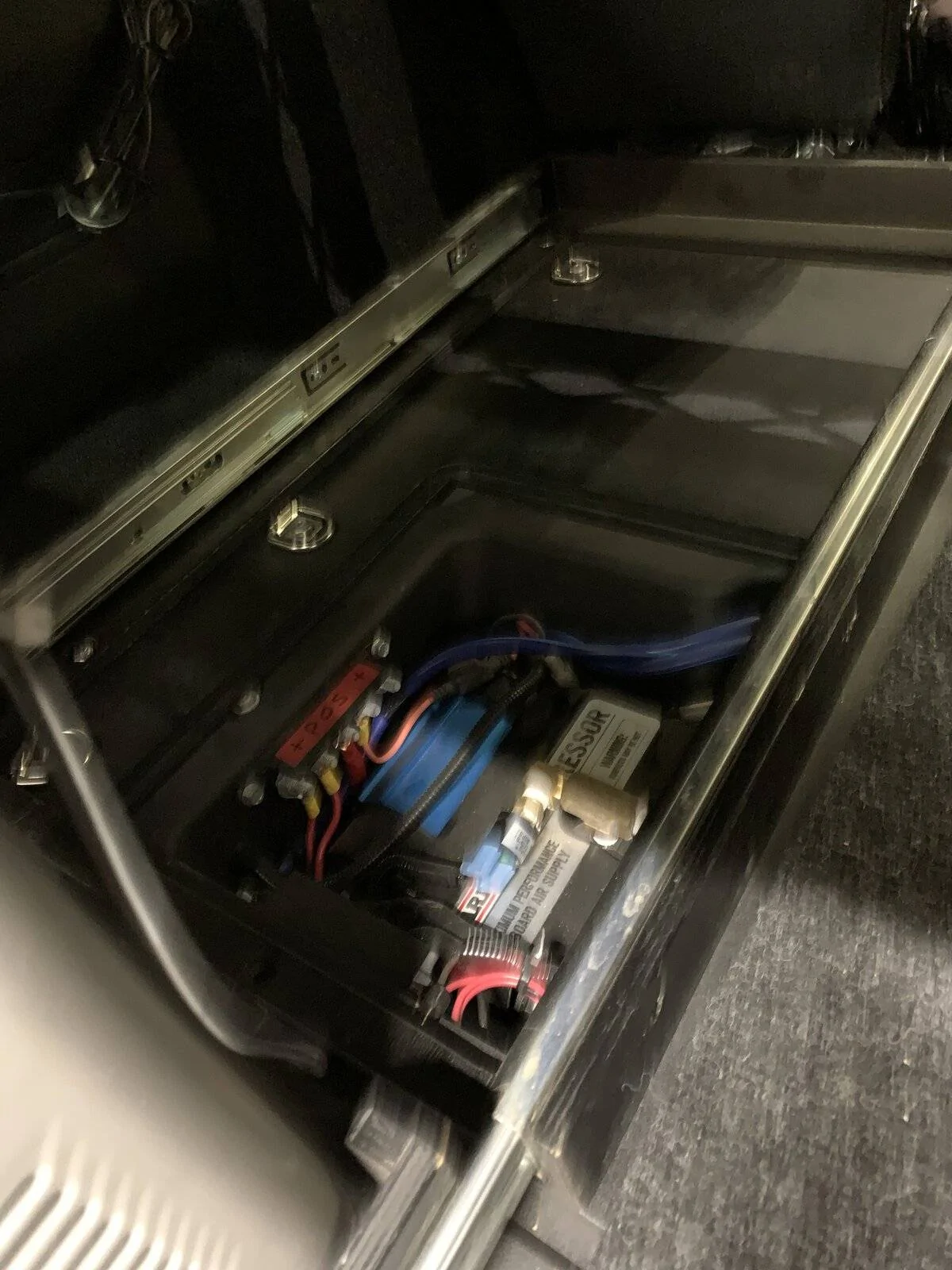

I cut out the slide base to allow access to the storage cubby that houses an ARB twin compressor and auxiliary terminals.
Oh yeah, I can easily run 36-40 hours on the stock battery without running the Jeep
