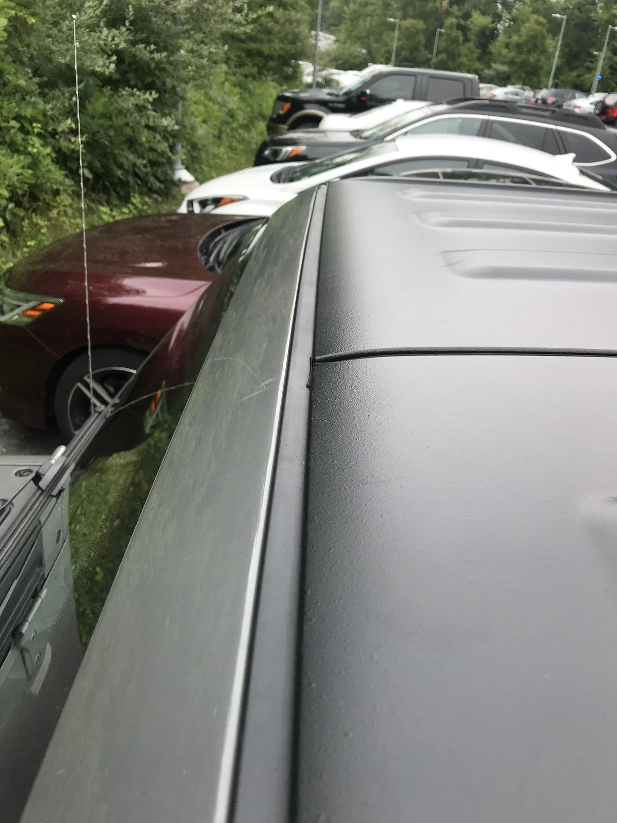

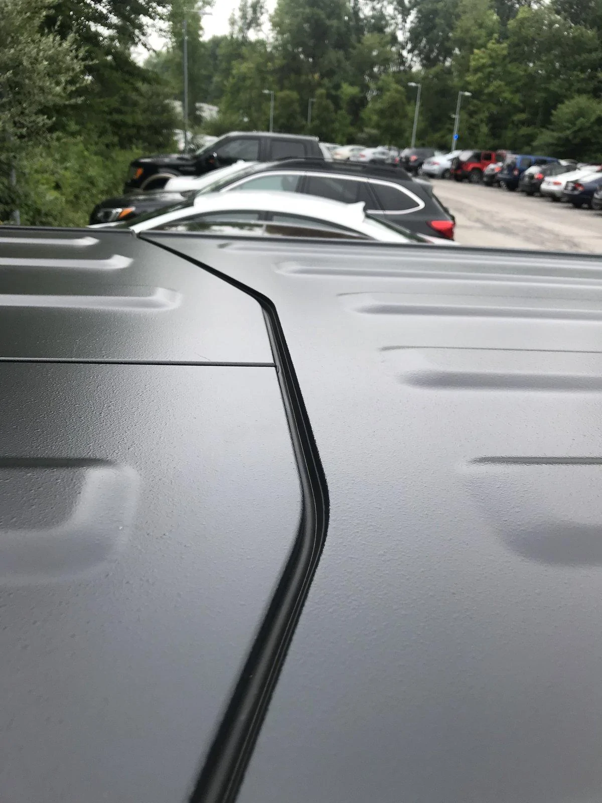

I went back down and played with it more and was able to adjust the bracket completely; however, that didn't seem to fix my issue. If your looking at the driver's side door the height of the freedom panel rain gutter is slightly raised compared to the hard top rain gutter. I tried a few different positions for the freedom panel rear bracket and couldn't get it to line up. I also didn't want to mess with it too much since the freedom panels are lined up except the slight height difference on the driver's side...

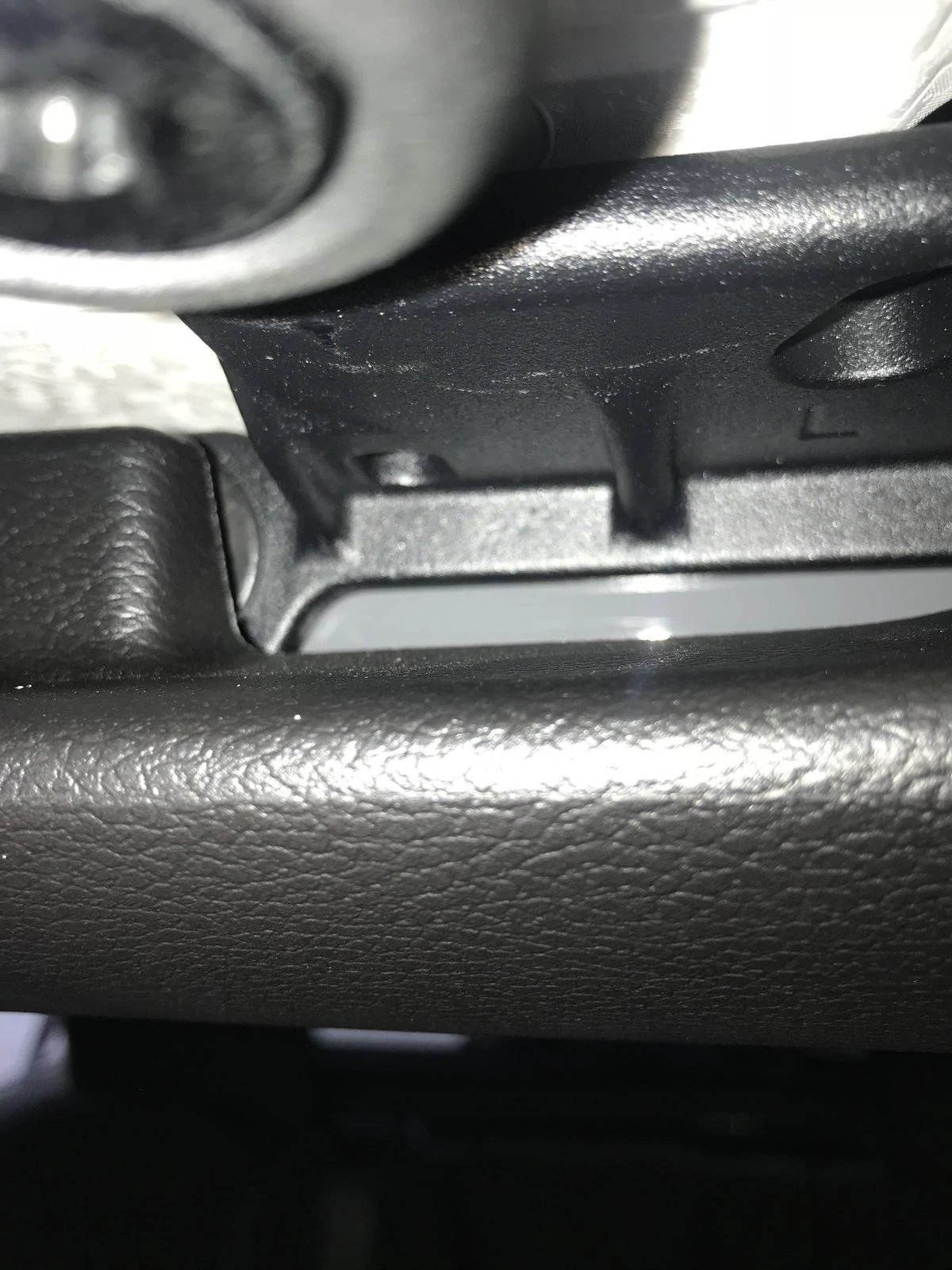

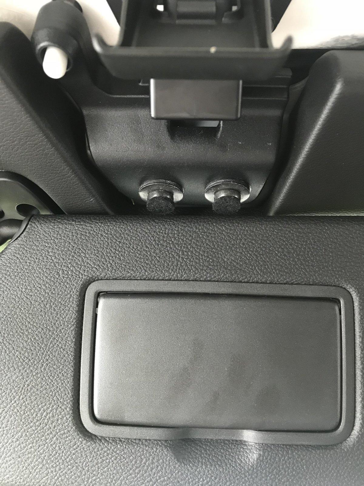

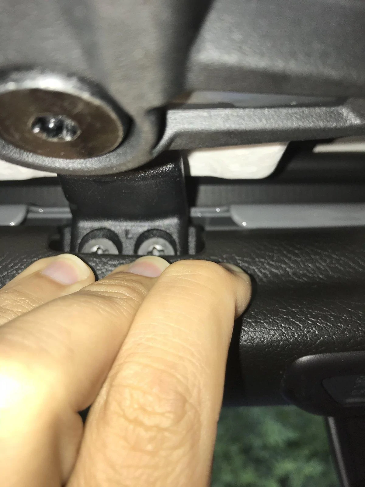

Here are the torx bolt locations:
1st pic shows driver side forward/rearward adjustment, 2nd pic shows driver side front height adjustment and the final picture shows driver side rear height adjustment.
Is there a required distance from the panel and the front windshield area?

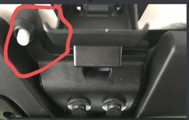

My Jeep is leaking in the front midle of the panel. I noticed that the drivers side white plastic guide bedside the visor clamp is set in the guide lower then the passenger side. I'm not sure if this is normal.
Altitude2020
Oct 29, 2020
325
62
Canada
2020 Jeep Wrangler JLU Altitude
This is the plastic nub that is not the same as the passenger side. The passenger side is 5 mm less in the hole.
