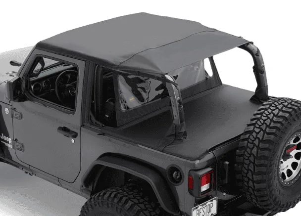

Bestop:
Jeep Wrangler JL Freedom panels and windstopper/tonneau cover combo 1620675901318
It appears the MasterTop option you listed also has the most complete windstopper since it attaches to the sides, which is currently what I'm leaning towards getting as well. All of them attach to the bottom center roll bar in basically the same spot but the freedom tops stop before center bar. With out a bikini the the center bar is going to be exposed and should drain to the top window and cover.

Bestop:
