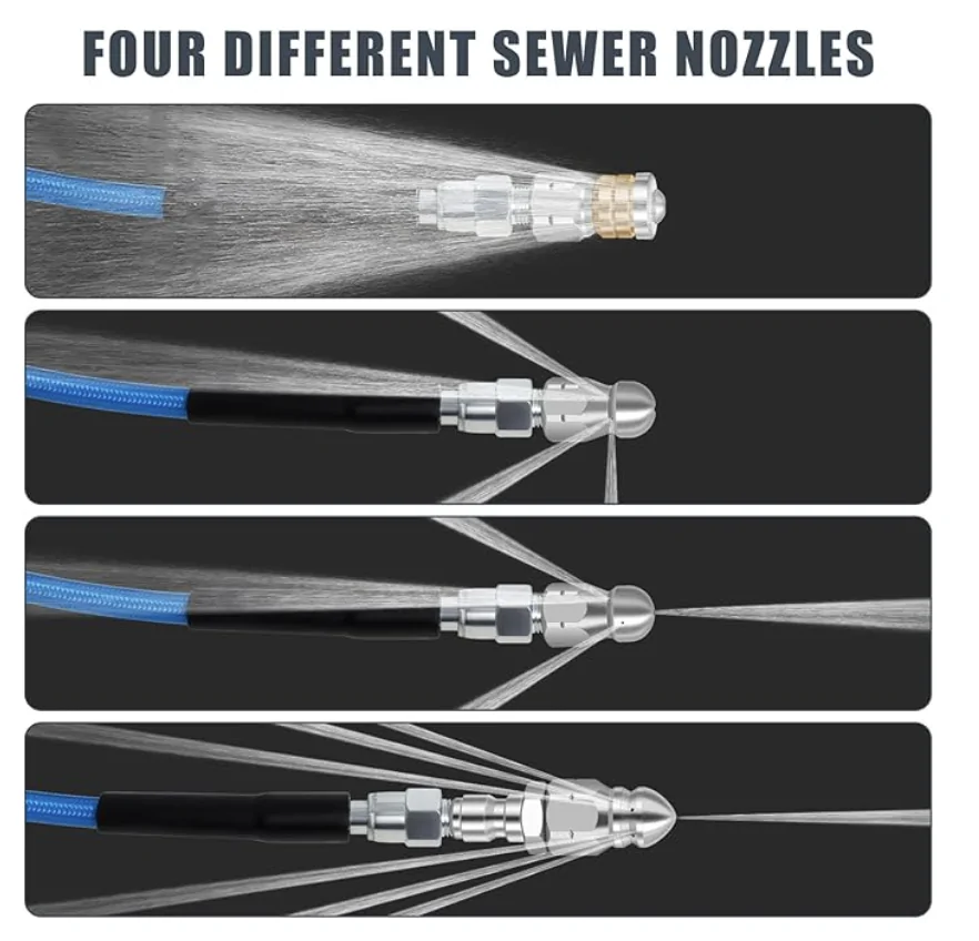

I've been thinking about this and usually will just flush water through the holes until it comes out mostly clean. I think those kits posted above do the same thing as sticking a hose in a hole and flushing water through.
I use fluid film and yes, there's a build up in the frame. From what I read about it (and any lanolin based product) is that water will sit on top of the fluid film, preventing it from reaching the metal. I'm no scientist, but I have no indication of rust anywhere.
As for cleaning the frame rails, I don't think cold water is enough to fully clean it. Whenever I've done it, there was always some dirt and fluid film left. One other option that I've been thinking about is using a pressure washer drain cleaning end attachment. You put it at the end of the pressure washer hose and it sprays water every which direction. You would probably have to take a bumper end off so you can have full access to the frame. I don't know if all this work is worth doing it though.

Back on the computer... This was something I was thinking about. Of course, you'd want a very low pressure pressure washer, as you don't want to strip whatever is in the frame off. But this was the idea I had.
Thinking about it, I don't know if it would work. I know there's a rail through the frame at the front. And thinking about it, there's also one at the rear above the axle. Maybe it'll work, maybe it wouldn't.
Jeep Wrangler JL Frame flushing options Screenshot 2025-09-19 at 11.58.36 AM

That may work
