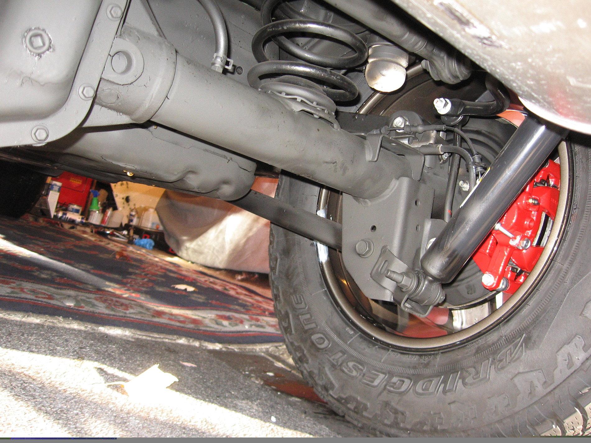

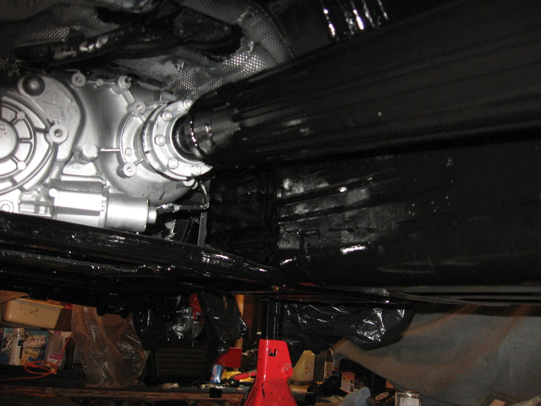

    Eastwoods inner frame coating, for the inside and I paint the outside with Eastwoods Rust Encapsulator and epoxy chasis black. then spray their Heavy duty Rust Inhibitor

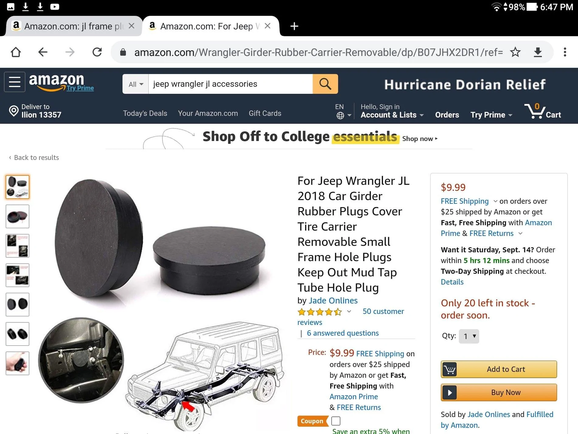

    I see Amazon has rubber plugs for those big holes in the frame
