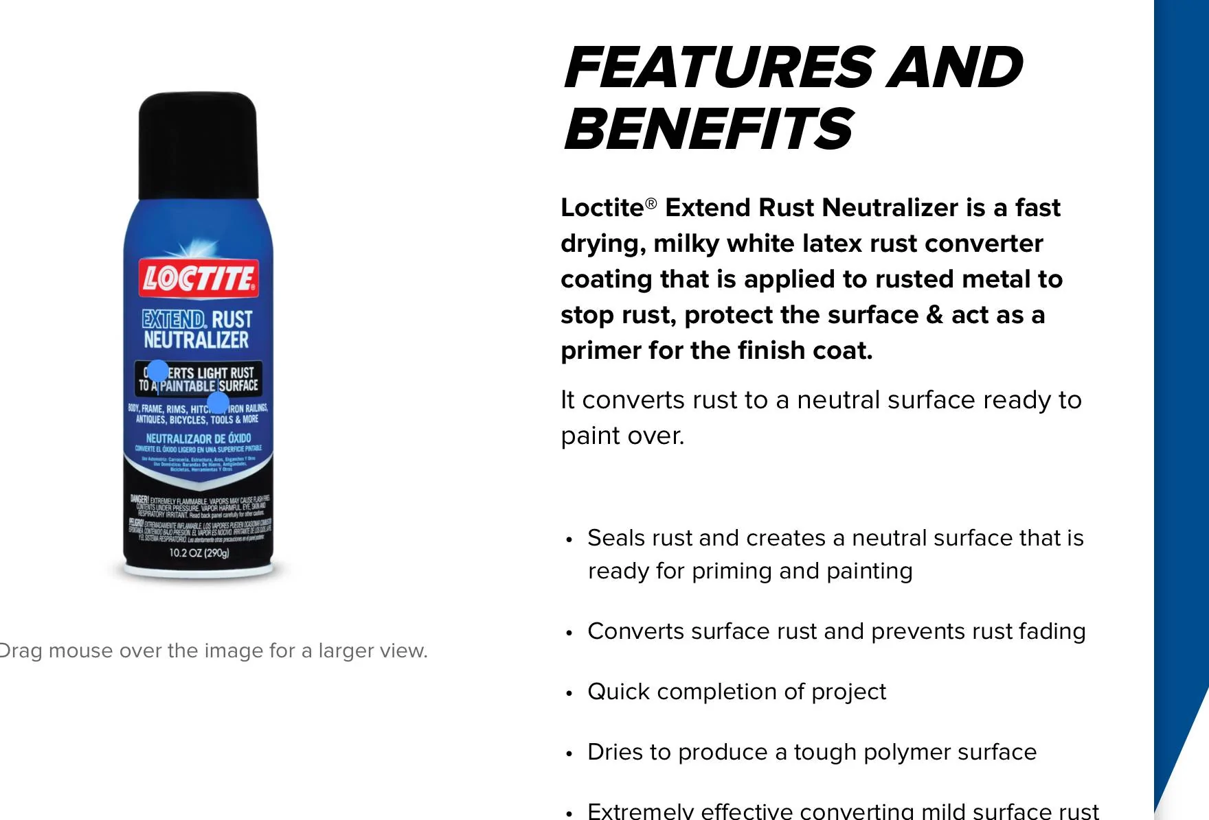

Hi! I have some slight rust on my frame where my front metal fender liners were rubbing against it. What should I use to spray on the frame after I remove the rust? Thanks!
Jeep Wrangler JL Frame rust recommendations IMG_0465
