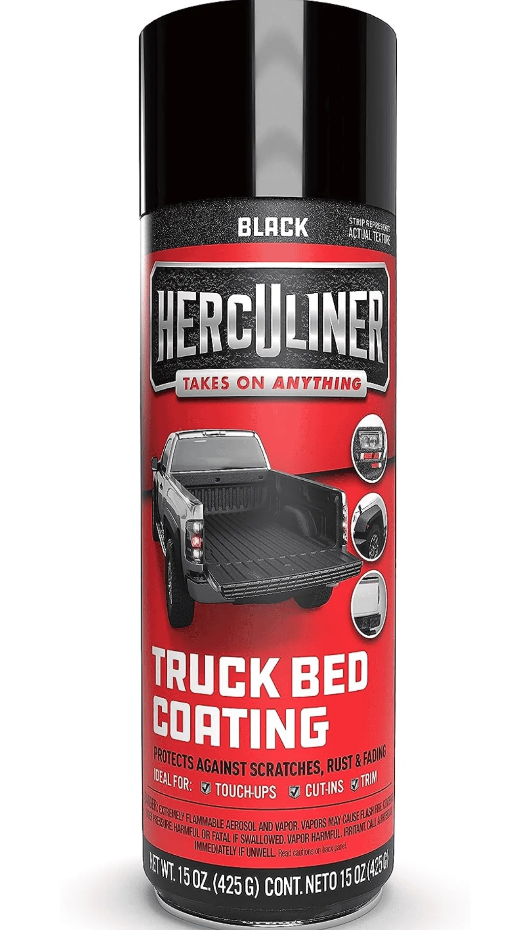

Might I recommend Herculiner.
Jeep Wrangler JL Frame surface rust clean up? Screenshot_20230911-201745-673
https://a.co/d/eP3G1Wu
It's a little more expensive than Rust-Oleum, but it will last 20 times longer. Rustoleum you'll have to respray it every few months, but if you use Herculiner, you won't have to spray it but once every couple of years if that.
1 and 1/2 cans did my whole hood, and I did three coats/layers.
Jeep Wrangler JL Frame surface rust clean up? IMG_20230825_145845708
It's not thick and chunky like some truck bed liner sprays, it's thin and hard and sticks really well even without primer. In fact I've literally never used a primer with it. Including on my hood. Just make sure you clean the surface really well before you spray it so it sticks well.
I had cut off a piece of steel which the sway bar end link connects to on the passenger side of the axle, and was using rustoleum to keep the rust away. I was spraying it every 2 months or less. My dad finally recommended Herculiner, and I sprayed that on there this past March, and haven't had to use anything since.
Herculiner is definitely longer lasting and honestly better quality than rustoleum. I would stay away from rustoleum if you're trying to keep rust away.

The debate seems to be herculiner vs por15. And rustoleum being least desirable. I’ll look into both a bit more. I’m thinking of adding frame mounted rock sliders which may need frame drilling so maybe herculiner for now then por15.
Do both stick to the factory frame paint as is or I need to scuff it up? There’s only a few rusty weld spots not the whole thing.
