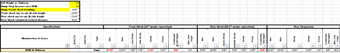

So, I think some measurement and calculation are going to help you out here. For a primer, @AccuTunedJL has a great write up here: https://accutuneoffroad.com/articles/guide-to-suspension-design-for-going-fast-in-comfort/
You can adjust a little with air/hydro bumps, but with stock bump setup you should be around 16.25" shock length at metal to metal bump in front, 17" in the rear.
A great resource to play with is going to be @AnnDee4444 's spreadsheet here: https://www.jlwranglerforums.com/fo...gs-suspension-information-chart-matrix.66591/
Since you run desert at speed, I'd recommend a bunch of uptravel. I run about 5" of uptravel, and would prefer more if I did a lot of speed work. You should be around 3.5" of uptravel in a stock Rubi:
Jeep Wrangler JL Fox shock and spring recommendation 1683553229924
Note, most spring lifts will net you at least a little more than advertised, as they are normally based on a very heavy Rubi.
What tire package are you planning on? Biggest challenge with a shorter lift will be trying to not increase bump stop. If you lift 2" and add 2" of bump, you may improve other places, but you'll end up with the same uptravel you already have.
