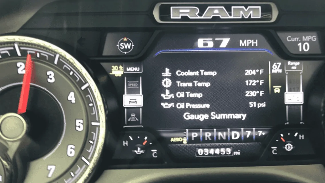

My old ZF 8HP70 stayed in the 195-199F range while my current ZF 8HP75 runs 168-172F
Chrysler’s 850RE seems to run a tad warmer than the ZF units
170 seems low for the 8HP75. I am not positive but aside from torque rating they should be very similar. The 850RE is also a lower torque rating than the 8HP70 but I want to say also very similar design. Chrysler bought the rights to copy the ZF tranny and have been making them in Indiana since 2013 or so. My Ram has been very reliable but not sure if it has a German or US made tranny. I will check the next time I change my oil.
Chrysler uses blueprints but not exact ZF design, they are allowed to make changes under the license agreement.
ZF makes the 8HP70/8HP75 in both the U.S. (SC) and Germany
Yes, my 8HP75 runs significantly cooler than the 195-199F my previous 8HP70 used to sit at while towing 7-8k lbs
