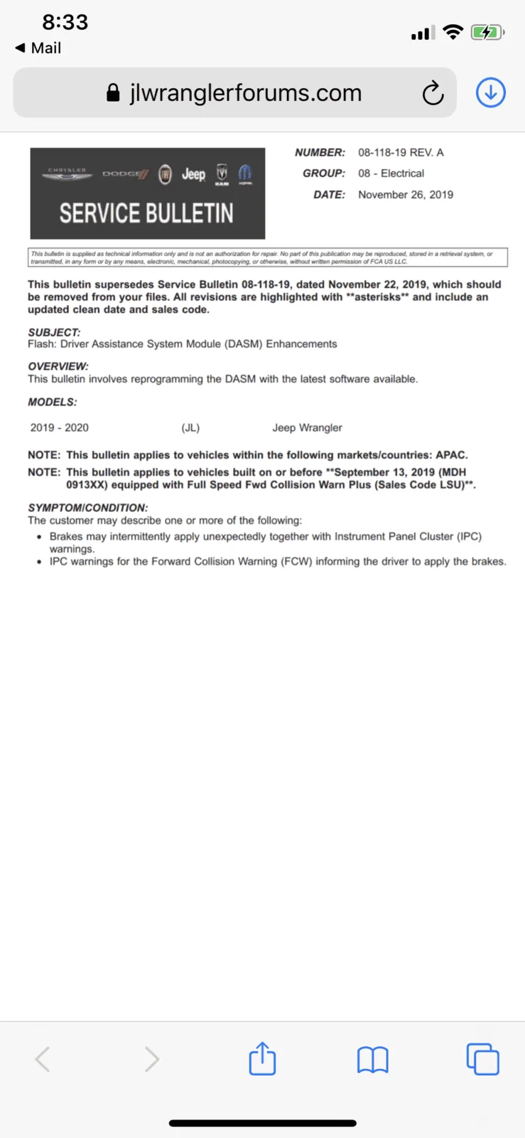

2019 JLUR here. I've had all of these issues happen, and one worse.
I've had the Rubi stop on the lower level of the George Washington from a small stream of water coming from the upper level. Luckily, no traffic behind me and I reduced the sensitivity. Later that same day, Rubi thought the column of an overhead pass was stopped traffic and it engaged the auto stop until I aimed the jeep into the other lane, and it let go. I turned OFF the active braking system. Two weeks ago while raining, system was Beeping & dash said BRAKE, but brakes did not engage. I pulled over and restarted the Rubi and it was fine. Last week, going through the lower level of the Verrazano Bridge during rush hour traffic, Rubi did full stop WITH THE SYSTEM OFF as it thought tiny dripping of water from upper level was an obstacle. SUV behind me stopped in time, albeit, sideways. I called Jeep Care immediately afterwards to let them know that if they find me dead in the Rubi from being rear-ended to look at that system. They said that they did not see any recalls on my vehicle, but to take it to the dealer to pull codes. I went yesterday. Dealer reviewed codes. No issues found. They then found the electrical software update from November 2019 and they updated the PCM, EPS and the DASM.
I'll let you know if the updates worked, but if you haven't gotten them done, go. Remember, my system was turned off and it saved the life of that water drip, but nearly killed me and the driver behind me.

David,
I agree. Mine stopped while the system was OFF. Go get the software updates.

David,
Great info, Jim, thanks.
howver, my 2020 build date is Oct 20, 2019. So, it already should have this “patch”.
