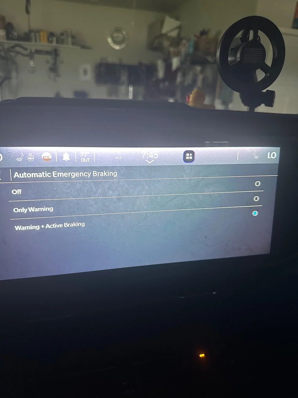

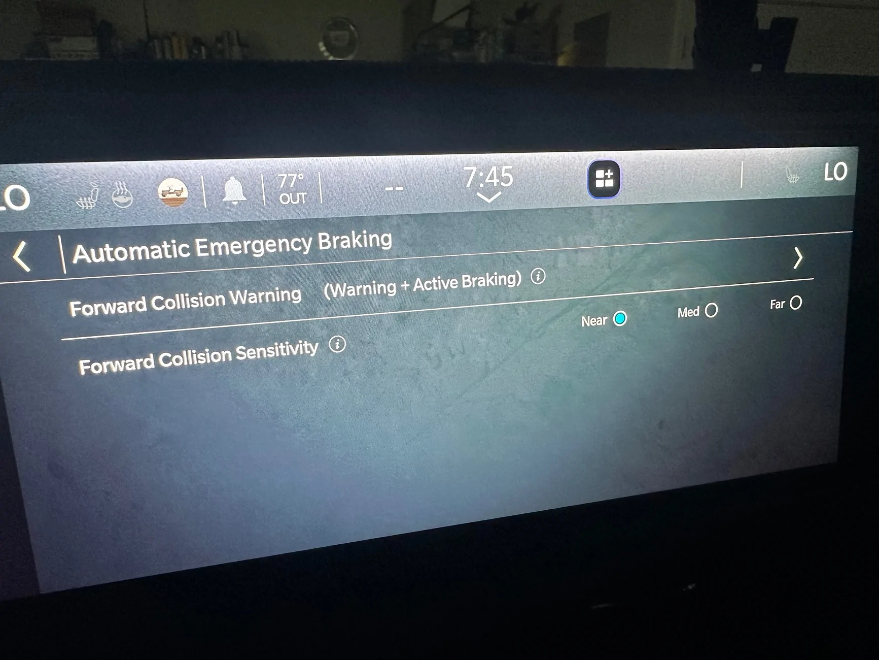

You can also adjust the distance sensitivity in Settings.

Yes I’ve done all this. Turned off and back on. Adjusted distance. Ensured all the fuses in fuse box were fully connected (more than half of which were not)
