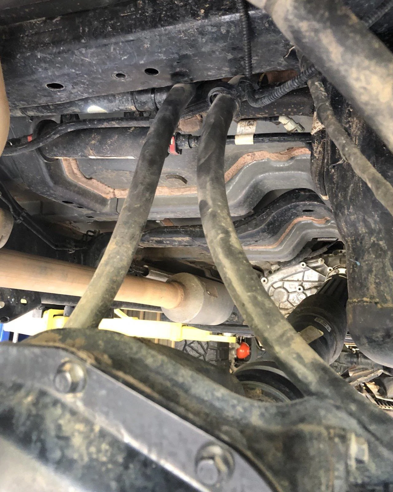

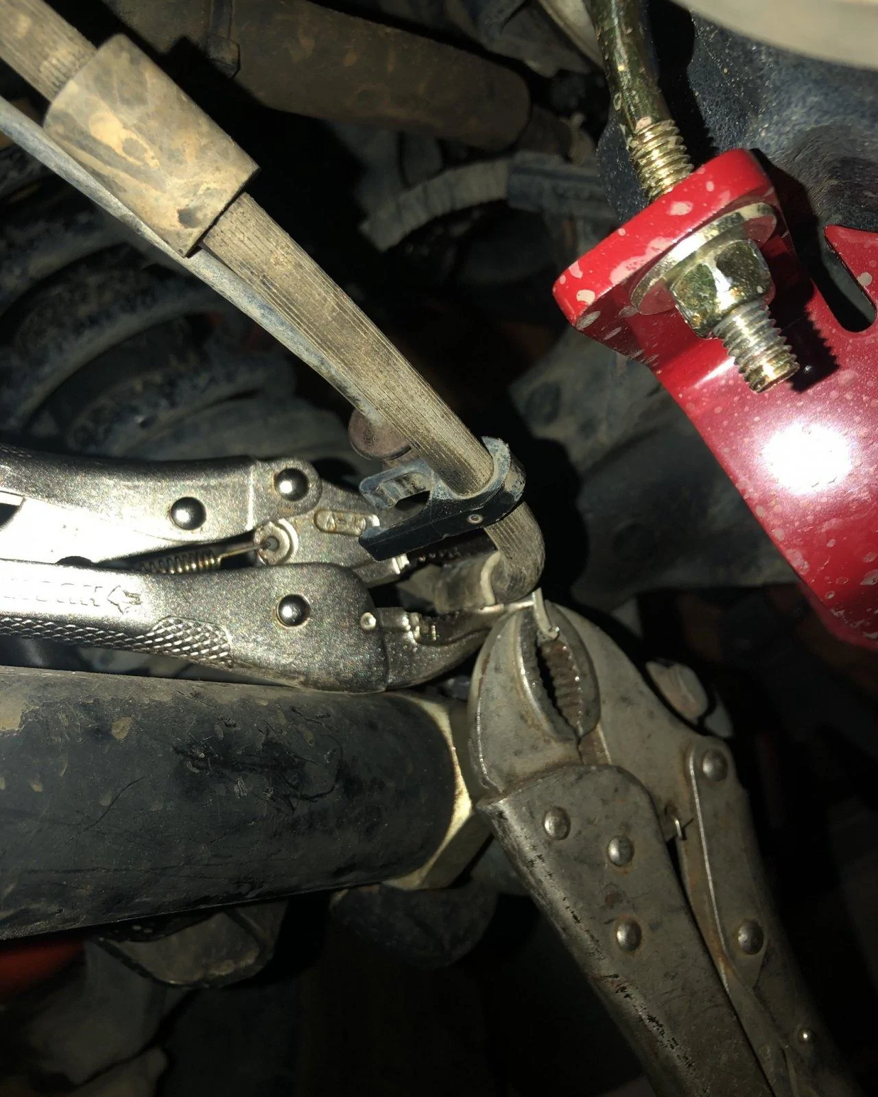

The rear e-brake lines need to route under the frame instead of over it where they are now. Take the bracket off up where they disappear into the floorboard . Pull up on the ebrake handle take a pair of vice grips and pinch the bracket the cable is attached to at the rear wheel then let brake handle down and disconnect the cable. This will keep the bracket from disappearing in rear wheel. Route the cable under the frame rail and reconnect it at the wheel, then repeat for other side. Looks like this..
Jeep Wrangler JL Florida Roll Call! E8CE69D7-5C86-4F53-BBFC-2F6D6393C774

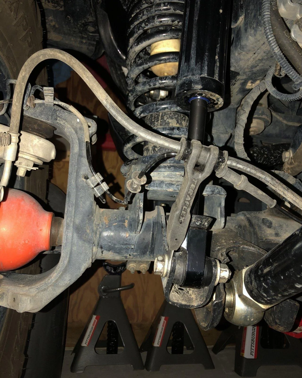

For the front brake lines I took the bracket off of spring perch and off the lower control arm. I very carefully removed them from the brake lines like this...
Jeep Wrangler JL Florida Roll Call! 7D8623FD-D1AE-4524-A007-C9BF93CE883C
Then I attached them here with a teraflex brake line bracket. A pair is about 23.00
Jeep Wrangler JL Florida Roll Call! 17BBEAB3-1F78-4539-A6A6-DF49888DB1AB

Yes the front axle. I like that teraflex clamp thingy. I'm going to look into getting that. Do they sell separately? We just put my lift in. I went with the metalcloak 3.5.
Yeah , got mine from northridge
