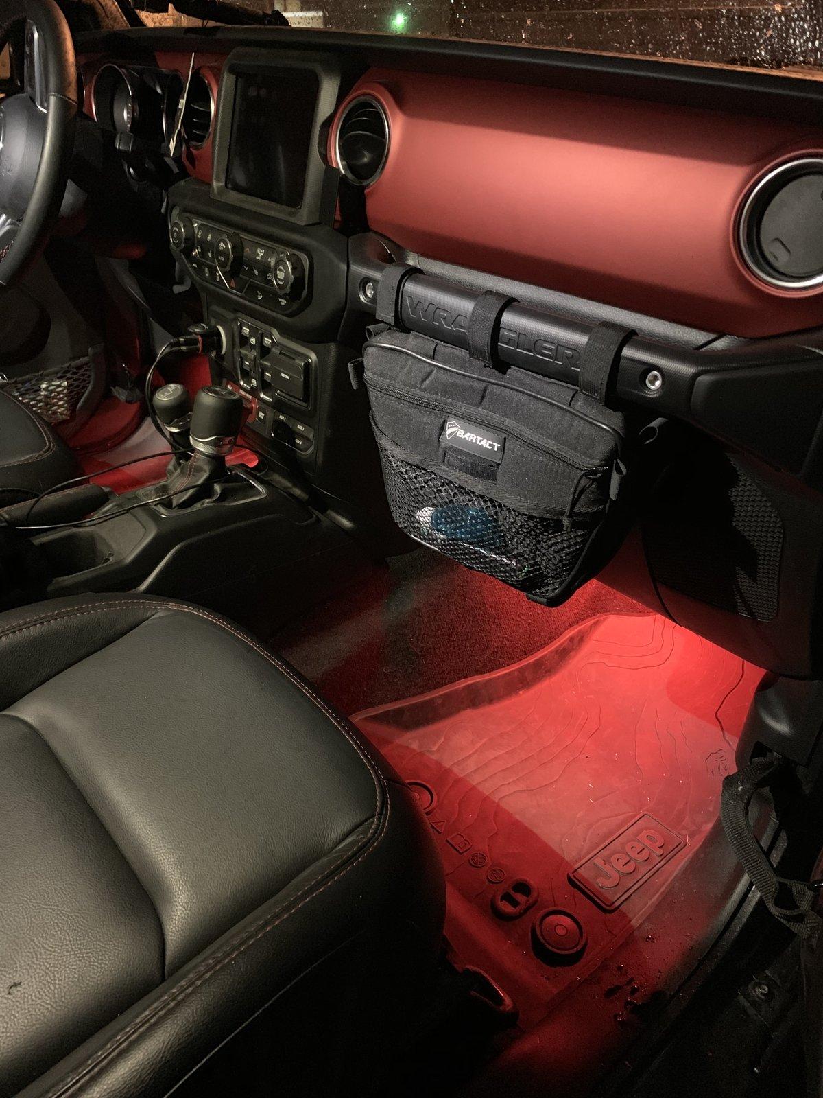

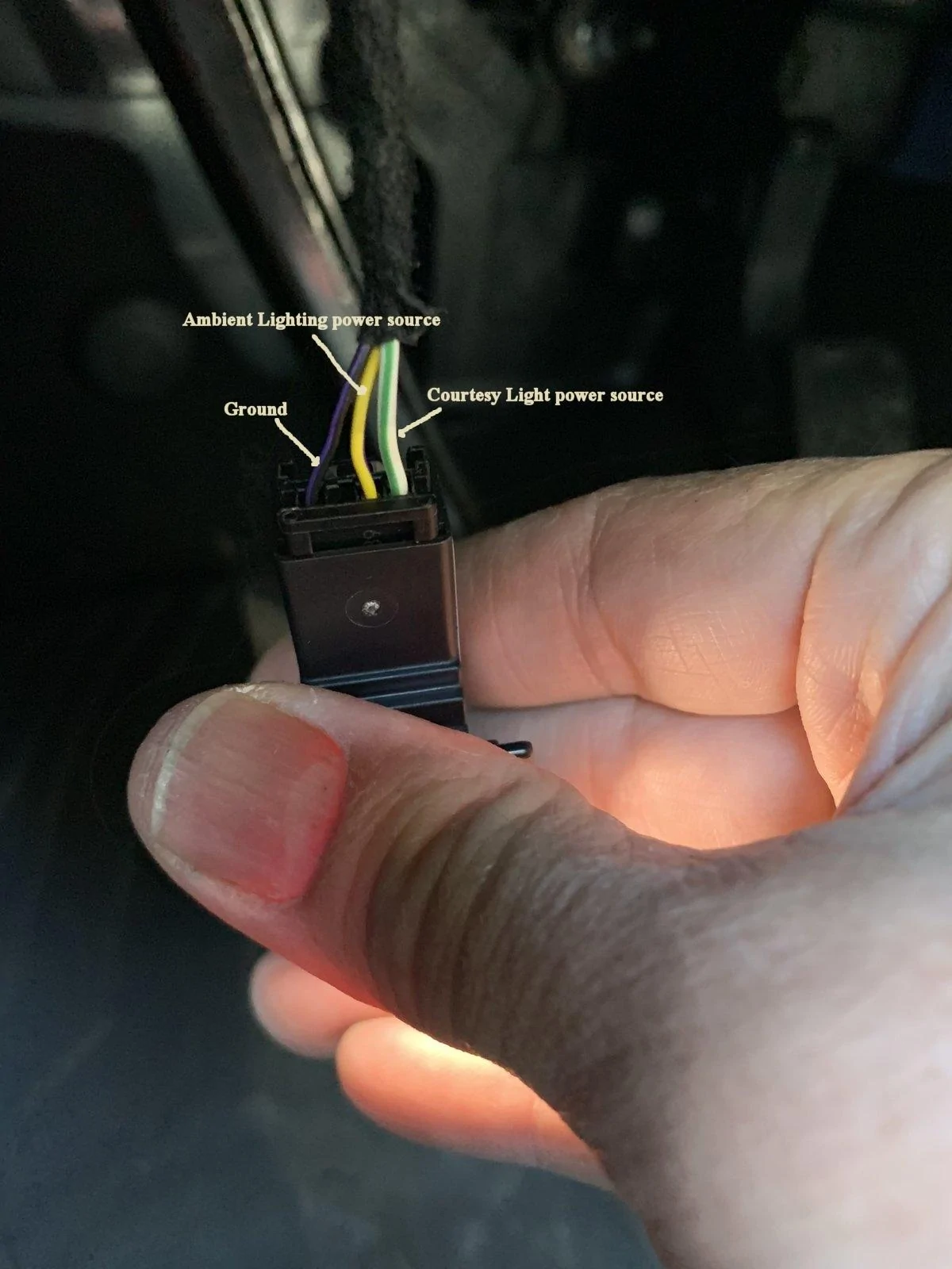

Ok, so I did put the green/ white on the red and black/ purple on black, now when I open the door light comes on but shut down after about 15sec. Which is courtesy light, ambient light does not work, so looks like the yellow is ambient, might not be possible to have both on the Kc lights, sadly I was more looking for ambient light than the courtesy, will try to reverse things this week, will hook the yellow to red, only concern is that the yellow and black that has been cut on vehicule are really tiny wires.
