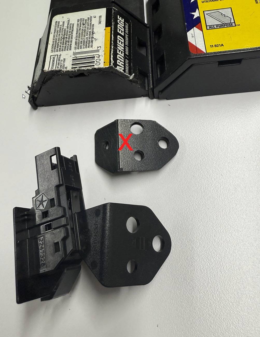

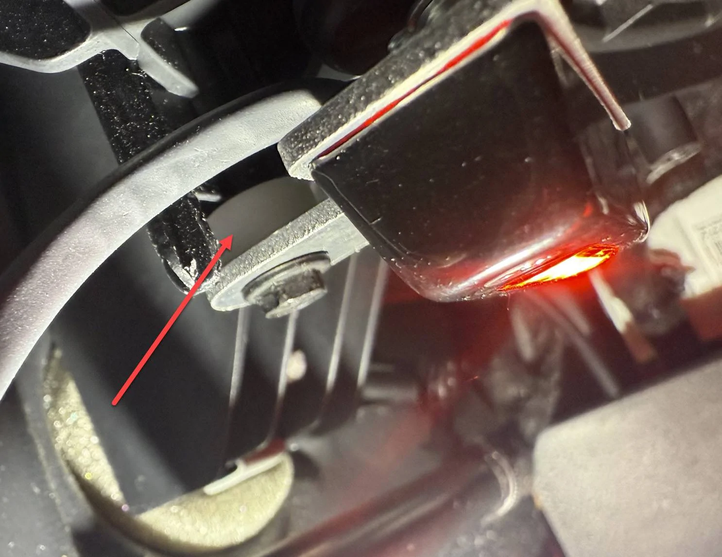

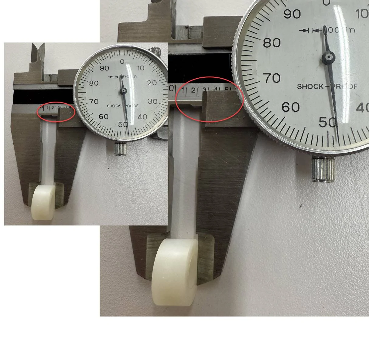

Yep I just got them! they are great. The guy (and company Dirt Road Cred) that makes them is a cool Jeep guy and fun to watch, been watching his stuff on YouTube for years. If you end up ordering these and you have a 2022 might want to pick up small nylon spacer for the passenger side. My 2021 was missing the screw that Matt shows in the video, but I found a good solution - trial and error. First, I tried to fabricate a whole new bracket (saving the stock, just in case), but it didn't point the LEDs in the correct direction. The nylon spacer / standoff worked perfect in the stock location same screw, it's plenty long enough.
This is on the passenger side only - 2021, the drive side is a no brainer just fits, and the LED orientation is perfect.
