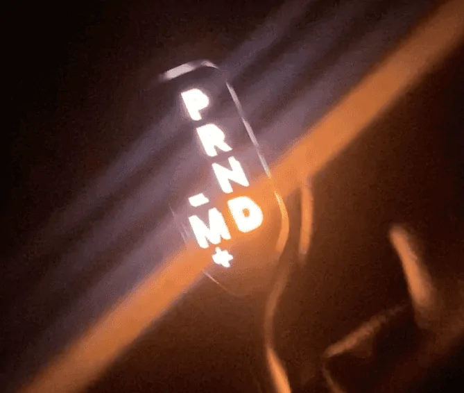

Trying to work out some glitches on my 2020 Rubicon with 2100 miles on it. Any help would be appreciated!!! It’s been to the dealership 3 times and they can’t seem to fix these 2 things. Any ideas?
1) the thermostat control doesn’t seem to work. I do have heat, but sometime the air temperature between 70-80 is cool, and sometimes it’s warm. This is always in manual, not auto. It just seems to be very inconsistent. They have replaced the head unit because they thought the problem was there. Still not fixed.
2) At night, when the dash lights dim when the headlights come on, my shifter light blinks. It’s annoying because it’s such a bright light. They replaced the shifter module, no luck. They thought it might be a bad signal coming through the head unit as well, no luck. Fuses are tight, no luck. Any ideas?

1) the air doesnt come out at the temperature you set it to. It will never work the way you think it should.
2) can you describe the blinking? is it irregular like a bad connection or a constant rate?

My 2020 JLUR started doing exactly this at about 2500 miles, now I'm at 6500 miles. Dealer replaced the shifter and it stopped the flashing. But then the light would be on at FULL brightness at night and would not dim with the other dash lights. Had to put my ball cap over it to be able to drive at night. At other times the light would not come on at all.
2 more trips back to the dealer and they twice adjusted the pin tension in a shifter wiring harness. They said the pins were not staying firmly in the plastic connector and the male/female connections on the pins were not tight enough.
Now the Jeep has been in the shop 3+ weeks. Dealer has escalated the issue to the dealer tech support team. They were checking voltages on individual wires and sending those values to the tech support team. They replaced the Steering Column Control Module and that did not fix it. Now they are replacing the Transmission Control Module. Part is on order. More to come...
