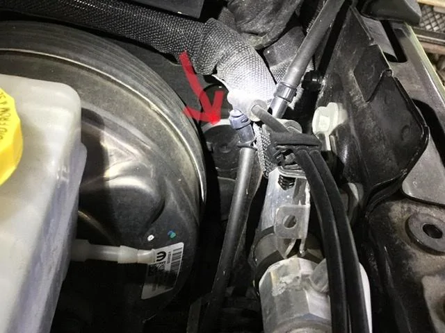

Is this the clutch pass through that is being used for wiring?

yes its a plastic plug. you can locate it from inside. under the dash. when you find it, just push it out. its pretty easy.

I tried to reach it but my arms are to big to get in there (damn Arnold Schwarzenegger muscle building DVD). Tried to get my 4 year old granddaughter to do it but she said she didn't want to get dirty. Also tried where the hose goes through below it but the grommet is tight to the hose.

Did you reuse the plug or find another gromme/ plug to pass the wiring through?

i reused the plastic plug. you can drill or cut thru the plug with a utility knife. or you can go to home cheapo or lowes and replace it with a rubber gromet. eventurally i'll replace mine with a rubber gromet.

Just used it this week for the oracle side tracker lights. As stated you can grab one of the pegs and it’ll pull right out.....or you can take a few of the inner fender well plastic rivets out(along with 3 screws) lay it down on the tire and you can look right in and see the grommet. Just reach in and go from there.
