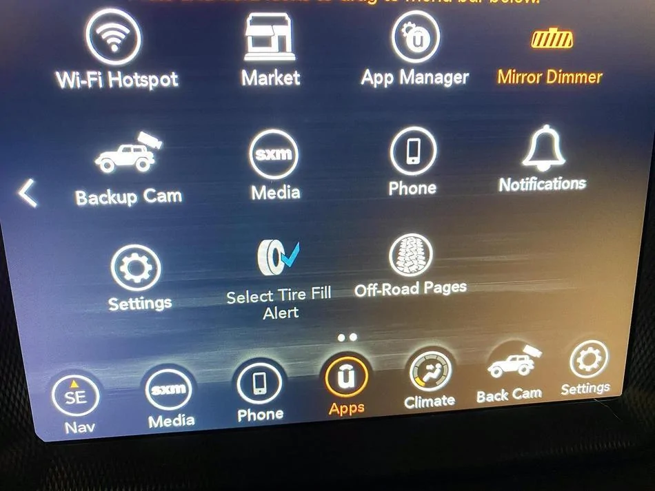

My Fiancee's 2021 JLU High Altitude has it:
Jeep Wrangler JL [Feature Request] Honk when tire pressure reached mdCleDs
Funny that hers has Off-Road Pages and the tire fill alert since there is zero chance that she'll ever air the tires down. We've never used it so I'm not sure how well it works.
