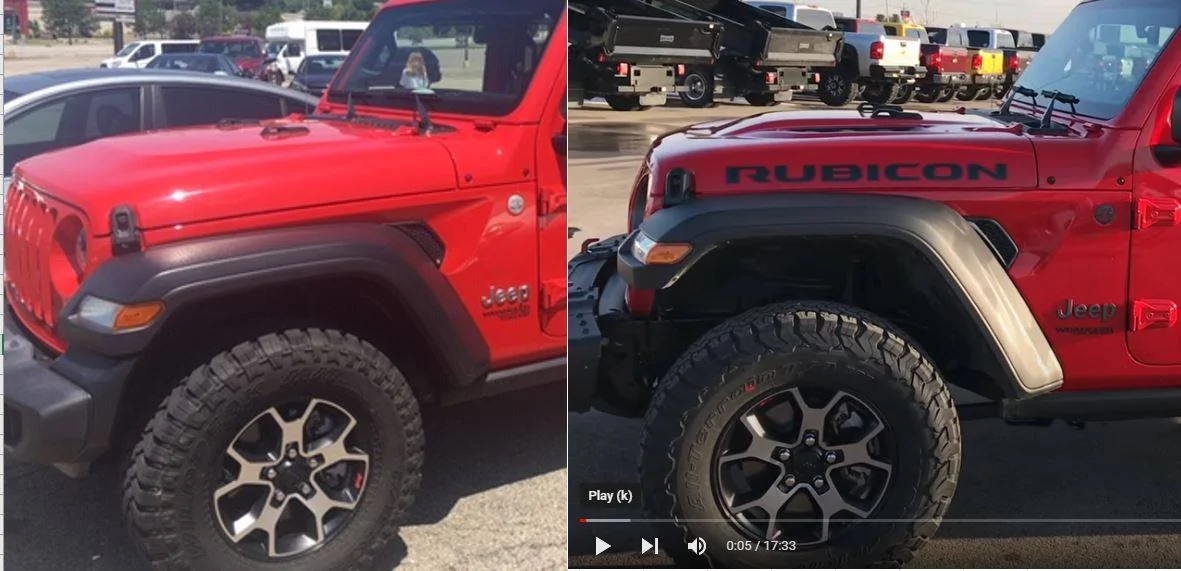

Here is a picture showing a Sport versus Rubicon fender flares.
Left = Sport model with Rubicon take-off suspension, tires and wheels
Right = stock Rubicon model
So true height should be the same as they have the "same" suspension and tires on them, with the only exception being the fender flares.
Look at the top of the fender flares compared to the hood line. On the Sport model (left) the top of the flare is around 2" below the hood line. On the Rubicon the top of the flare is even with the hood line.
Other areas include the hood latches as the Rubicon versions have indents in the flares to allow room for the latch, and also look at the black trim looking piece on the body on the back side of the flares. On the Sport the top of that trim piece is about equal to the top of the flare. On the Rubicon model the top of the flare again sits about 2" higher. Of course there is also the obvious difference in tire clearance between them (top of tire to flare).

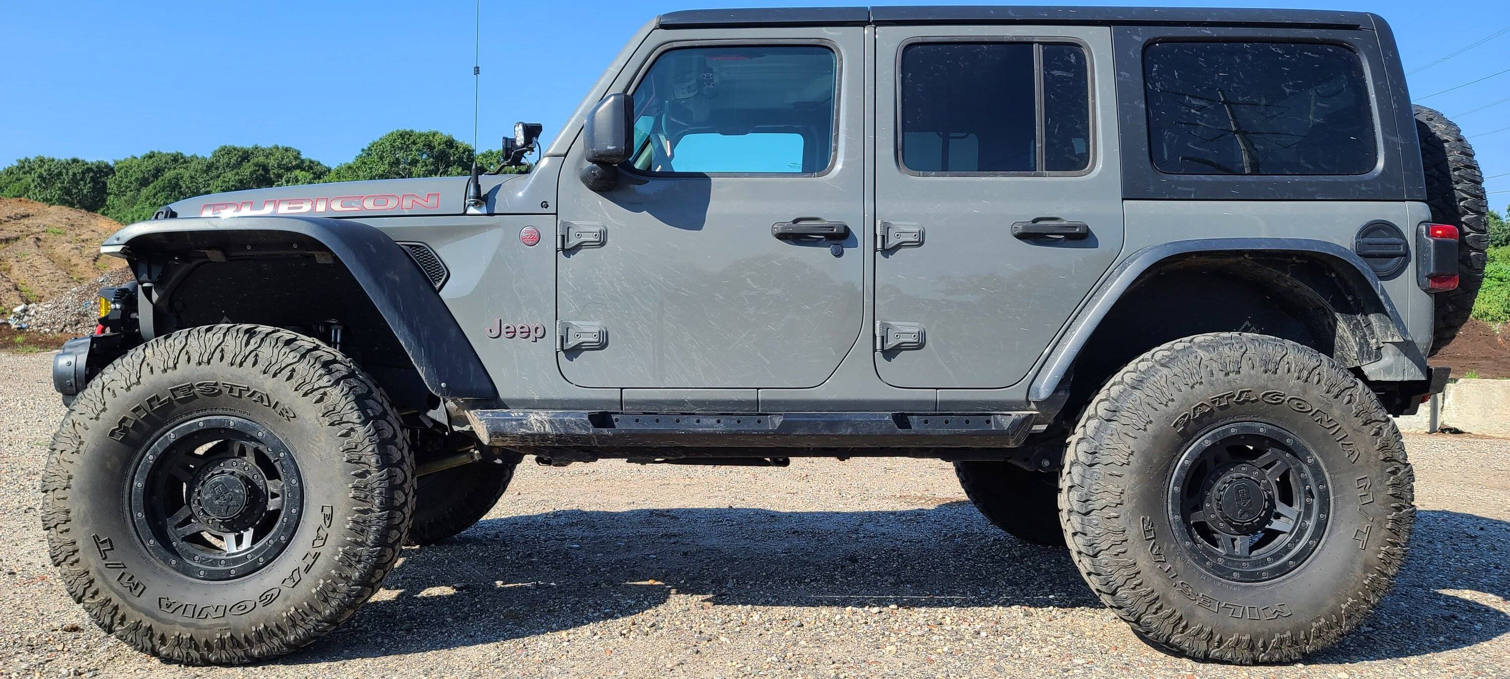

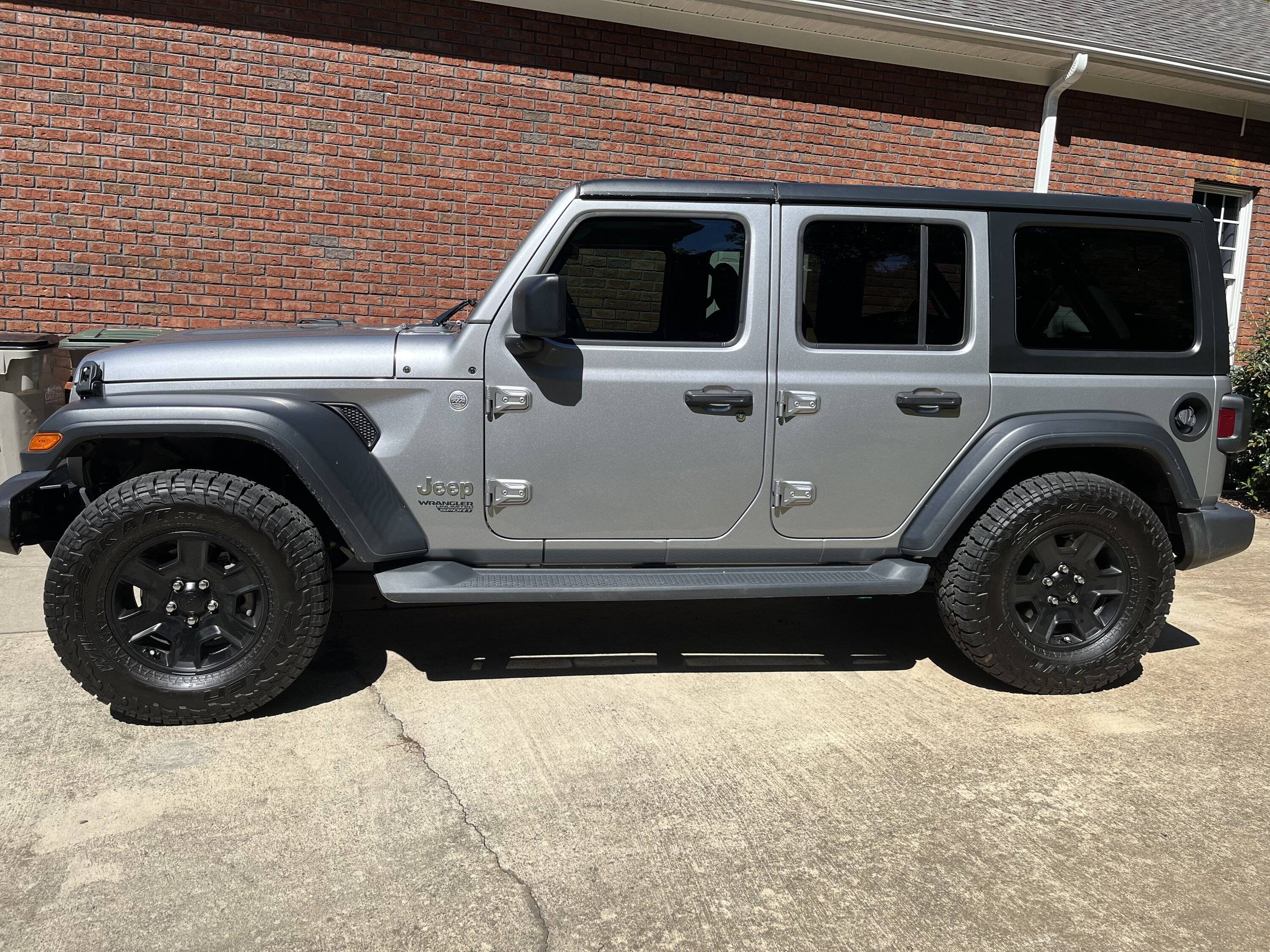

I also just learned the Rubicon fender flares are like 2” taller than Sports which would make the Rubi seem taller even if not. I need some of those….
Yes, the Rubi flare “optical” lift is real. Same suspension and tires in both pics below. Finding the right color however, not so easy!
That looks great!
This is exactly what I’m wanting to do with my Sport. Same size tires, same wheel offset and Rubi fenders.

Unfortunately, nothing special. Just a 1.5” Teraflex spacer kit, which is 2” front and 1.5” rear. For under $200, made sense for me.
