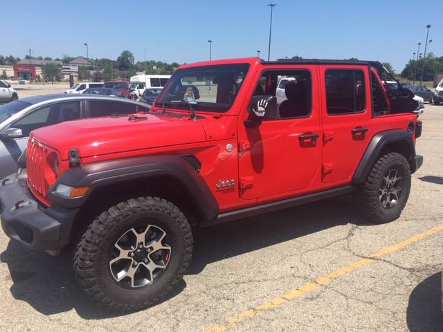

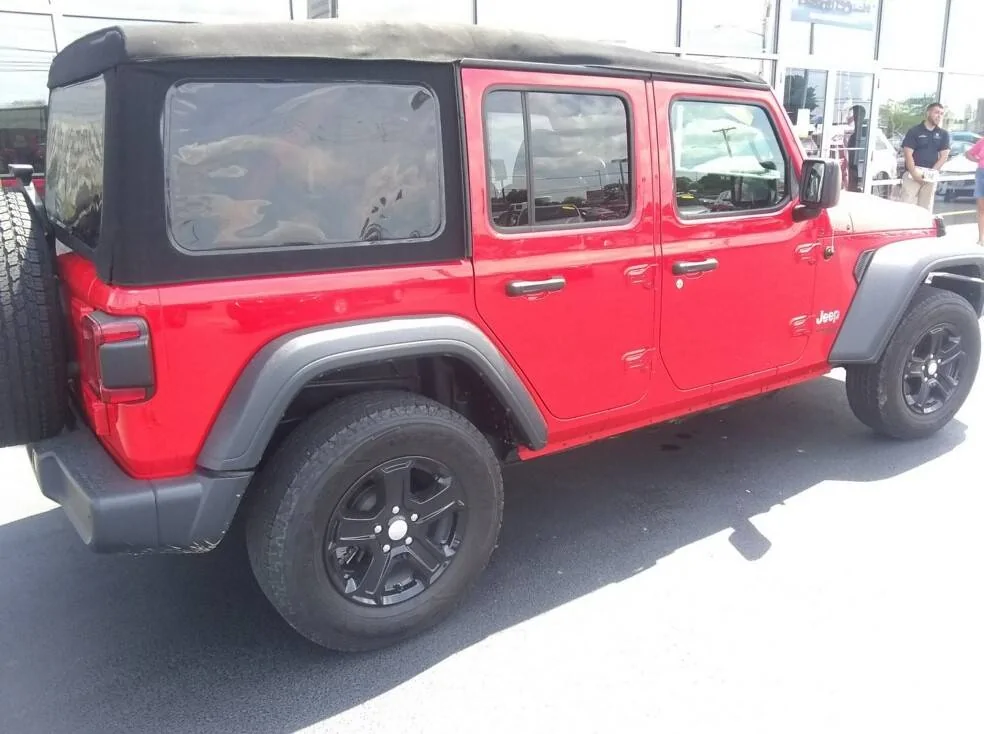

I still think that Rubicon take-offs are a decent option if you want a mild lift. I paid $200 for a complete setup and just checked the local FB marketplace and there are 2 setups for sale within 30 miles of me for under $200. The springs and shocks are the most important part....they often have factory control arms and swaybar links but they are same part. Really doubt a dealer would give you any grief if it has factory components on it. When I bought the Rubicon stuff was brand new to the JL world and wasn't aware of all the different part numbers and stuff either. I do know the JL they came off of had a hardtop but not sure of the engine or bumper situation. I do know it lifted a soft top 3.6L Sport 4 door right at the 1"-1.5" height. I think it looks good on Rubicon take off tires and wheels also. Perfect for what the owner of this JL wanted and pretty cheap. Cost $1,200 total and took me 2 hours to do the install. Would have cost more than that just to have new tires installed (they bought this JL used and it was ready for a new tires). Below is a picture stock vs. Rubicon take-offs.

No obvious change. Not a lot of seat time in this since it's not mine, but drive it a little before and after and seems about the same. The owner said they didn't notice any change in ride quality or overall handling.

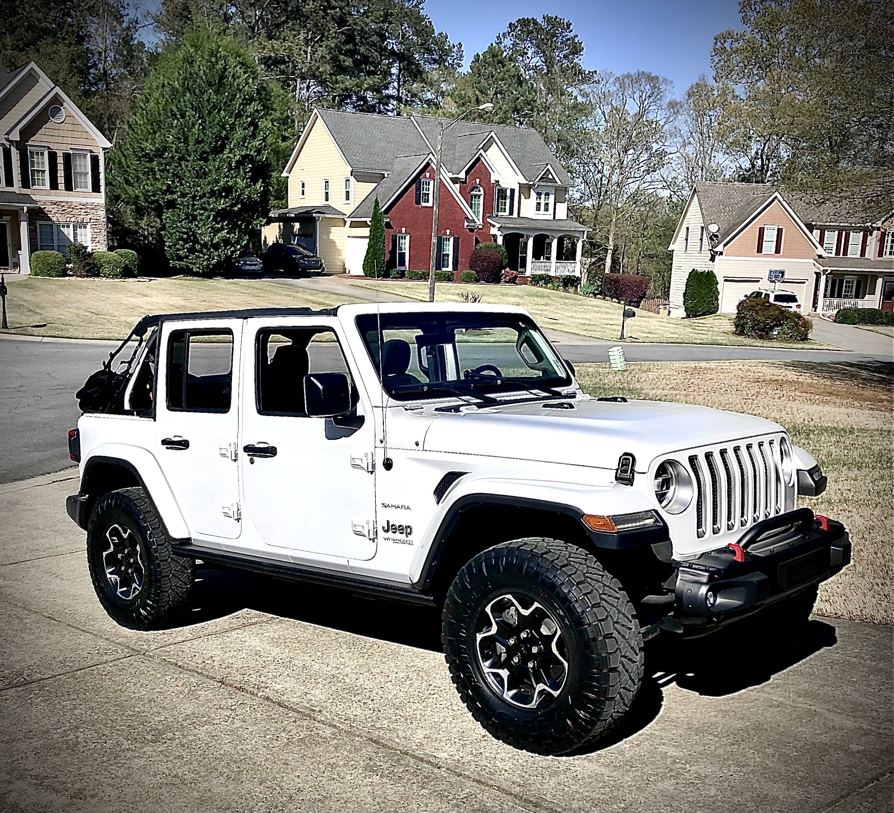

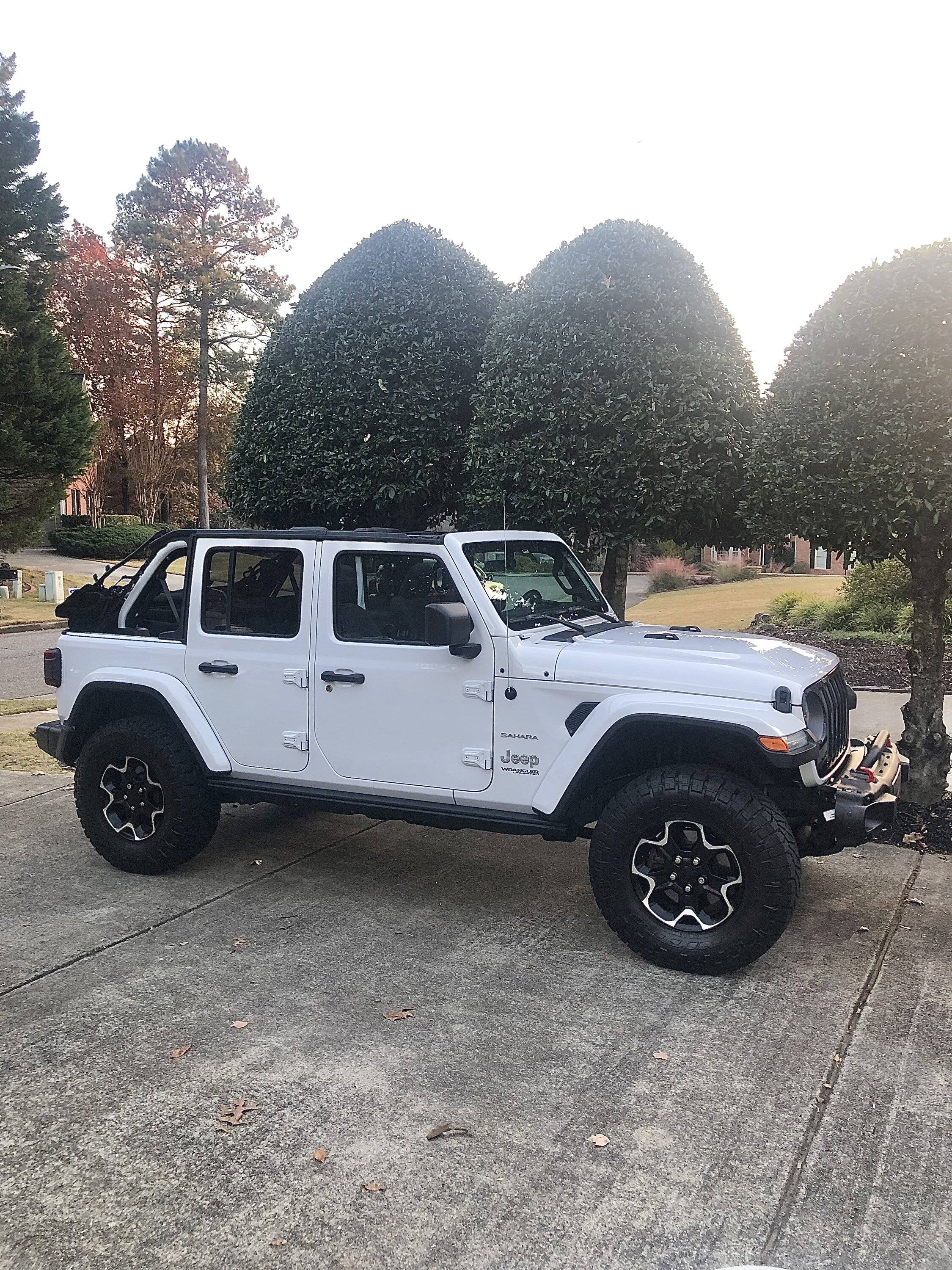

Yes, the Rubi flare “optical” lift is real. Same suspension and tires in both pics below. Finding the right color however, not so easy!

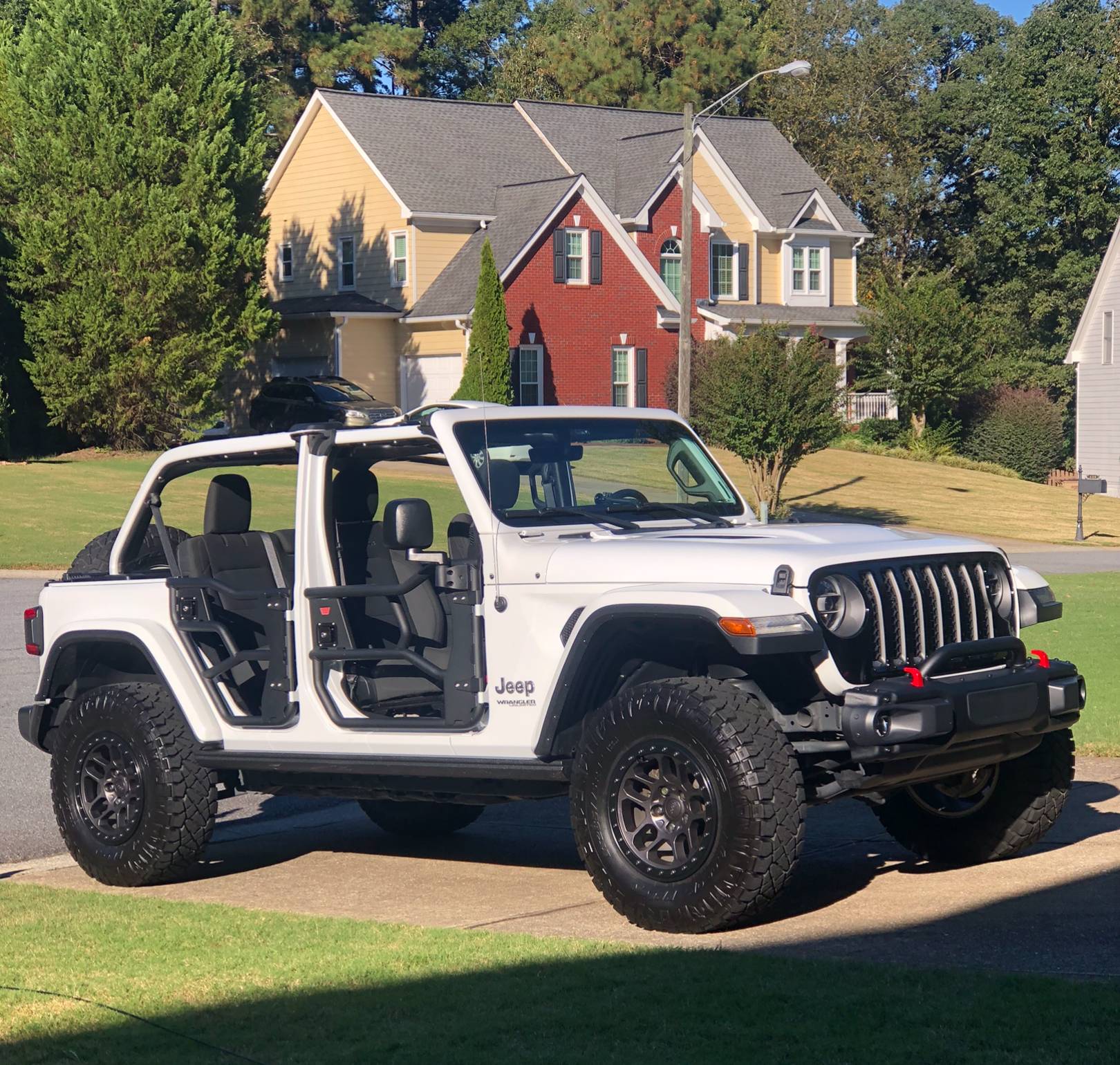

Are the rears the same or also taller?

Yes, the rears are wider, taller, and longer. I actually ran the Rubi fronts and Sahara rears while I was waiting for my close out panels to come in. It wasn’t terribly noticeable to the casual observer (i.e., the wife). . .

I kinda like it! Baja feel like the front is raised
