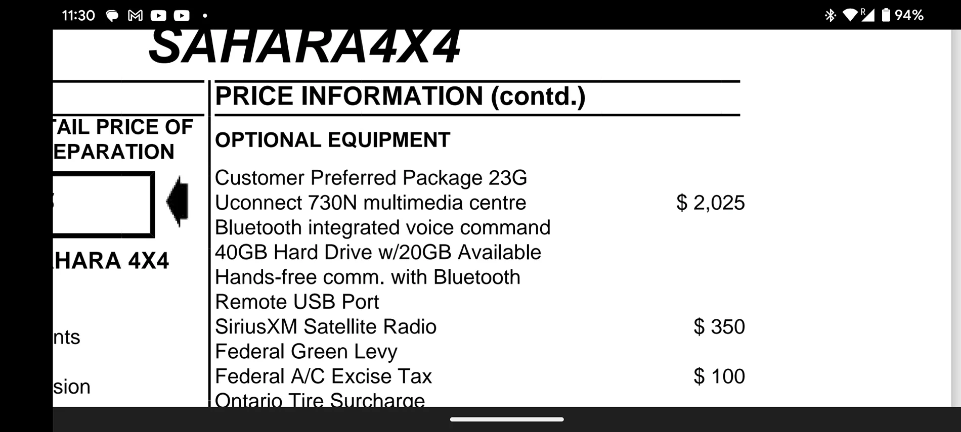

I would spend a bit of money to get a decent system installed, when I had the 2015 JK it was just the base system, I changed speakers etc to the tune of hundreds of dollars, it still didn't sound great, somewhat better, but the base system was utter garbage, so anything would have been an improvement.
I noticed the difference, it was stark, my 2007 had the Alpine, so when I put on the radio in the 2015 on delivery, it was 💩, the reason I went to the 2015 was for the 4 door, a new born was on the way, that is another reason I didn't spend money on a proper system, I mostly listened to the radio for 3 years, then dumped it for a JL with the Alpine.
I saw the $2K radio option and stupidly assumed it had the premium audio. Now I specifically look for Alpine in the options.
