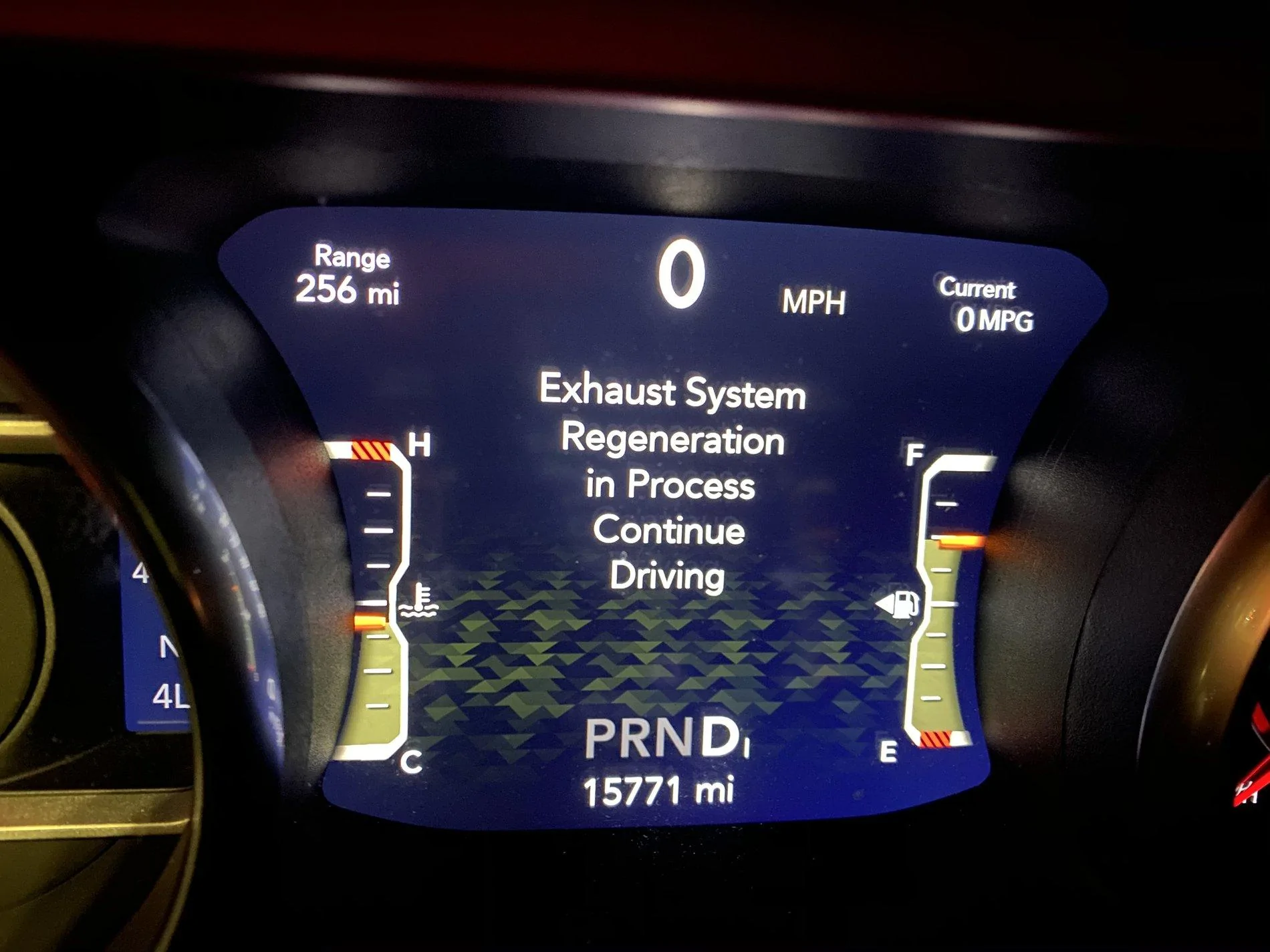

With the proper spec oil, I'm hoping I don't see the Regen Message again. At Least for a long time.
Bryan, with 16K miles, I suspect that you've had 10-20 regens by now. [maybe not if you drive exclusively on the highway]. My JLURD is only a month old and I've had 4 so far, but no messages have flashed on the dash. Most happen unobtrusively in the background. Even with a scan gauge, I've only noticed one actually in process.
