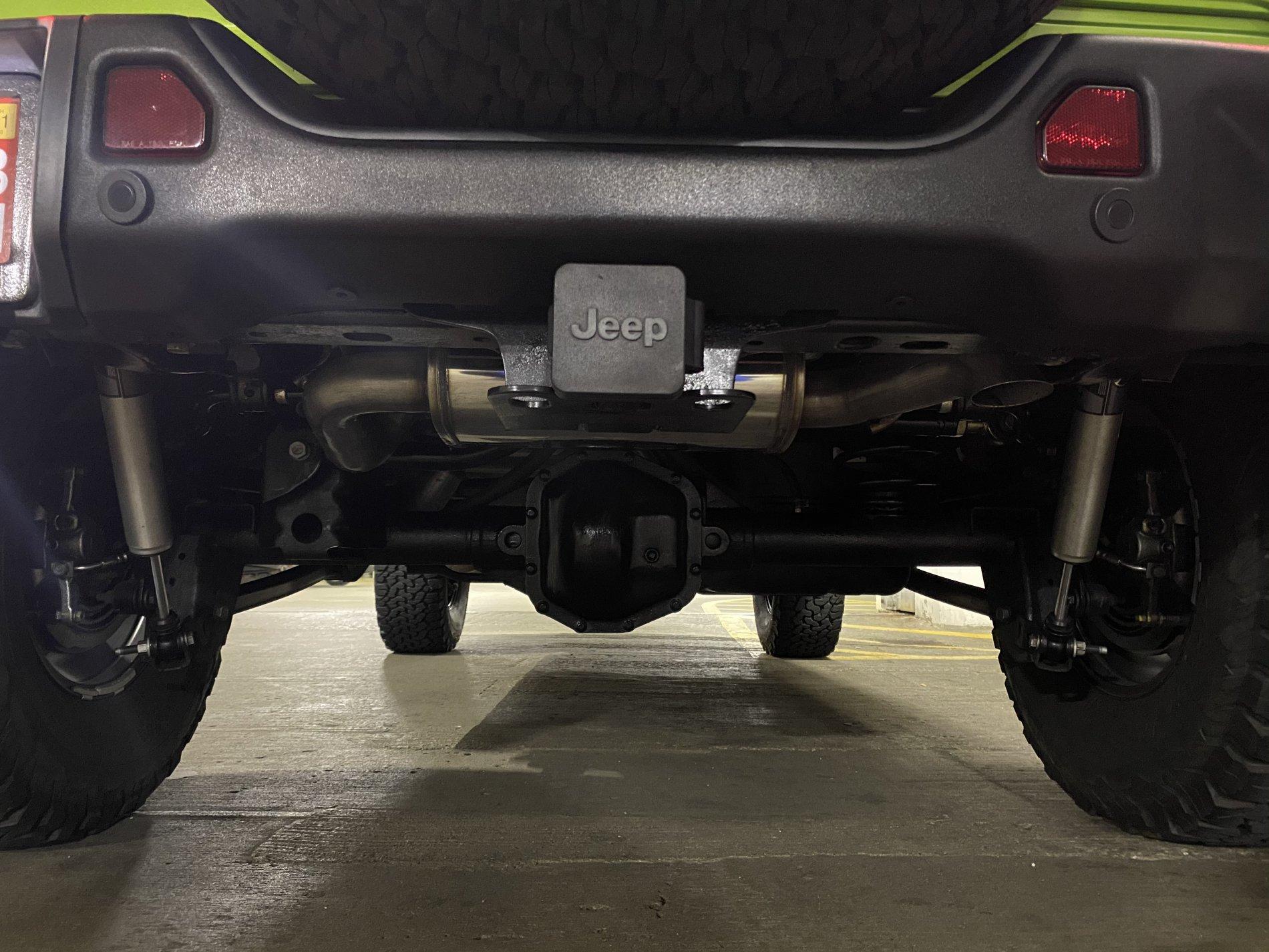

Jeep Wrangler JL Exhaust recommendations? 06C51429-5195-4962-94B8-00ABF2706BE4

Thanks, for the replies. I found the solution, for me. Much easier to just go to a custom exhaust place and have one built. Two door or four door, doesn't matter -- and they can fit a bunch of different cans so you can hear the difference on your own Jeep as you stand there. Mine came out perfect, took less than two hours to get done, and it's welded, which feels safer, particularly since I'll be installing a belly pan which might help trap any leaking exhaust gasses. In the end you can end up with whatever size Borla, Flow, Flowmaster -- or whatever -- you want to install, and the out the door price is about the same. My "out the door" price was $400.
