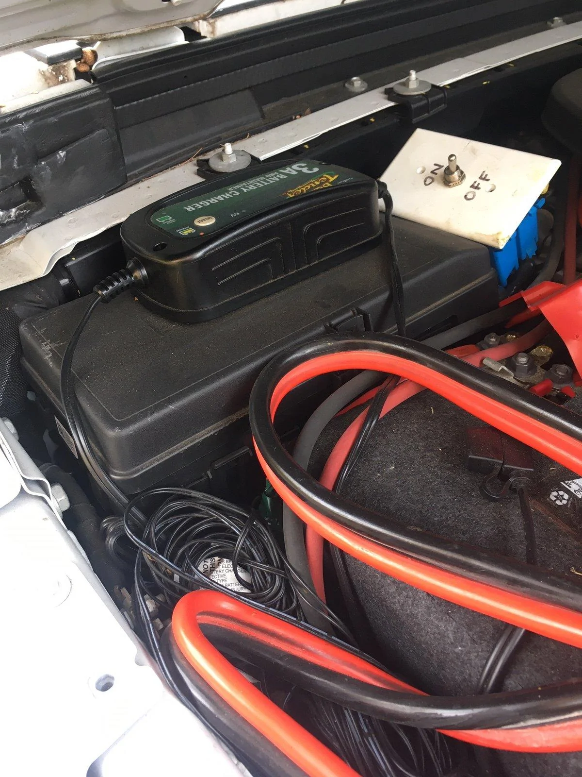

Next, a picture of my trickle charger:
Jeep Wrangler JL ESS "Not Ready Battery Charging" question. IMG_3216
I have it sitting on top of the PDC (power distribution center) cover with mounting tape. Notice the on and off switch to the right. Not specific to this thread it is Jerry's hack of above connected to and on and off switch.
(The thick red and black cable shown is not relevant. https://www.polepalsolarlightingsystem.com/catalog/cat-100013/Power-ConnectorsTransfers#.XcnDLXdFy1s It flows to the front of the rig to facilitate jumping others or being jumped. Its "Anderson" plug is in the middle left of the last picture, or an example of which also appears in the bottom of the second picture It connects to a cable with the matching plug at one end and alligator clips on the other I keep in the back of my rig.)
If you were to open the cover to the PDC upon which my trickle charge sits, within the exposed box, on the side closest to driver's side, in a line from front to back of the vehicle you will see the high order fuses of the PDC, numbered sequentially from front of rig to back.

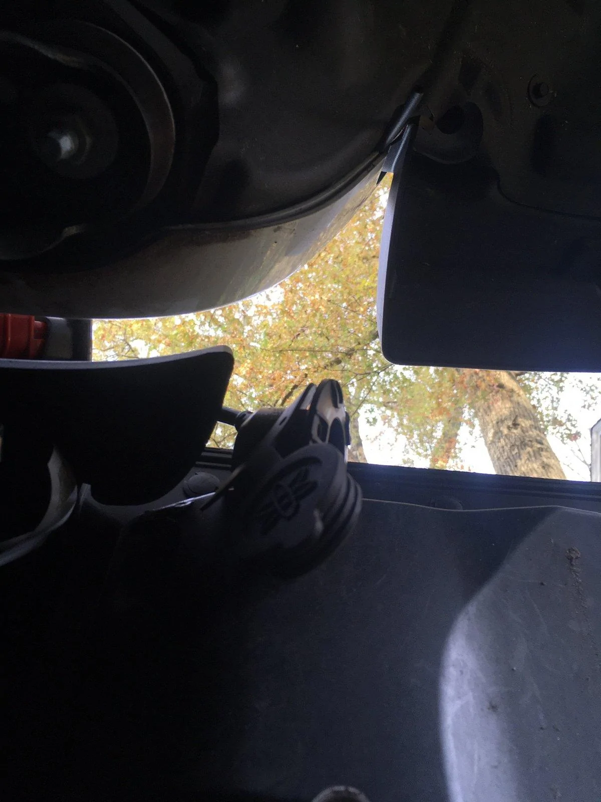

I've run the trickle charger's AC plug to a place just forward of the main battery and behind the air filter. It plugs into an AC extension cord which drops to a point by the most forward body cross member below.

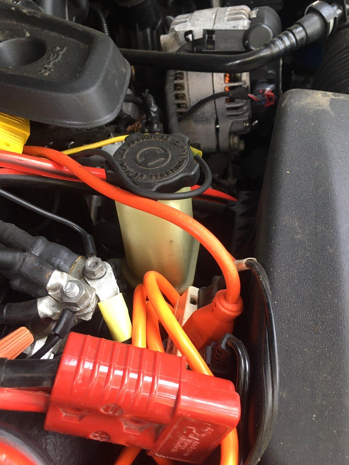

Finally, this extension cords male end connects to the short Amazon cord referenced above in this thread and comes up just behind the bumper and around on the passenger's side. This picture is taken with me on my back just forward of the passenger's front tire. It's this end that has a male 3 prong AC plug to attach to your shore cable.
