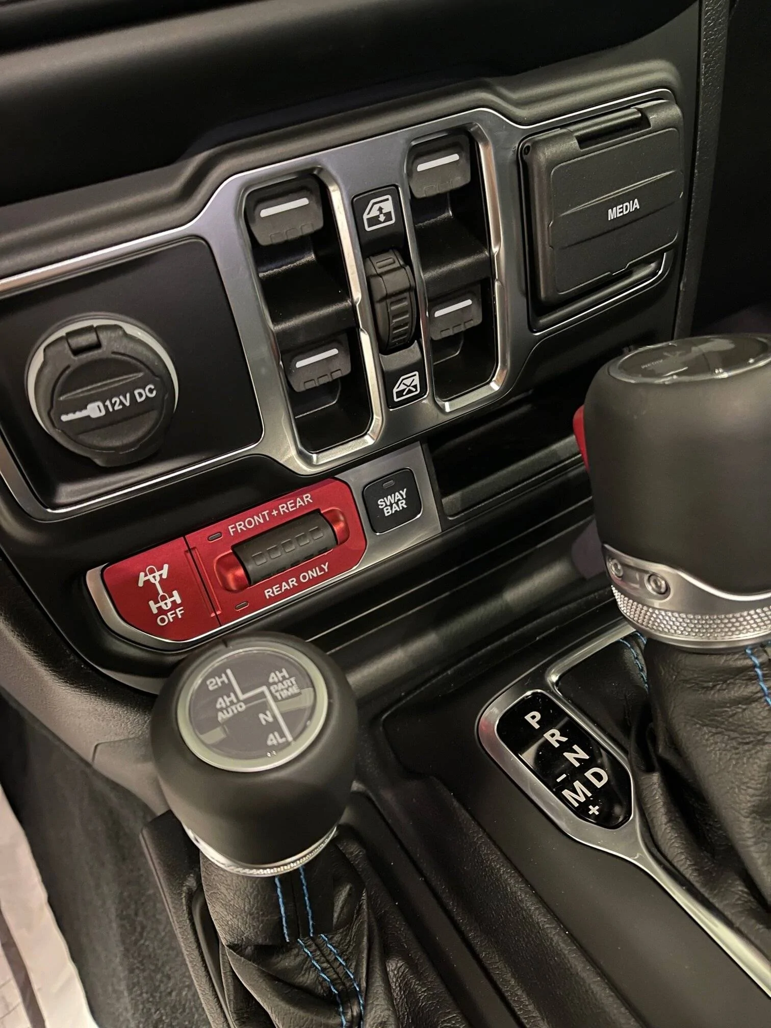

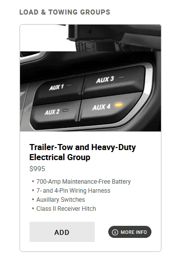

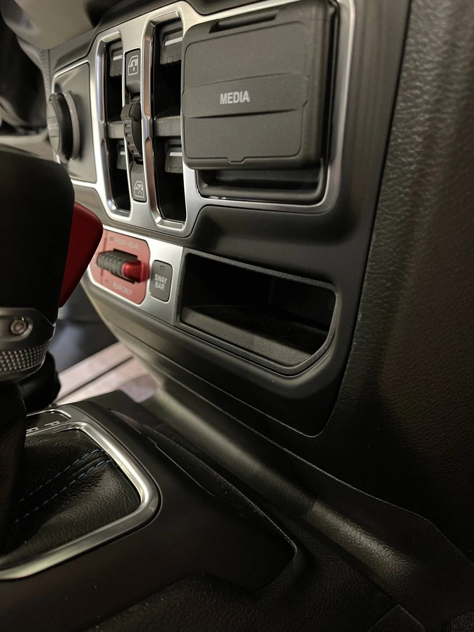

Hello, i just realized that i miserably failed.. forgot to order the AUX/Tow package on my build and car just got here. I think i missed it during rush order process as I saw TOW and figured i can get that later but missed AUX part which i was really looking forward to and was under impression entire time that it was part of my order!
I wanted to see if anyone knows if the car has the 7 and 4 pin harnes where one can buy OEM AUX switch panel and install it, and upgrade to 700 amp battery.. reason i ask some MFR's include the wiring in there anyway in event upgrades are done later but perhaps its not there.. if its not there i wonder if that harness could be added or better to just go aftermarket like RC MCL-6 or equivalent? I was really hoping for clean factory AUX switchbox.. darn it soo upset!

If you shop around you can purchase the mopar aux switch kit for a decent price. Comes with everything you need. I’m on my second JL and didn’t have the tow package as a factory option in either.
I went with an S-Tech systems kit in my first JL and it was a great kit. Fairly straightforward install and had switch options specifically designed for the JL.
However, I went with the factory kit the second time around. The ability to configure the switches as momentary/latching and ignition/battery on the fly is a cool perk. The factory system also gives you a more direct tie into the JL’s on board battery management tech. The trade off is that the factory kit is a tad more involved to install. But over all it’s not too bad if you have some experience de-pining and reassembling electrical connectors.
I think I got the Mopar kit from Northridge. If you go the mopar route be sure to by the kit that matches your specific interior trim. They come in black and chrome.
Edit: Your build may have a few parts and pieces of the harness for this already on board, but it’s likely incomplete and not fully tied in. To my knowledge you’ll still need the full mopar kit. I wouldn’t think anything specifically about the 4Xe application would change this- but I could be wrong. Disregard everything above if someone has experience that suggests otherwise.

The trailer group also gets you a bigger battery and a bigger alternator. Towing Suspension is also heavier duty (stiffer).
I didnt get it either an tow with my Jeep. The Mopar 7pin harness is something you can add "later" technically. It is a very time consuming job. I did it on my driveway and it took me about 6hrs or more.
For $1000 the oem tow package is a good deal.
