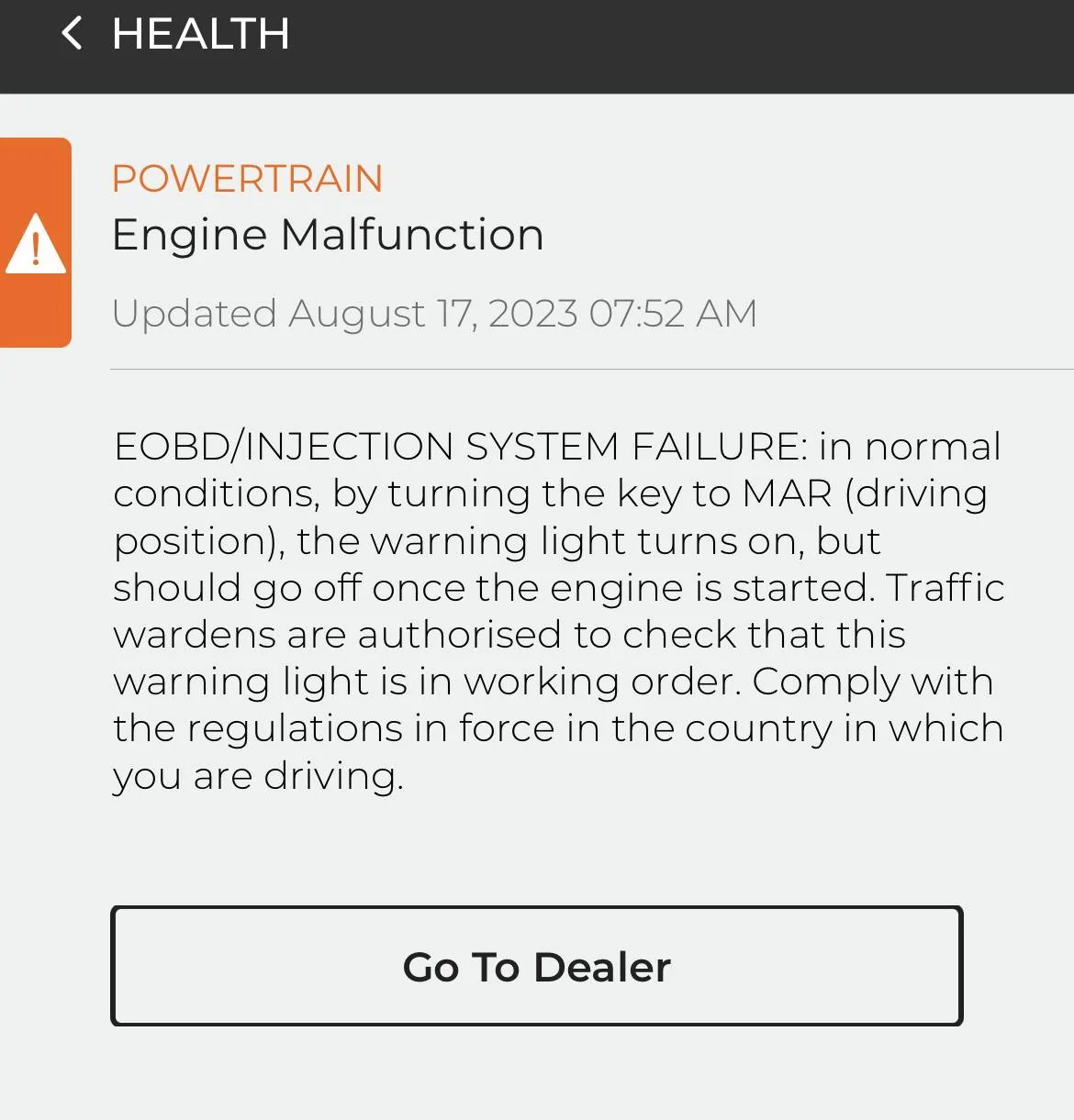

I have a brand new Sport S 4xe. I’ve had a couple mornings where I get the EOBD/Injection System error. The vehicle drives fine and there’s no light on while driving or starting up. It only seems to do it when it’s in the scheduled climate time before I leave to take my daughter to school. By the time I’m at work the next vehicle history report is completely normal. Anyone else with this issue/non-issue? I’ve seen others have it but the warning light lasted longer. I’m not worried since it’s only during these very specific times.

Drew, I'm baffled by a couple different things.
Injection System? WTF that's for Diesel engine aftertreatment. I googled and it seems you're not the only 4xe to experience it - and others have found this happens with 12V battery problems. It's one of the crazy things that happens with low voltage, and a reminder that the same modules and software are used across different FCA models (RAM trucks have this error message). So check your battery connections, or have your dealer test your battery.
Also, what is scheduled climate time?

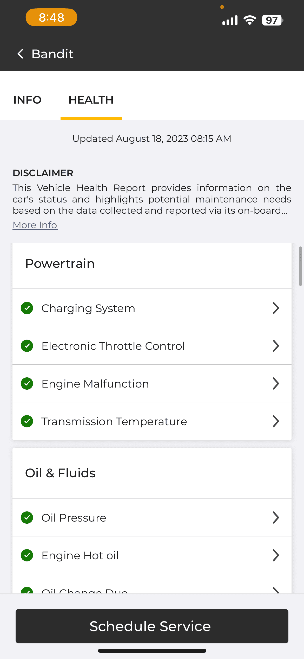

And what do you mean by vehicle history report being normal? Do you mean the Vehicle Health Report from Uconnect? I've actually never seen anything amiss in that so I'm curious!

This is the error I get in the Jeep app.

Here’s what it looks like now

Haha that's a funny message - traffic wardens are authorised? Lol even British spelling.
