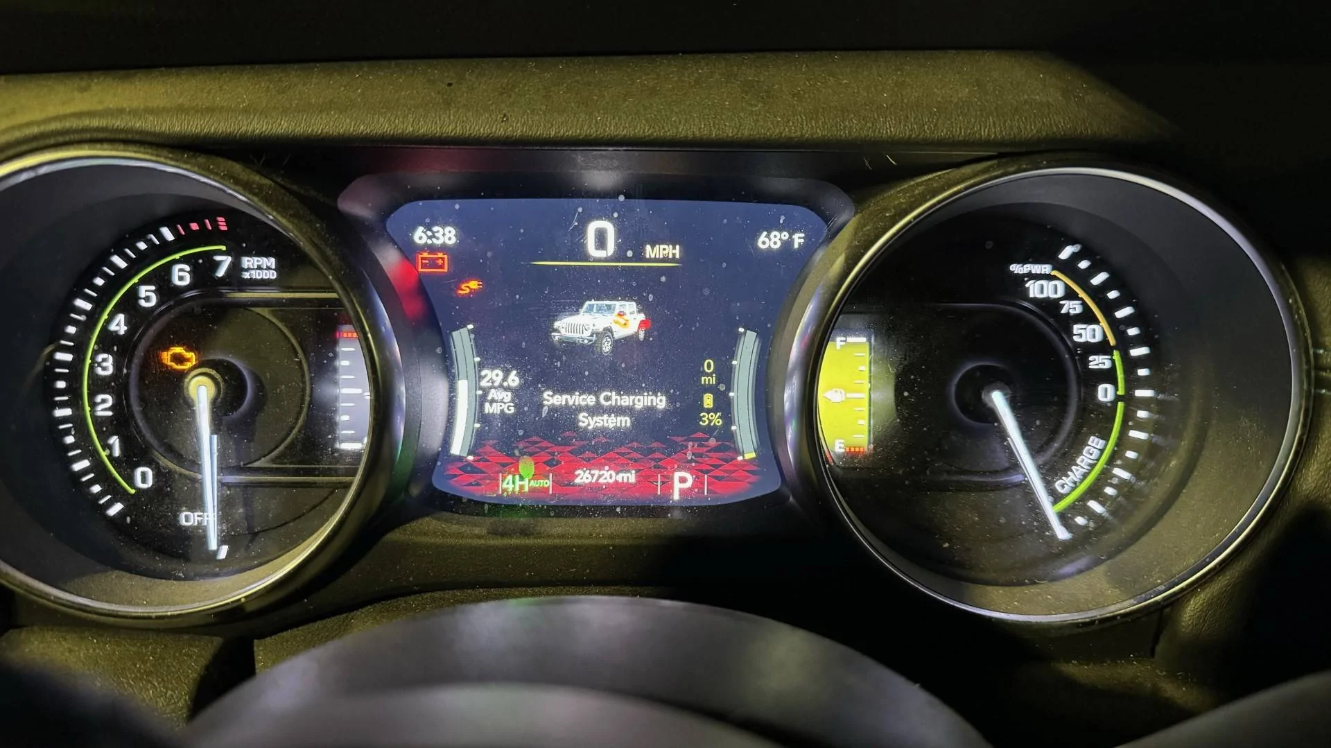

I got back and tried to start the car. Power came on (e.g. lights worked, radio worked, etc), but car wouldn't start at all. A bit red error saying "Service Charging System" came on. Car wouldn't start. Couldn't even shift out of park.

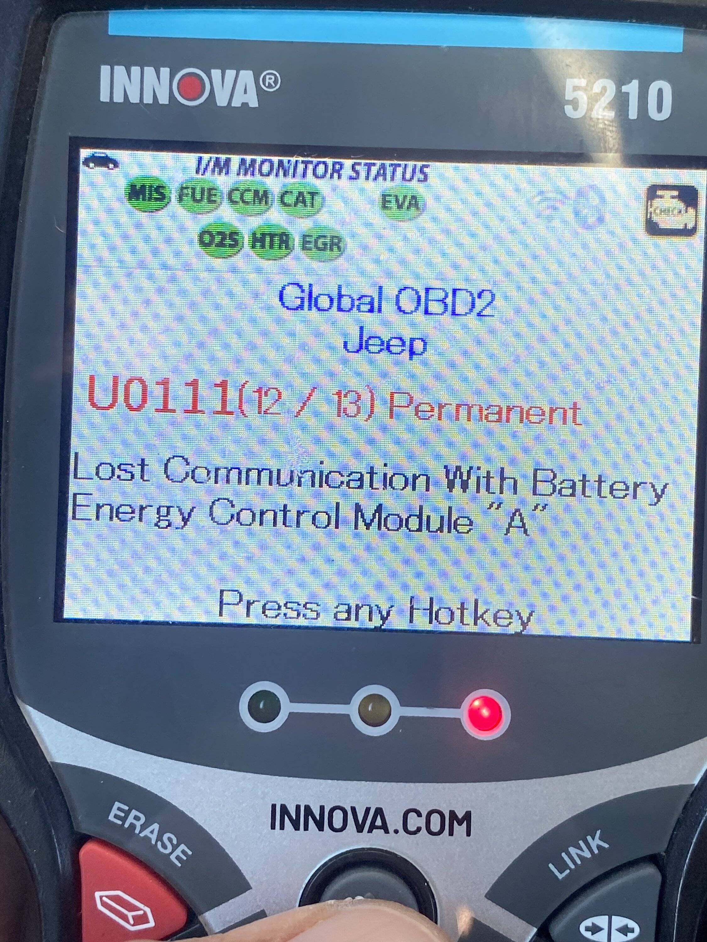

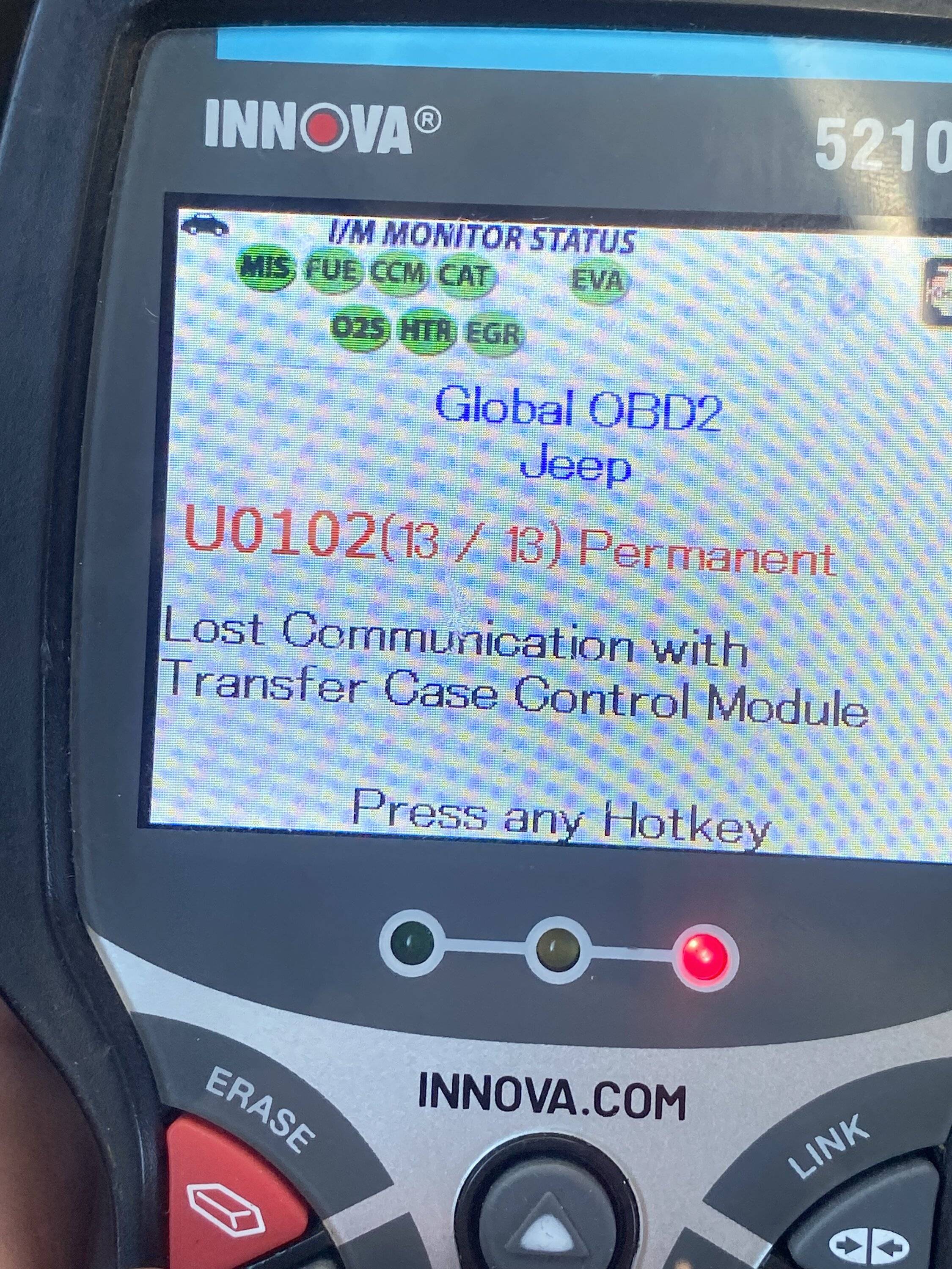

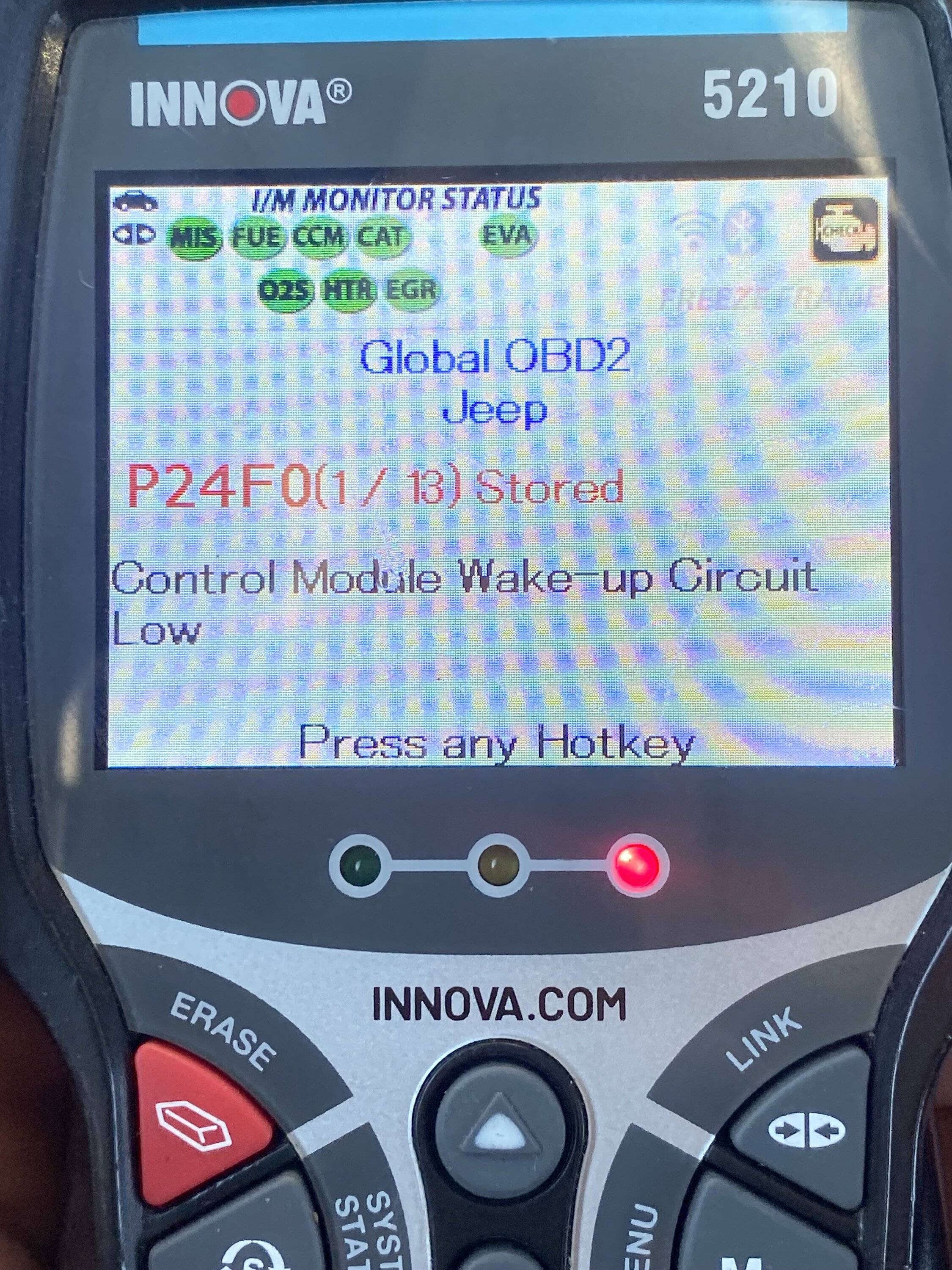

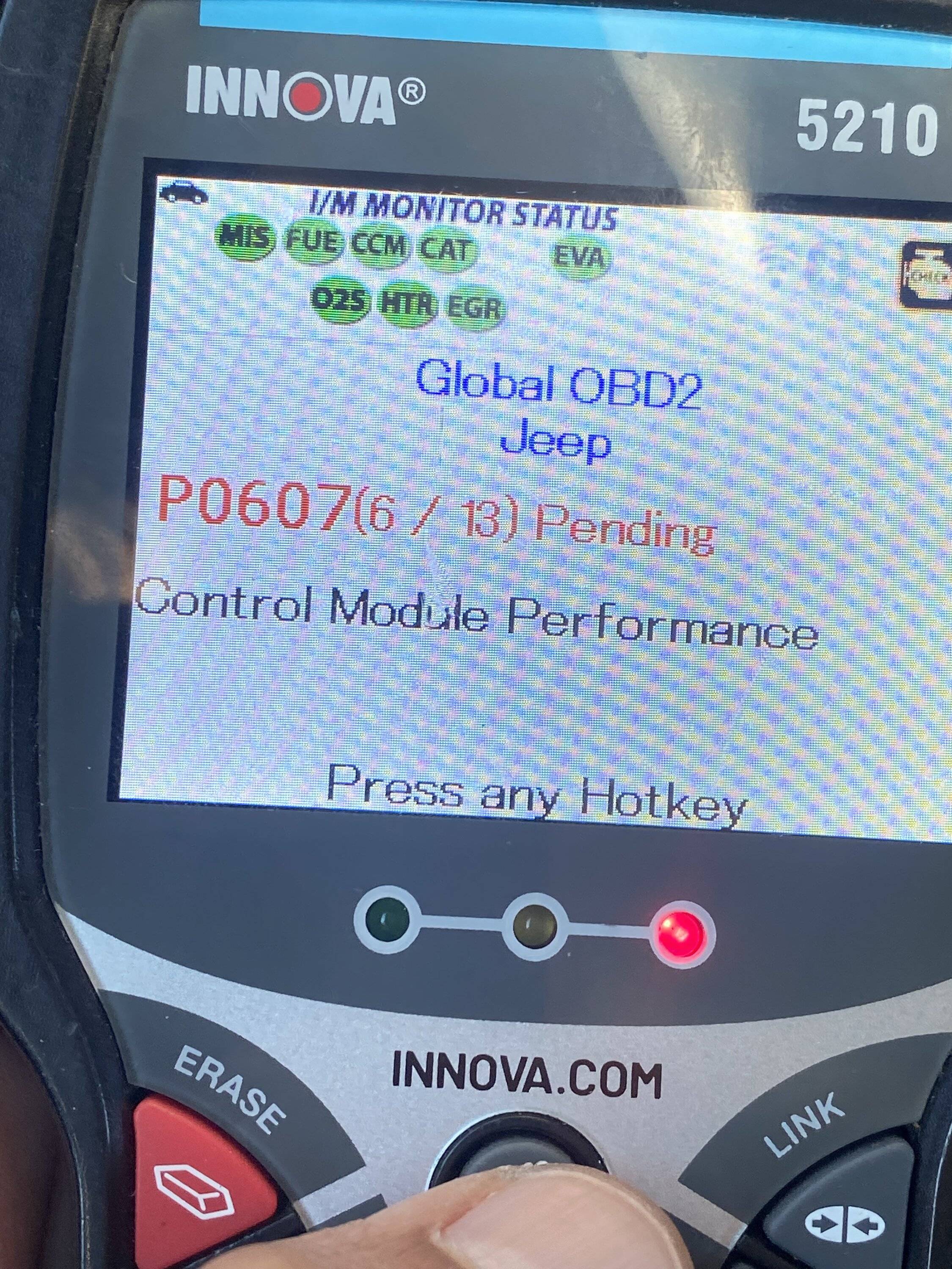

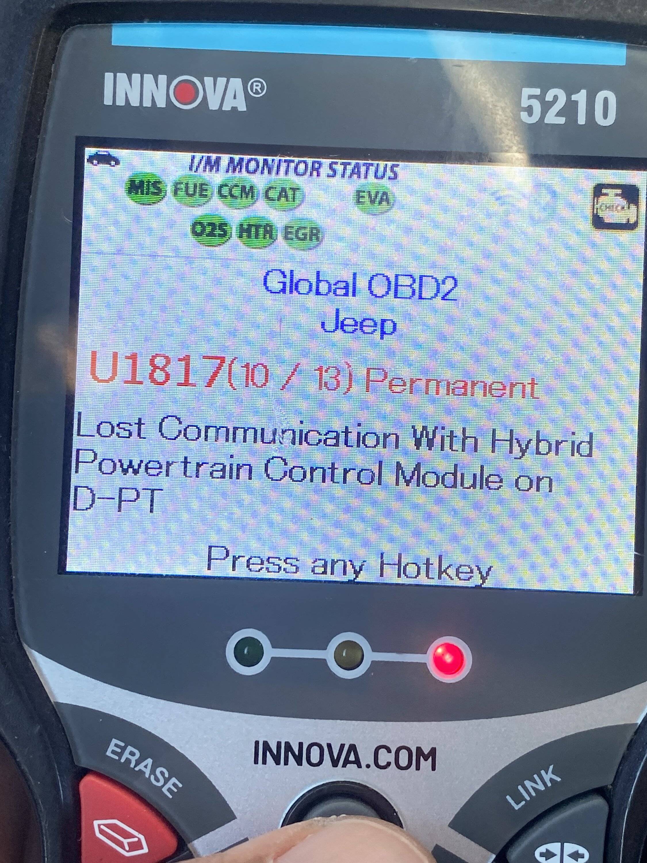

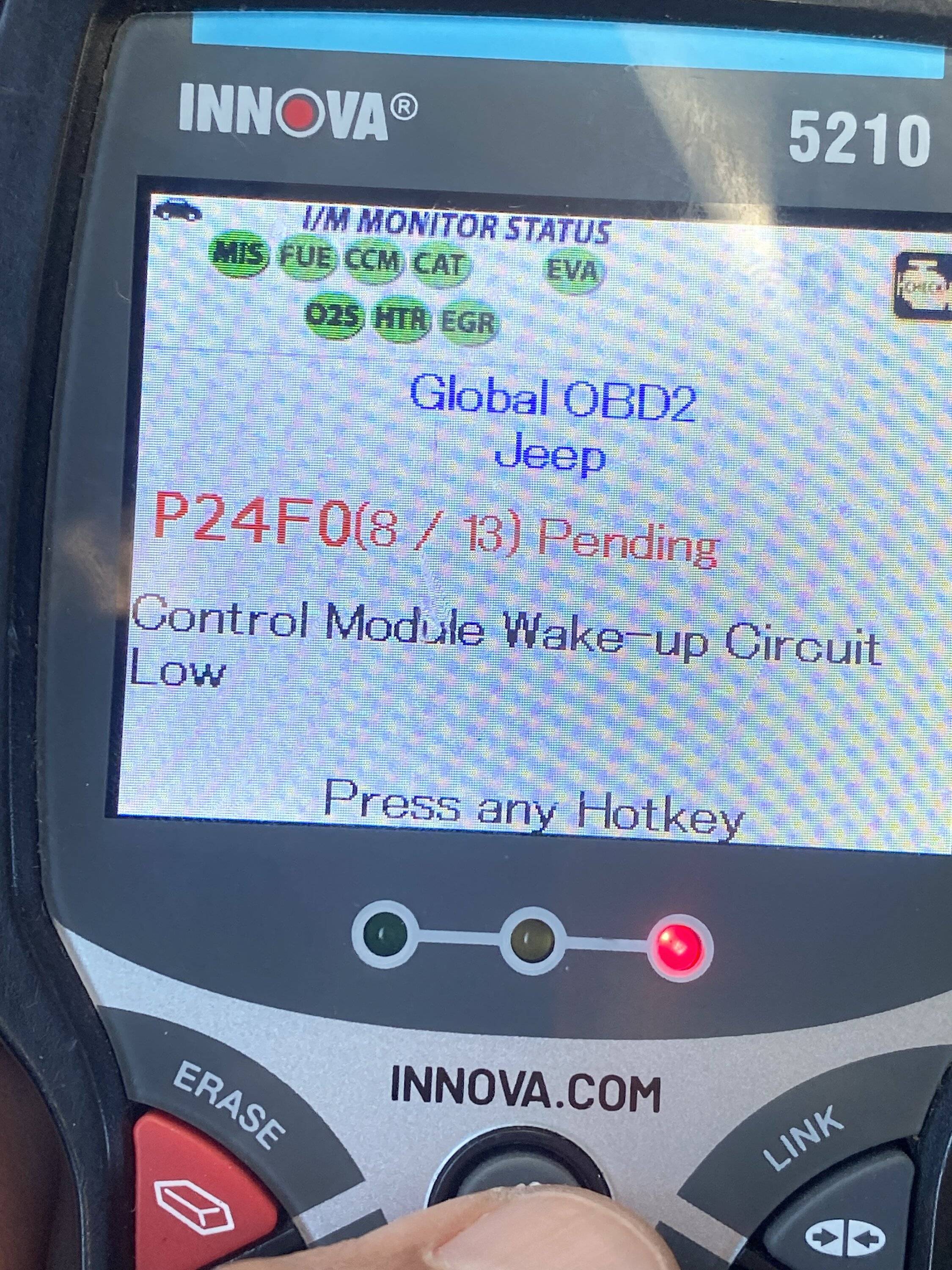

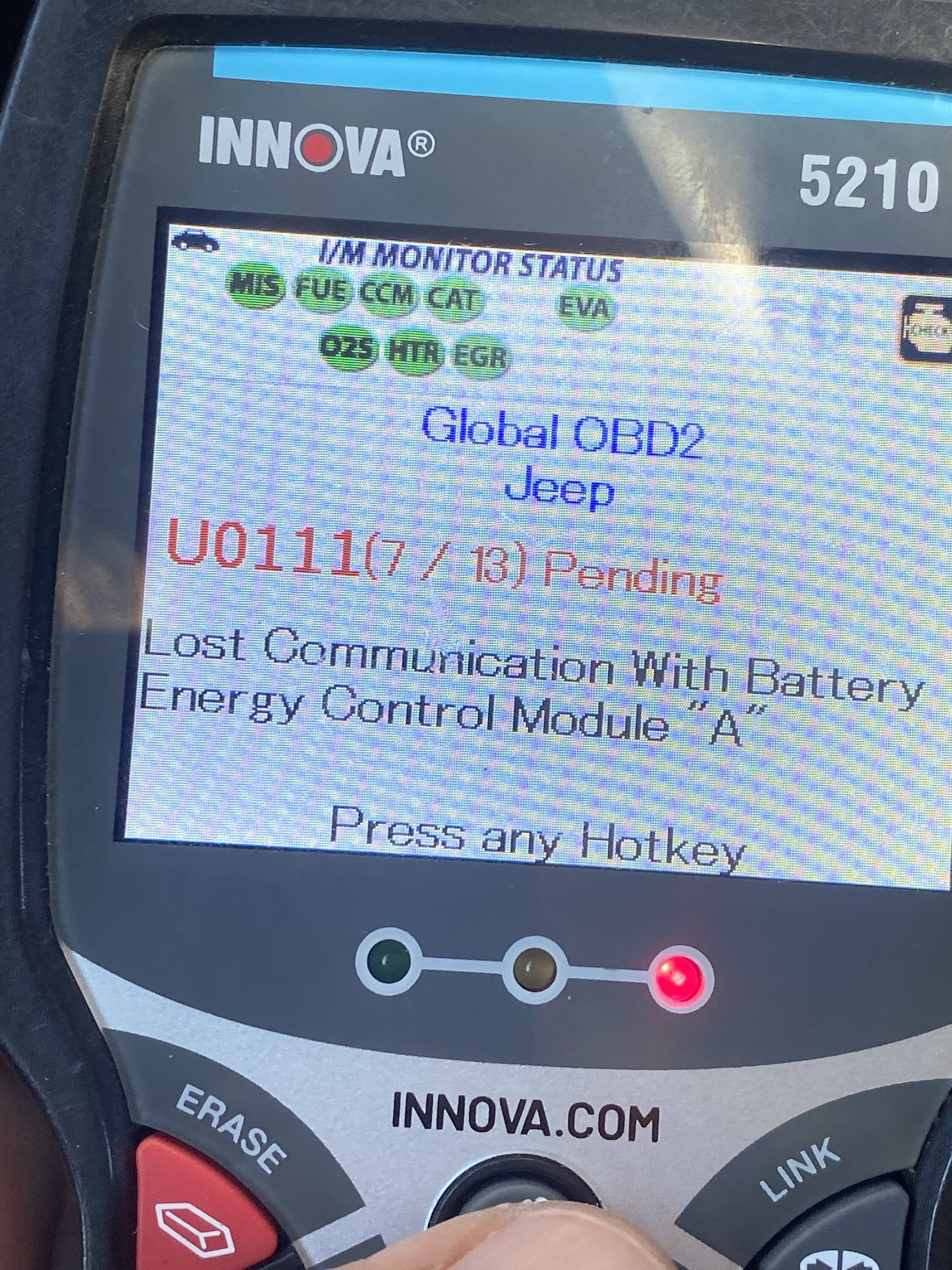

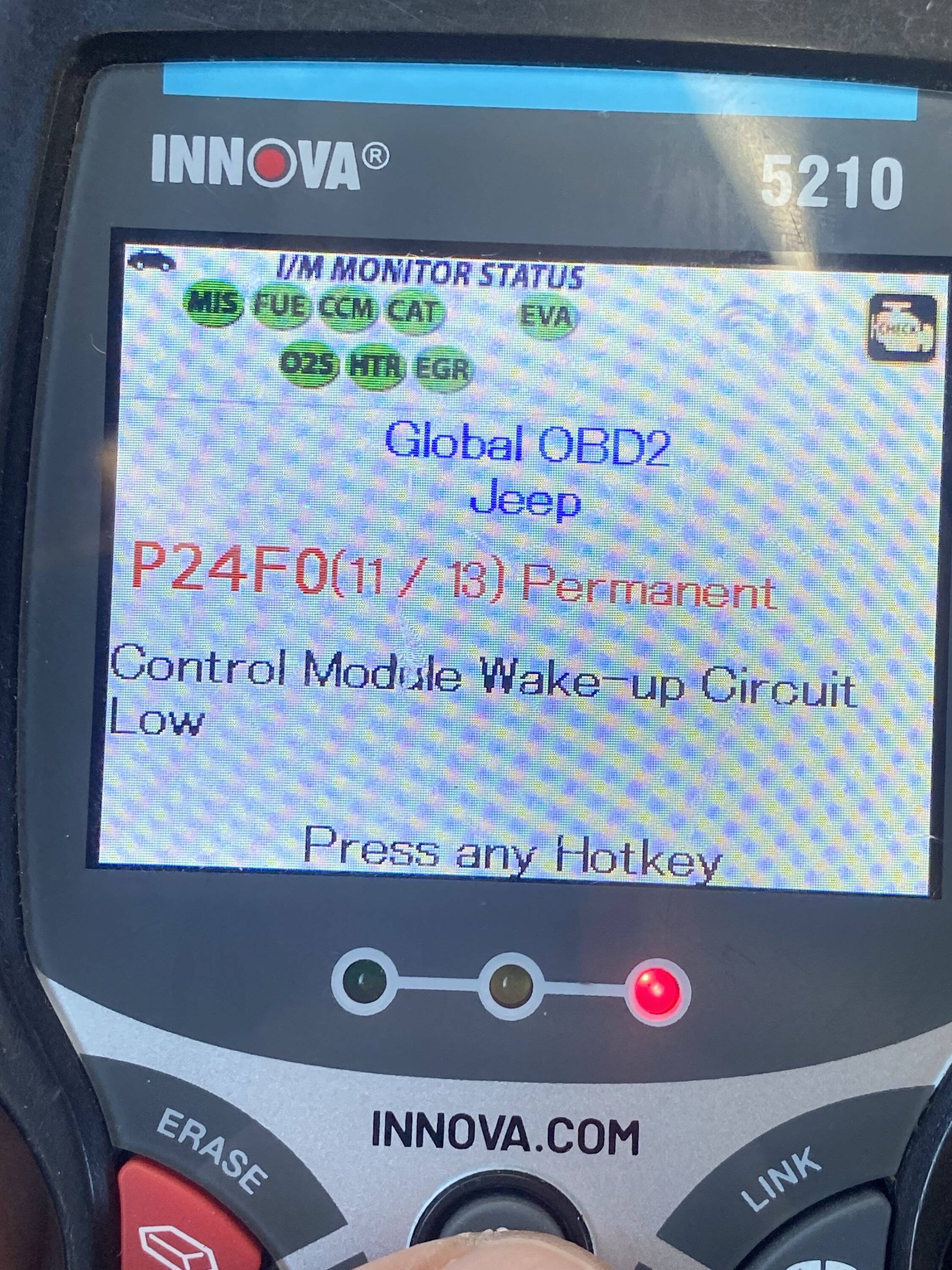

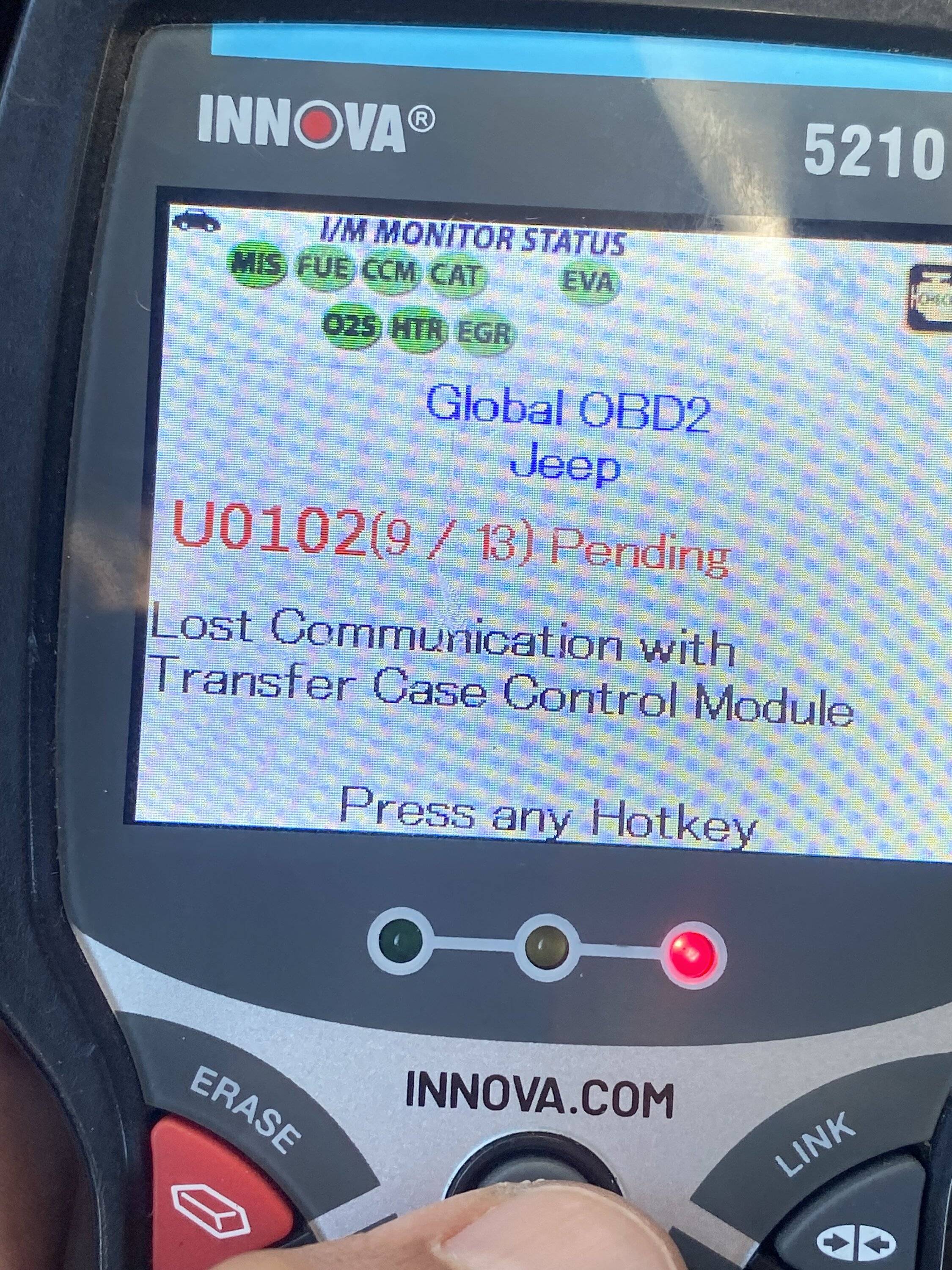

Just received a similar message today I have a 2023 rubicon 4xe 8500 miles completely stock, tried to start it kept telling me to put my foot on the brake and press start. Got out locked vehicle and re attempted to start this time said my fuel door was open!! Opened fuel door got it and repeated the process again jeep started and then I noticed a check engine light. After a short drive and shutting down I have a message to service hybrid vehicle system attached are the faults I captured.
