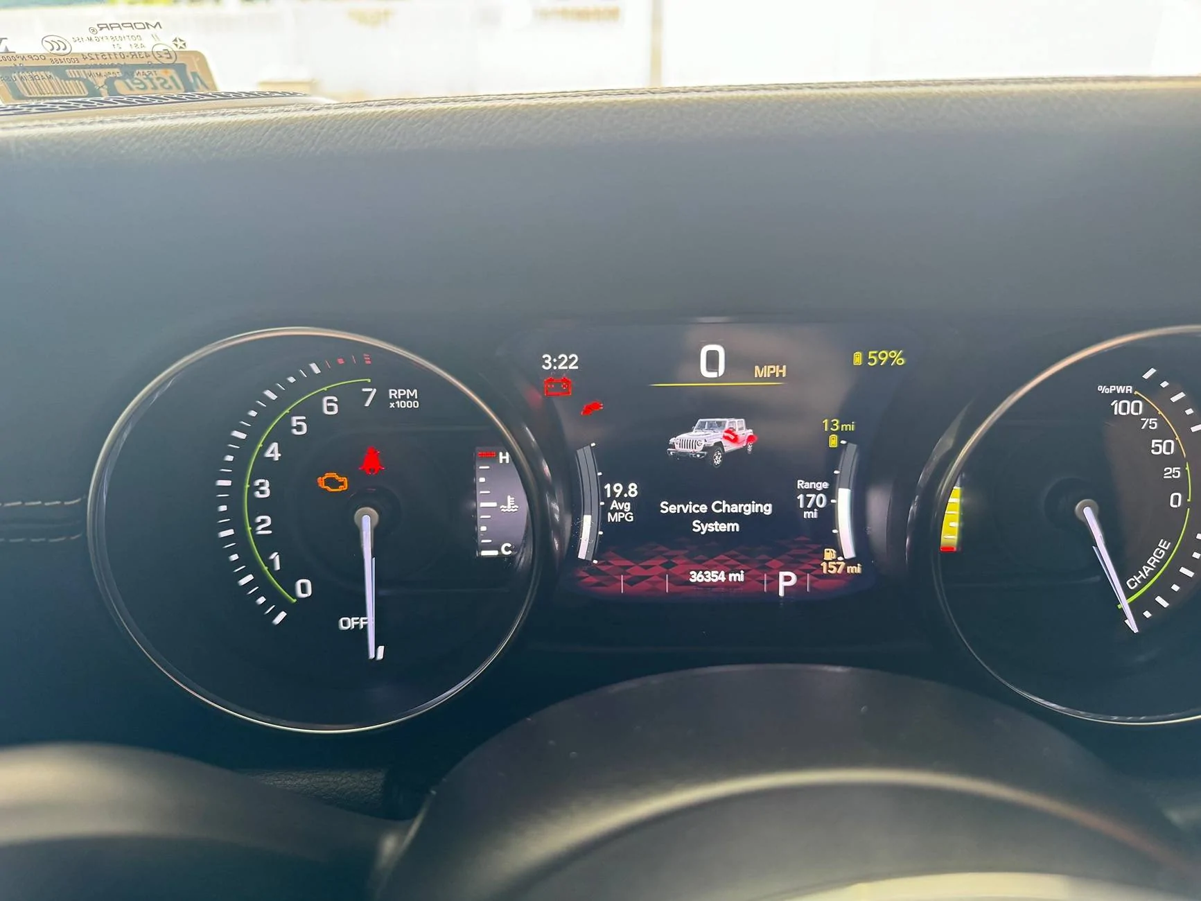

Same thing happened to my 2021 4xe. Dealer has it now in Utah. Dealer said they had to contact jeep engineer. New battery being sent to dealer from manufacturer . So I am waiting now 10 days with car. Hoping for repair soon. I had a recall done and never worked after.
Jeep Wrangler JL 4XE electrical issue - Service Charging System IMG_1892

Meant waiting ten days without a car
