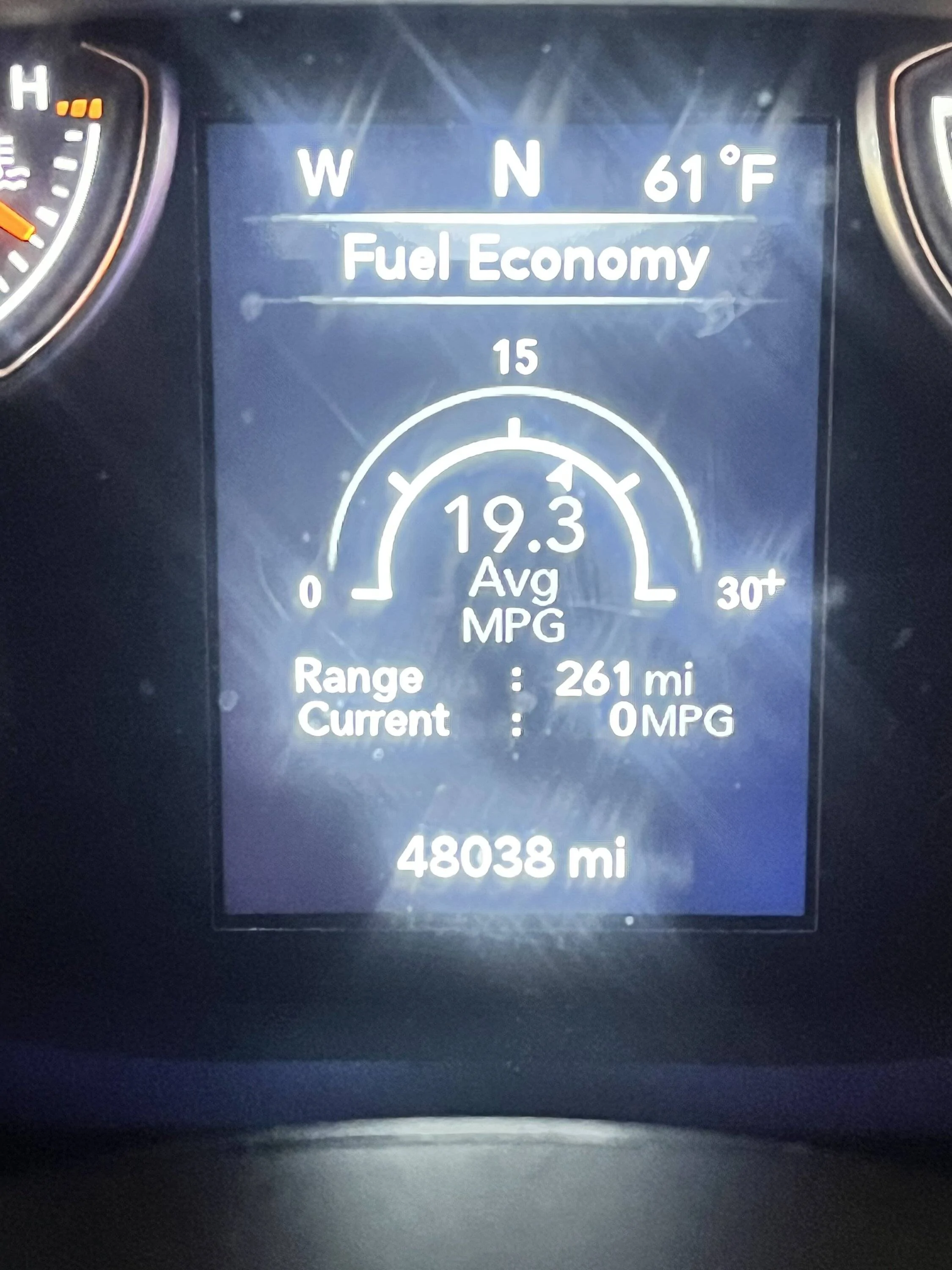

Has anyone found the rpm sweet spot? I have the 3.6 manual, 2 1/2 lift with 33 tires, and stick gears for now. I have been playing around and have found that in 4th gear at 72 mph I am running about 2500 rpm which will get me an average of 19.2 mpg. So far that’s the best since it was stock. Oh yeah I have the afe pro dry air filter. Besides that motor is stock.

i'm still on stock in a willys sport, i run 72mph in 5th gear just at 2k rpm, hardly use 6th, been getting a little over 21mpg

If just cruising on fairly level highway, 2K rpm in 6th seems optimum about 65. Stock Rubi.

Our 2 door manual likes 2K-2100 for fuel economy. I found with the stock 3.45 gears and 33" tires, that it liked 4th gear at 60-67, 5th gear 68-80. I did back to back testing running 6th gear for a tank on the 80 mph freeway commute, and then reset and did 5th gear for the commute (I cruise at about 78 mph on the GPS). Did that a couple tanks per. I found that 5th gear on the freeway returned the best economy by about 1 MPG (21.5 vs 20.5). On back roads where we ran 60-65 in 4th, 65-70 in 5th, we'd return closer to 23. This was otherwise stock with 33" tires.
With the 4.10s in it now, plus the true-trac, we're seeing 19.5-20.5 commuting and 6th gear is the best gear now. It will do about 21 or a little better on the highways, gravel roads and trails, mixed. The true-trac is the probable cause, the front driveshaft is now spinning (preload in the truetrac won't let it freewheel).
Wind is a killer. Headwind drops the fuel mileage a fair bit, 18 MPG or so on the freeway.
