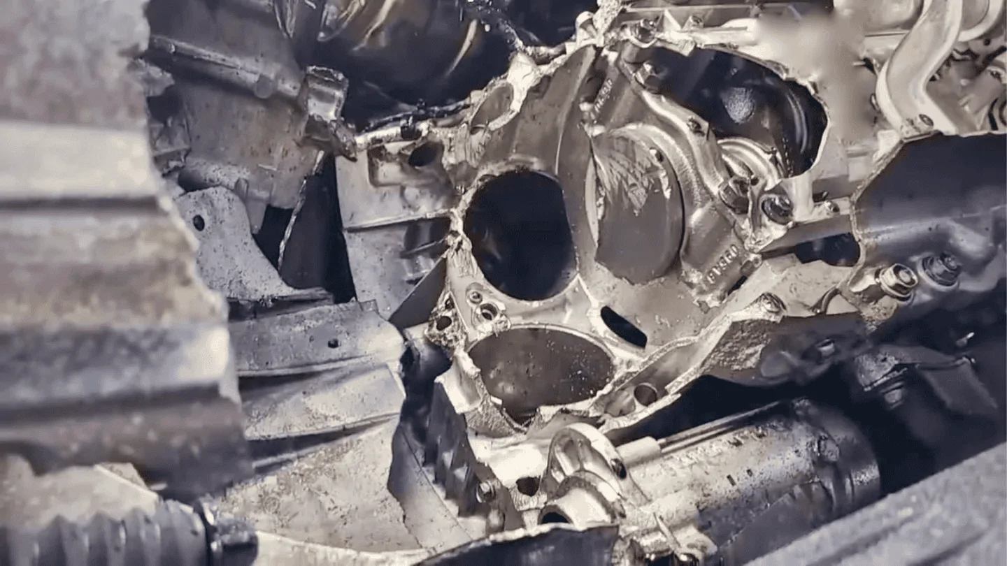

"Tuten did a bit of napkin math and figured that at 55 mph, the engine was spinning somewhere around 50,000 rpm, well above the factory redline of 6,600 rpm." Wow!
I suppose I should add the addendum that while it doesn't matter what's making things turn, they are only designed to turn so fast before going kaboom. That article is an excellent example of a kaboom.
omnitonic
Michael
Apr 20, 2021
201
297
Southwest Virginia
2021 JLU Willys in Sarge Green
truck driver
I thought about that some more. It was in 1st gear, in 4 low. What the hell kind of RV was that guy using to pull that thing? The engine braking effect would have been massive.
