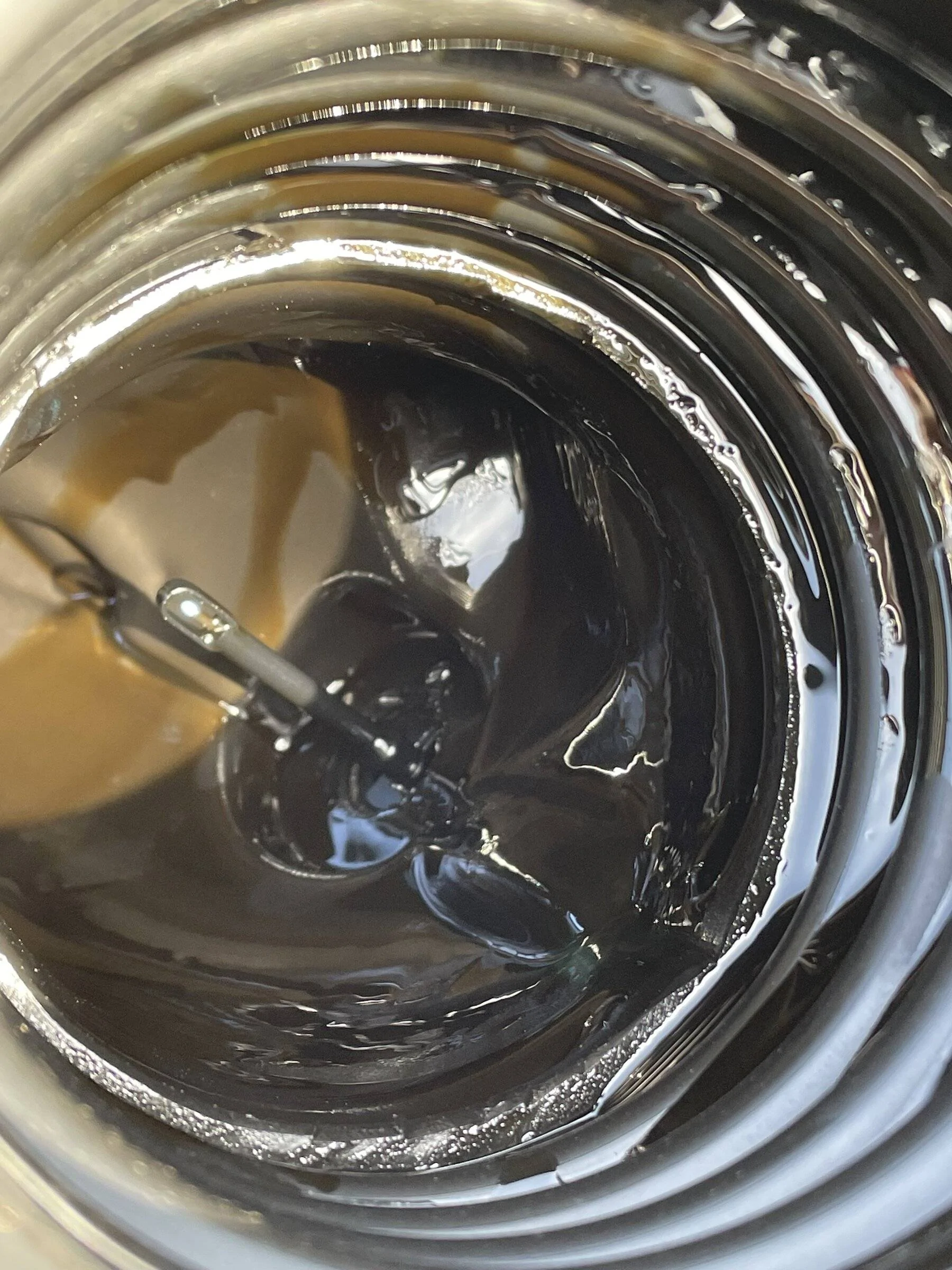

Hi everyone,
I found engine oil in the air filter box. What reason happened for this? Any suggestions?
2021 Wrangler Rubicon 4xe
Jeep Wrangler JL Engine oil in the air filter box. IMG_8687
Jeep Wrangler JL Engine oil in the air filter box. IMG_8689

Perhaps related, or I could be beating a dead drum...
What does your oil dipstick say? (Refer to manual.)
Yeah it looks like oil level dropped a little. Maybe this is related to pcv valve? And what do you mean dead drum?

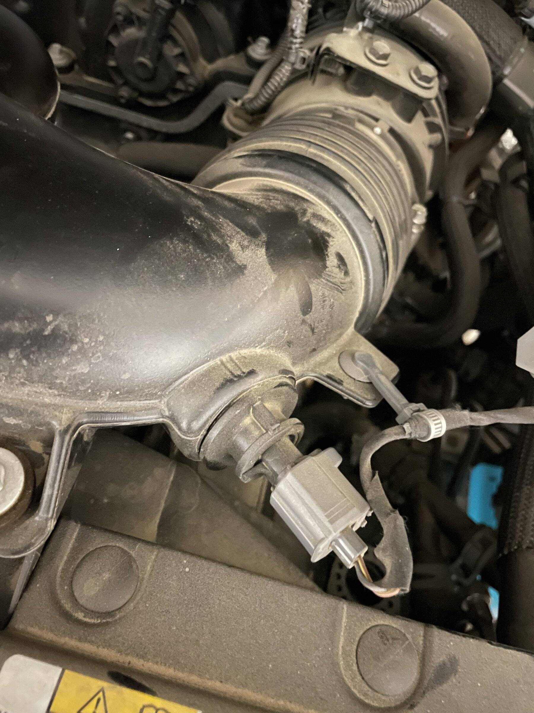

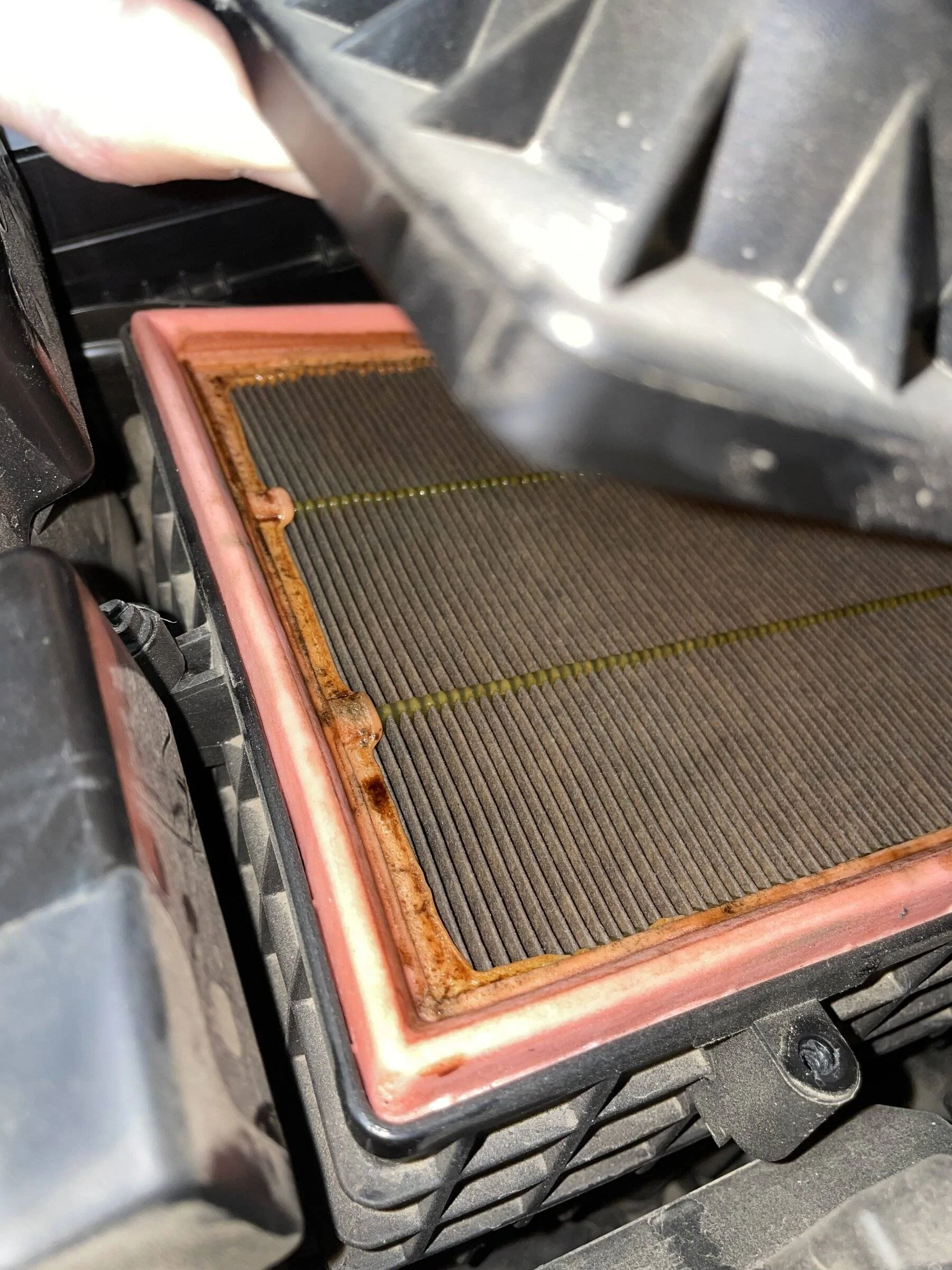

Done with cleaning oiled places! Could you please confirm that on the attached screenshots there are MAF sensor I guess correct? The best idea is to replace MAF sensor or just clean up will be enough?
How do you think after cleaning may I test without air filter just to make sure there no oil leaks and I can save new air filter after testing.

Well, I learned something new today, apparently the 2.0 doesn’t use MAF sensing as is common in other makes. It estimates mass based on intake temp, pressure, and O2 sensor feedback. In your photo is the intake air temperature sensor. I don’t expect IAT sensor to be sensitive to oil fouling in the way that MAF are. It certainly won’t hurt to disconnect the intake tube and inspect/ clean any oil out. But it’s probably not affecting how it runs.
Does it run OK now?
