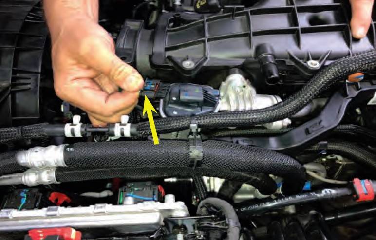

Any ideas on EGR valve? Cannot find a schematic at all that shows where the EGR is located.
It is on the driver's side of the engine. You need to take the engine cover off. Photo shows the EGR valve connector being unplugged.

Thank you! I’m going to check this out first to see if it’s our culprit. Much appreciated!

Removed and cleaned EGR valve, double checked fuses, married and unmarried Tazer…still showing permanent code for 1404. Sad..guess it’ll have to end up seeing the dealership.

It was the EGR valve. I did remove mine and clean it well but it was stuck. Local shop replaced under warranty. Codes cleared and good to go.
