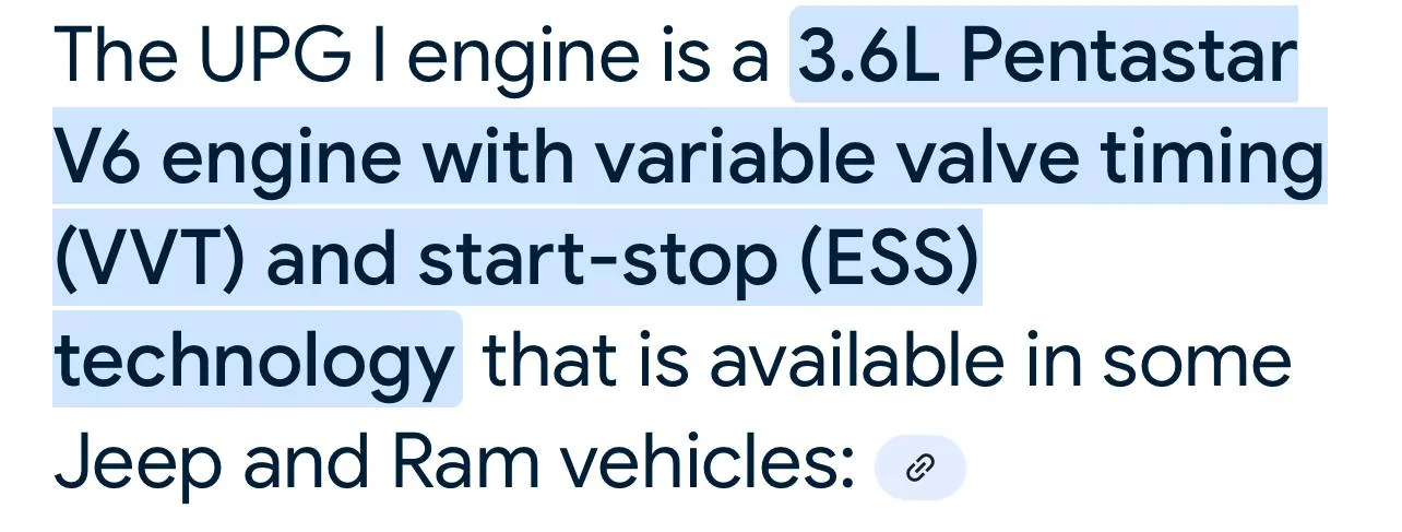

Thanks for the information. Part of my confusion was that I read several times in the forum that the v6 with an automatic was only available with the etorque motor
Yeah man. No clue. I just googled it twice. The first time this came up. The second time in regards to the etorque another code came up. I got flamed over the second google search share because it’s wrong I guess. lol. The internet…….
