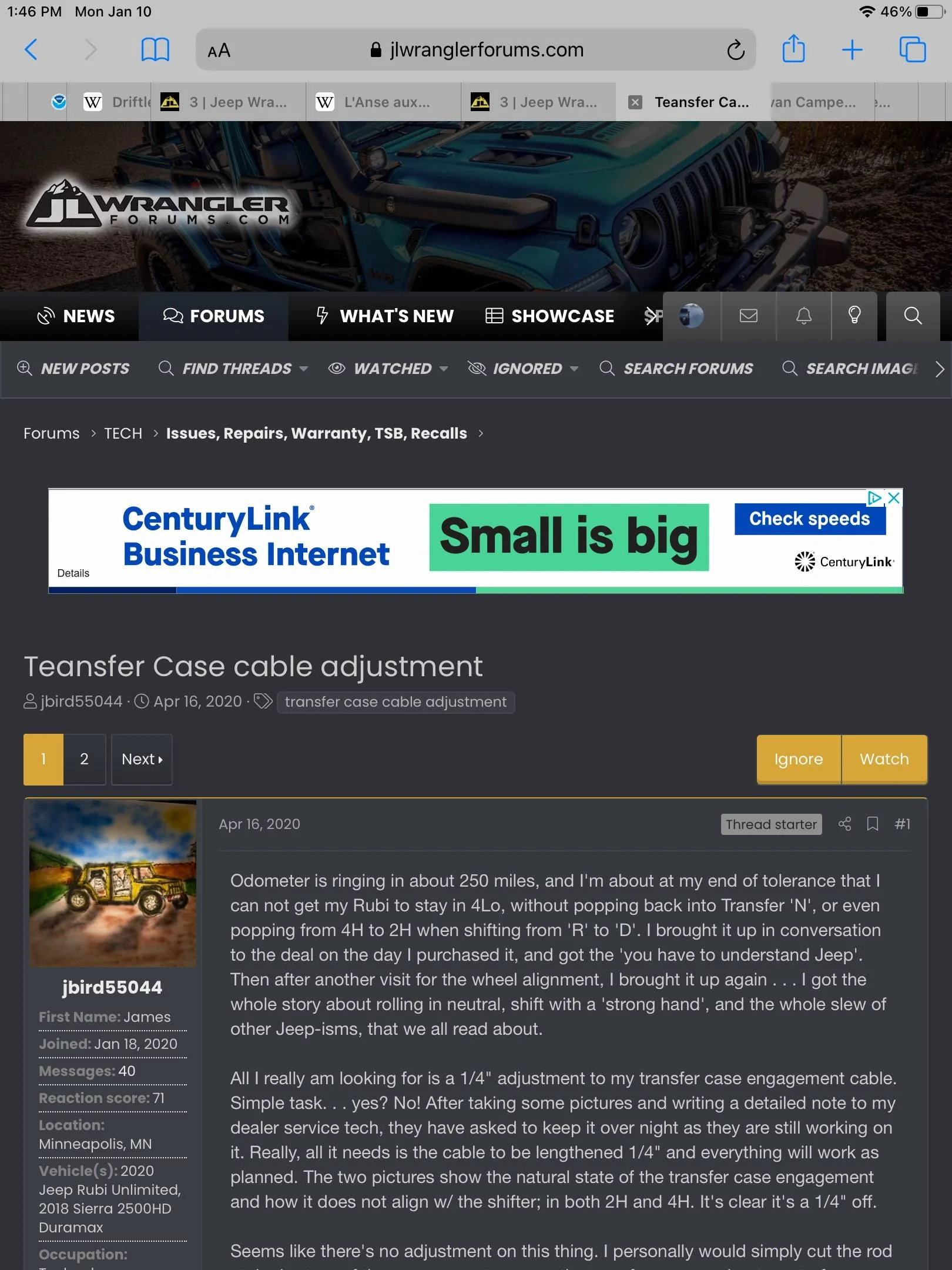

Correction, this is bugging me about not remembering where I saw the video on adjusting the transfer case cable under the console. Further digging got me back to these forums. It wasn’t a video, but a series of pictures and I found it. I know there’s a way to link that thread and post it here. I don’t know how to do that and don’t have time now to figure it out, so I took a screenshot of it and enclosed it here, hope this helps, sorry for the memory thing, age I guess.
Jeep Wrangler JL Engaging 4H CC8A2DD1-C87C-42E2-BD11-0FA26A77A15C
