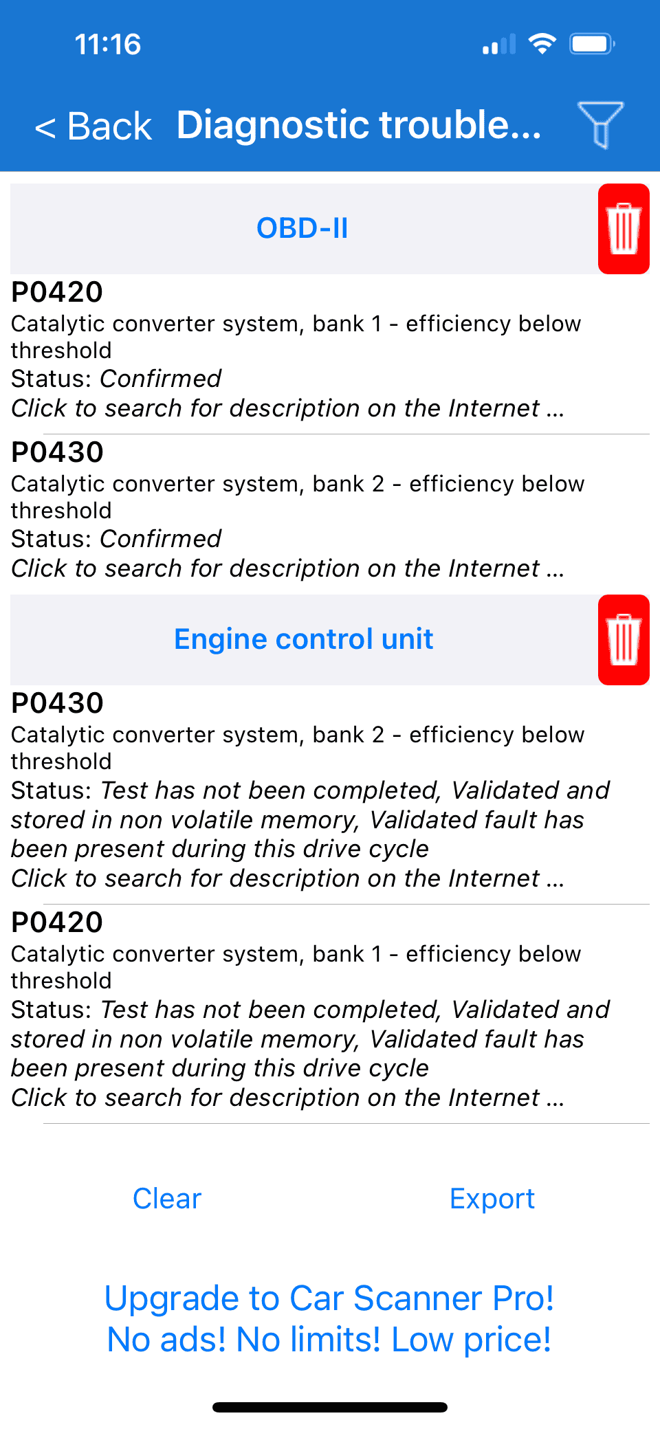

I have been battling these codes since July. Replaced two sensors but codes came back two weeks later. Have two more sensors to replace, but have until August when my registration renewal comes up. On 2008 Unlimited with 178,000 miles.
Your cats have failed. with 178k miles, its no surprise.
I’m afraid that is the problem. I have been told by a mechanic that I would have to buy “California compliant Cat” which are just standard Cats with a CompLiant stamped on it which about doubles the cost. Not sure where the extra money goes, maybe another State tax.
I did try two new gas caps be have not tried twisting the shit out of them. ?
